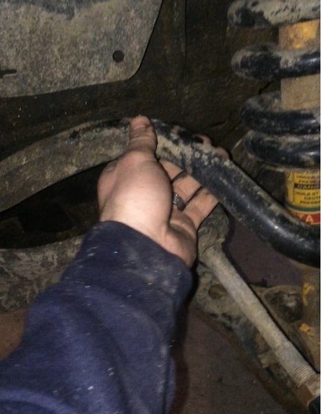

    Lelandt
    Lelandt Well-Known Member
    Oct 7, 2014
    #139847
    475
    Tavish
    Maine
    08 TRD OR
    bully bull bar, halo/angle eye headlights, 20" cree led light bar mounted on bull bar. 42" radius light bar from extreme LEDs 2 led pods, Spare tire mount on bed
    Should this wiggle at all? I'm not a mechanic at all lol. And I can shake it pretty good I was checking all bolts to see if anything was loose

    Just Dandee
    Just Dandee Well-Known Member
    Mar 5, 2015
    #150227
    607
    Dan
    Southwest Idaho
    2015 TRD OR
    Supercharged-2.5 lift-255/85/16
    What about the half shaft angles on the front as the culprit?

    nd4spdbh
    nd4spdbh Well-Known Member
    Oct 7, 2013
    #114055
    14,589
    SoCal
    13 DCSB TRD OR v6 Auto
    umm.... big time. you are increasing the lever arm that the rear axle has on the spring by a factor of 2 to 3x. This will make axle wrap that much worse!
