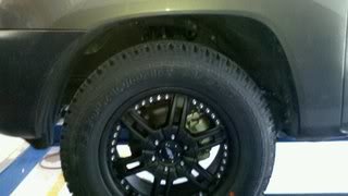

    Hello everyone, my names Derek and I recently got a 2010 tacoma. It didnt take long for me to catch the bug to start fixing her up, and with your help I decided to get some 30" geolander A/Ts on some 17's.
