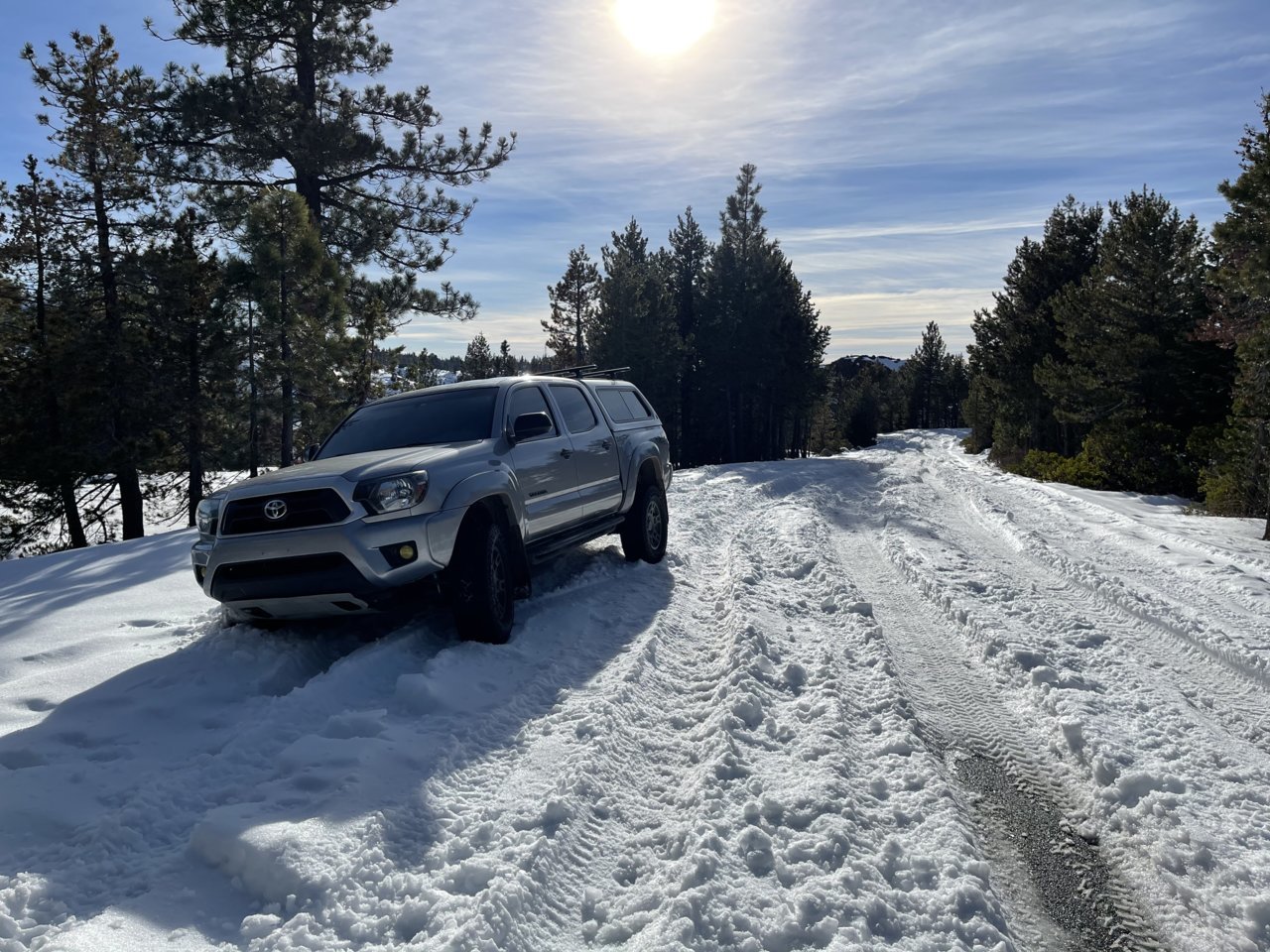

    Hey guys. Appreciate everyone on here for the help that everyone provides. hopefully someone can help me.
    2015 Tacoma TRD off road.
    Bilstein 6112/5160 2.5” lift front.
    Icon add a leaf in rear 1.5” lift.
    63k miles.
    Serviced regularly. new oil in all diffs. New transmission fluid 8k ago.
    driveshaft lubed every 5k
    265-70r17 wild peaks at3 rotated every 5k
    I had the lift for about 15k miles so far and no issues. Went up to snow recently and it was hard snow. So truck was falling in and out of the tire tracks that were already made by previous drivers. Jumping around a little bit. And I do off road this truck regularly.
    anyways, after the snow trip I noticed I get vibrations from 40-50mph mostly once the truck shifts to 5th gear (automatic) the vibes are also dependent on the throttle, more throttle, more vibes in the steering wheel. Also there is a sound...hard to describe but it’s like some 2 door sport cars have when the windows are open and you get the wind drone....but it’s only between 40-50. If I shift up into 4th and the rpm go up, it’s still slightly there but less noticeable.
    Does not go away if I put it in 4wd so don’t think it’s the needle bearing.
    I did get under the truck and checked all the nuts and bolts for all the suspension and it’s all tight.
    tried moving the driveshaft around and seems solid so don’t think it’s the u joints.
    Someone said if you roll and touch the brakes it disconnects the torque converter. Try it and I still have vibes.
    but if I slam on the brakes firmly, the vibes go away.
    does this sound like wheel bearings?
    edit: I also checked the driveshaft if they still had the factory weights on them and they did. They didn’t fall off
