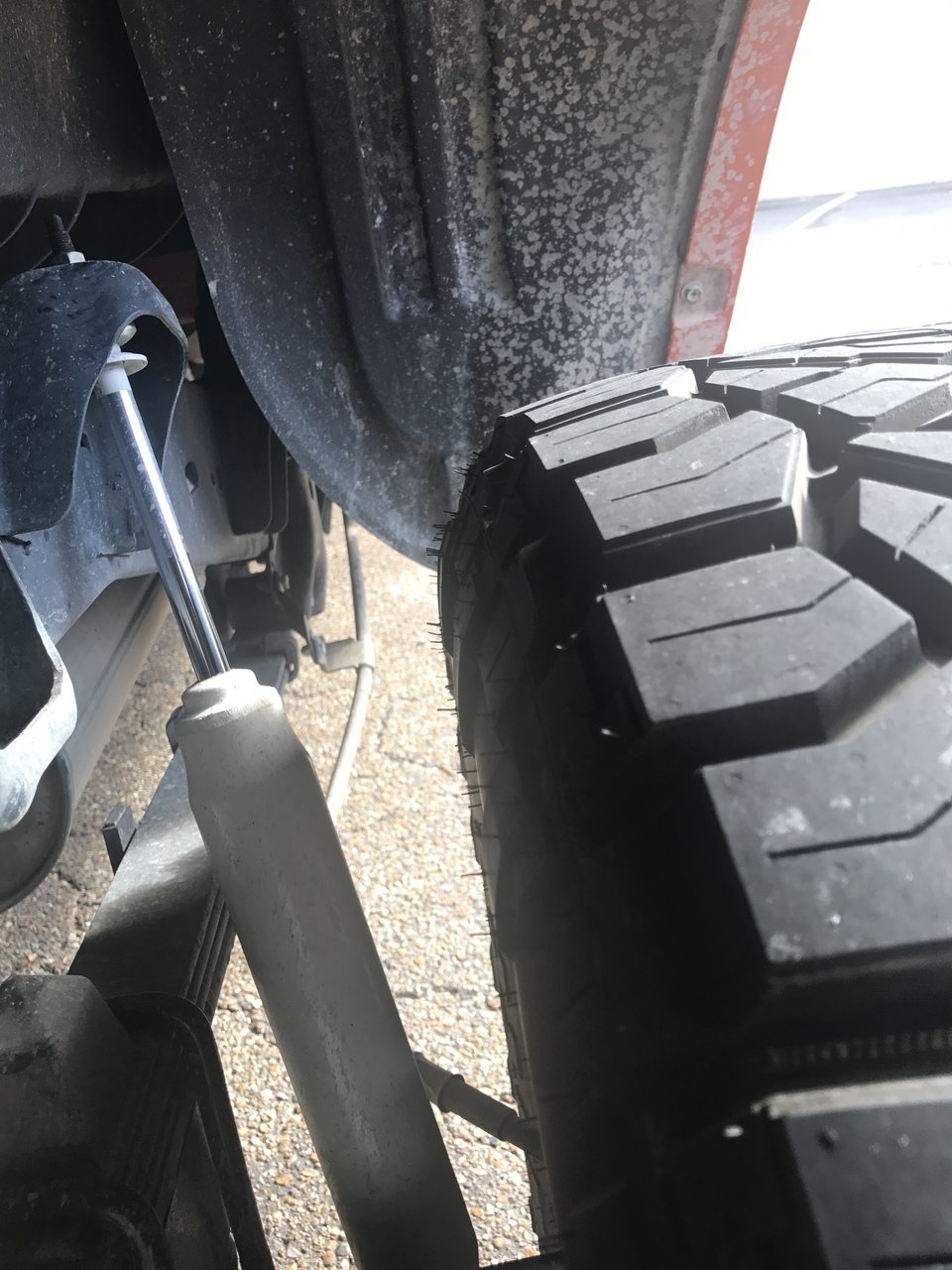

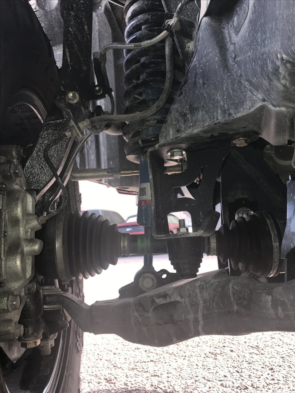

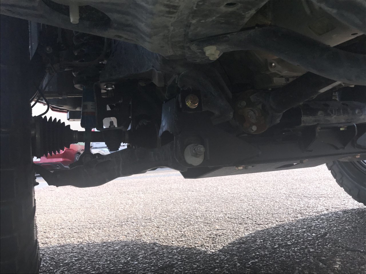

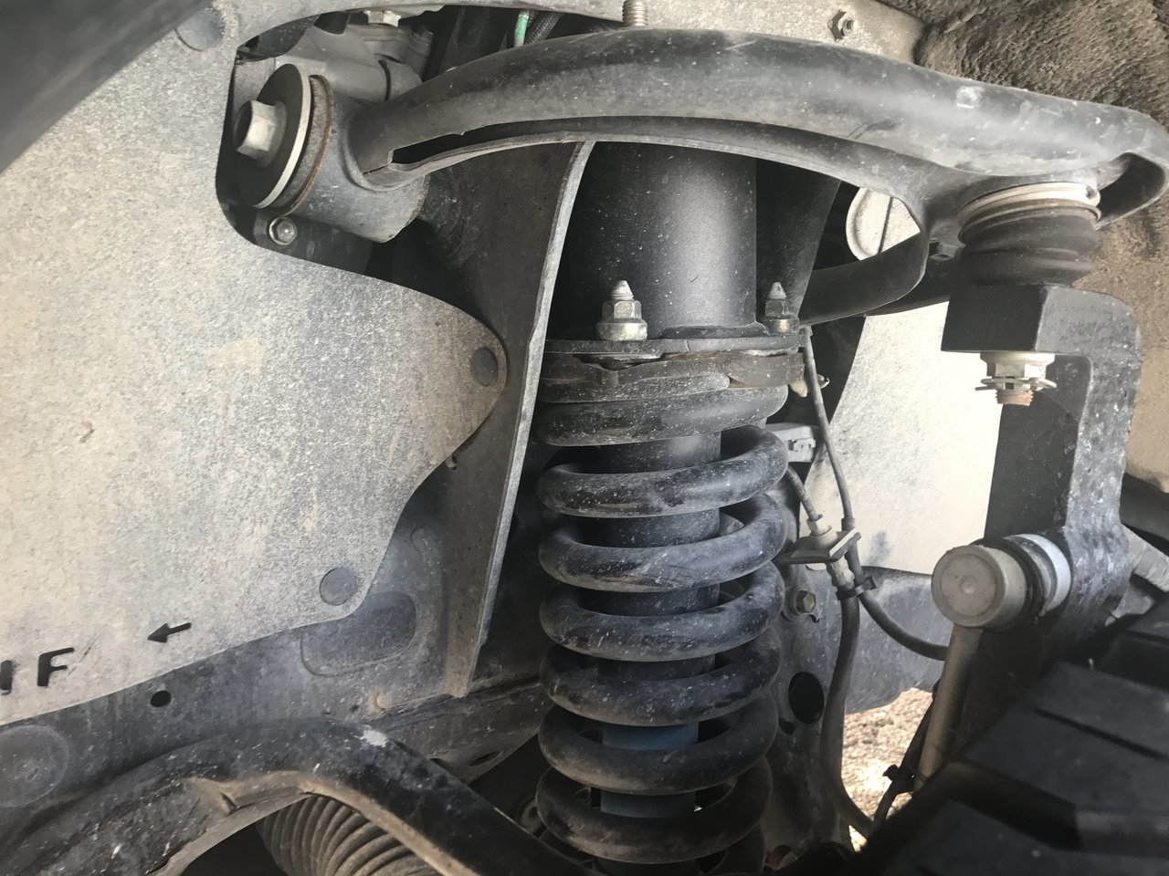

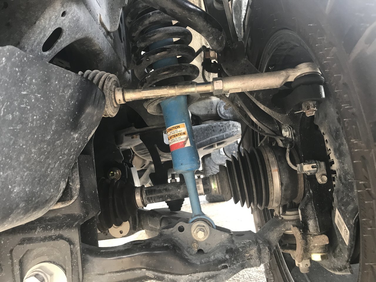

    Someone suggested I take some photos of the parts, maybe someone can see something that sticks out. Let me know if there are any other specific pictures that you would like me to upload in order to help troubleshoot this photo.
