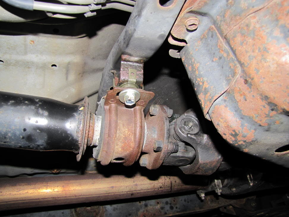

    Adding the lift in back has increased the driveline angle. The vib can be reduced or possibly eliminated by dropping the center bearing on the rear driveshaft.
    There are kilts available for this or you can do what I did. The stock bolts that hold the carrier berring in place are long enough to handle spacing down the bearing a little bit. I used about a 1/2" stack of washers to lower the bearing.
    You can find more information about this in the thread:
    http://www.tacomaworld.com/forum/1s...center-support-bearing-correct-vibration.html
    Here is a pic of the bearing and bracket.
