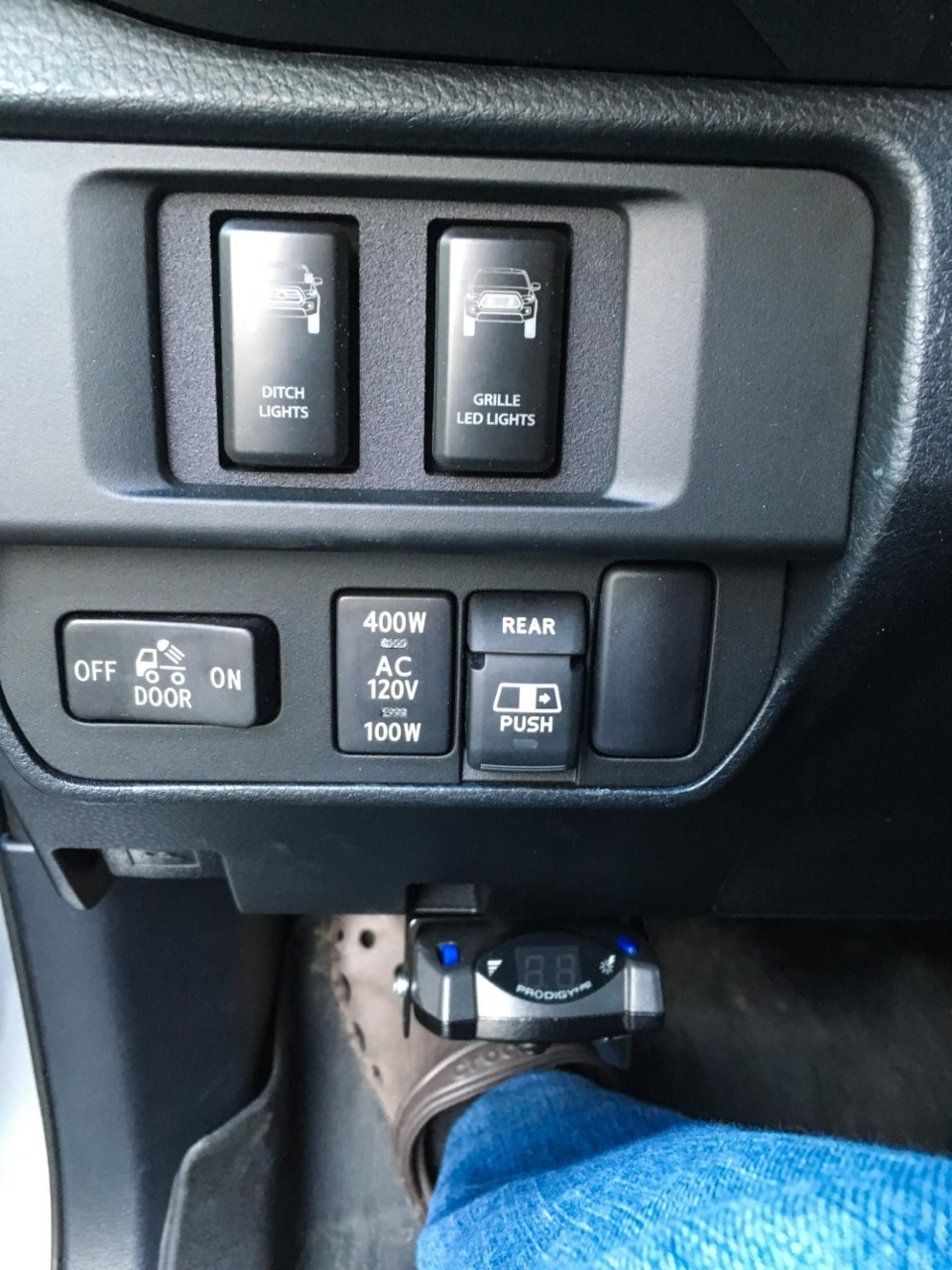

    One of the things I was blown away with was adding Baja Design lights to the other truck, The Squadron Sports were the second thing (after the Prinsu) taken off and saved in a pile for the new truck..
    I waited and planned and ended up being able to make another jump before I mounted them again.. I sold the previous CBI ditchlight brackets - and order new 3rd Gen ones.
    Then I talked to Bailey, and worked out my new plan;
    Squadrons Pro for the ditch lights, and used the Spot lens.
    Squadron Sports into the fog position with the 3rd Gen brackets with Yellow Combo lens for the fogs.
    Shapeways switch panel and CH4x4 switches.
    *note that the top green and red needed to be switched around in this pic;
    I used the source from an add-a-fuse on the highbeam in the main fuse box, then added a relay on my own bracket to control the lights. I had to do this because the CH4x4 switches top out at 3A and are designed for relays.
    I'm headed out tonight to try these out and get them aimed.. just waiting for dark.

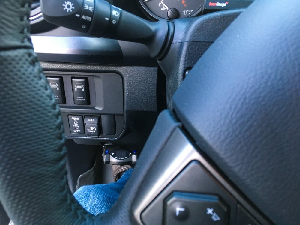

  10. Jul 9, 2018 at 3:40 PM
    Sailor22

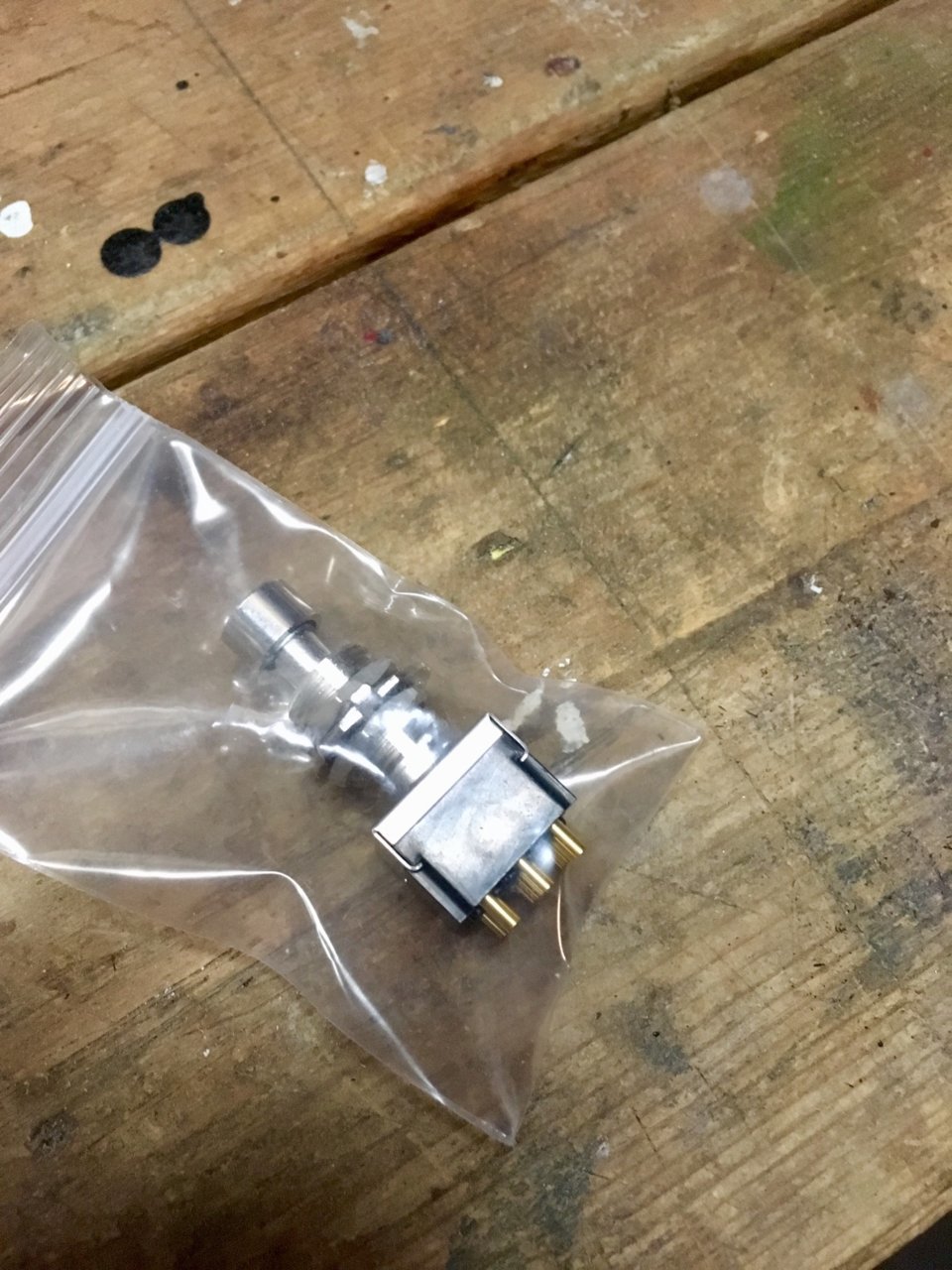

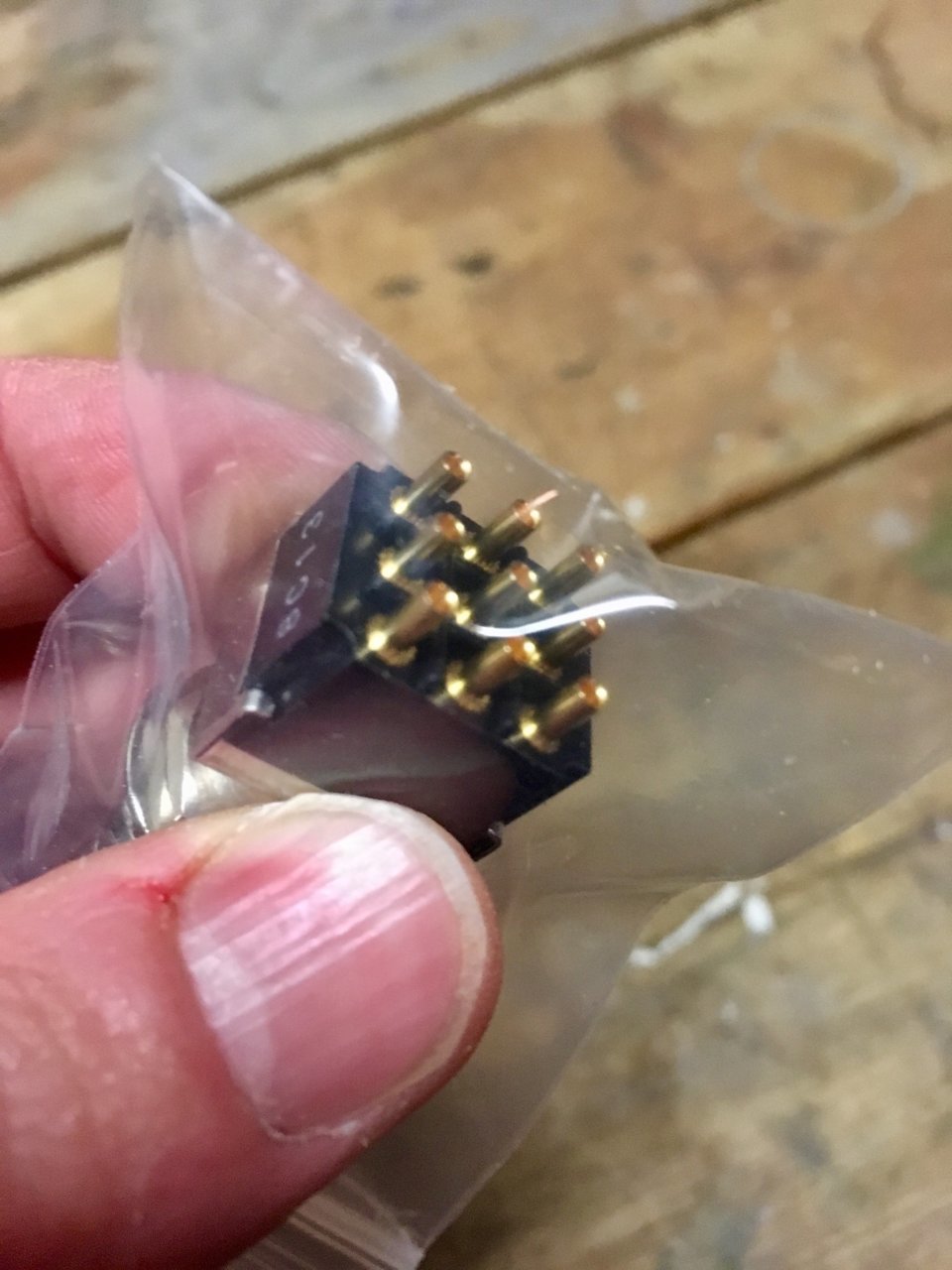

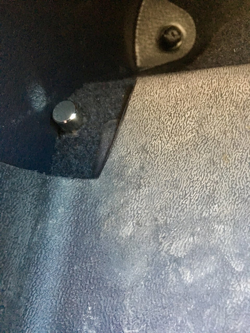

    One of the things bothering me about the driving lights wired through the high beams was if I saw any oncoming headlights on the backroads I would go to low beam and lose all ditch and side vision.
    Fumbling around turning off switches on the dash is tricky even in the dark and while driving. I ended up with a solution that was figured out a long time ago.
    I ordered a guitar pedal foot switch from lovemyswitches and ran on the switch circuit for the Squadron Pros.
    Took out the footrest and mounted the switch right at the edge and out of my way;
    Install required trimming a small section off the weathertech but I was happy with how it went.
    Now I can keep the reg high beams and Sport on and dip the Pros separately while driving.
