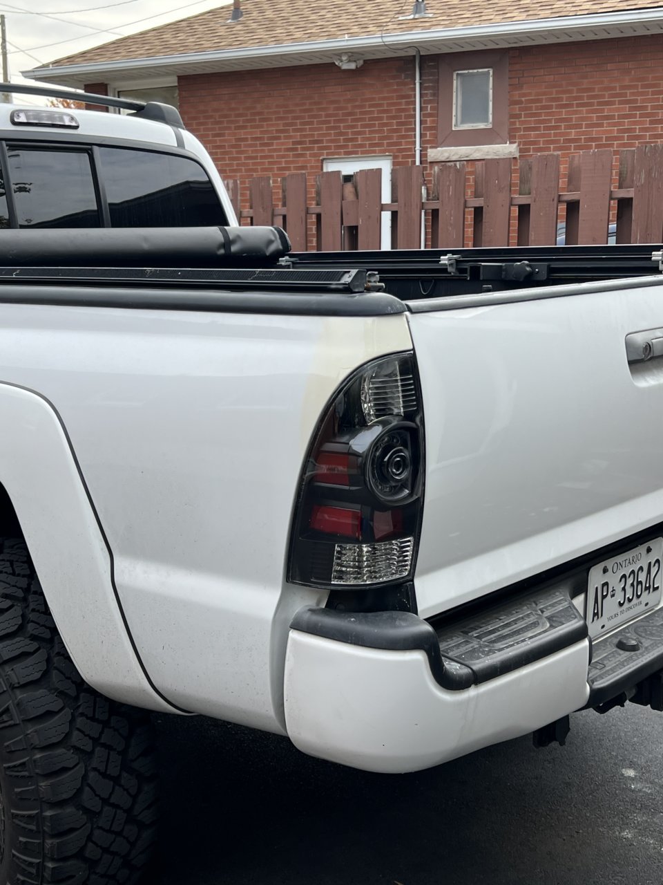

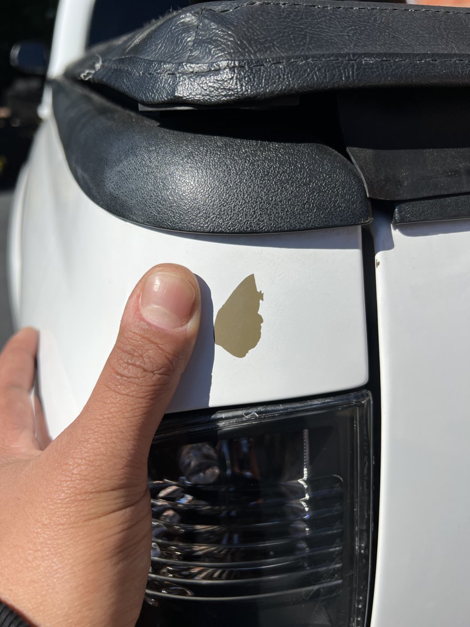

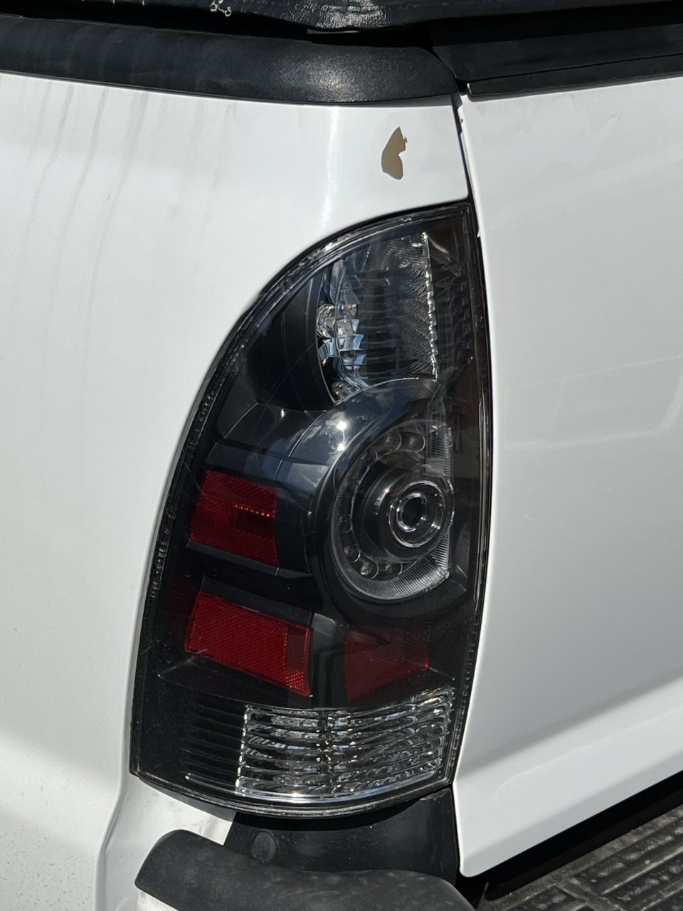

    Just happen to notice the paint flaking on my truck, super disappointed in Toyota but anyways! I’m not looking to paint to the whole bedside, going to paint that spot only.
    Thinking of sanding with 400 grit sandpaper, primer, base coat and a clear coat. Going to try to blend it in as best, luckily there’s no pearl or metallic flakes in the paint. I know it’s not the best way to repair, it will get me by for now. Financially do not want to spend the money to paint the bedside, praying that the other panels don’t start. Really don’t want to sell the truck, especially the amount of money I spent in the last year on it.

    Is that original paint underneath? I'm surprise to see gold/tan underneath white.

    original :(

    can confirm, that is the base coat/primer. I also have super lame, super white

    Toyota white is single stage right?

    It’s white and clear mixed together. So not like a traditional single stage.

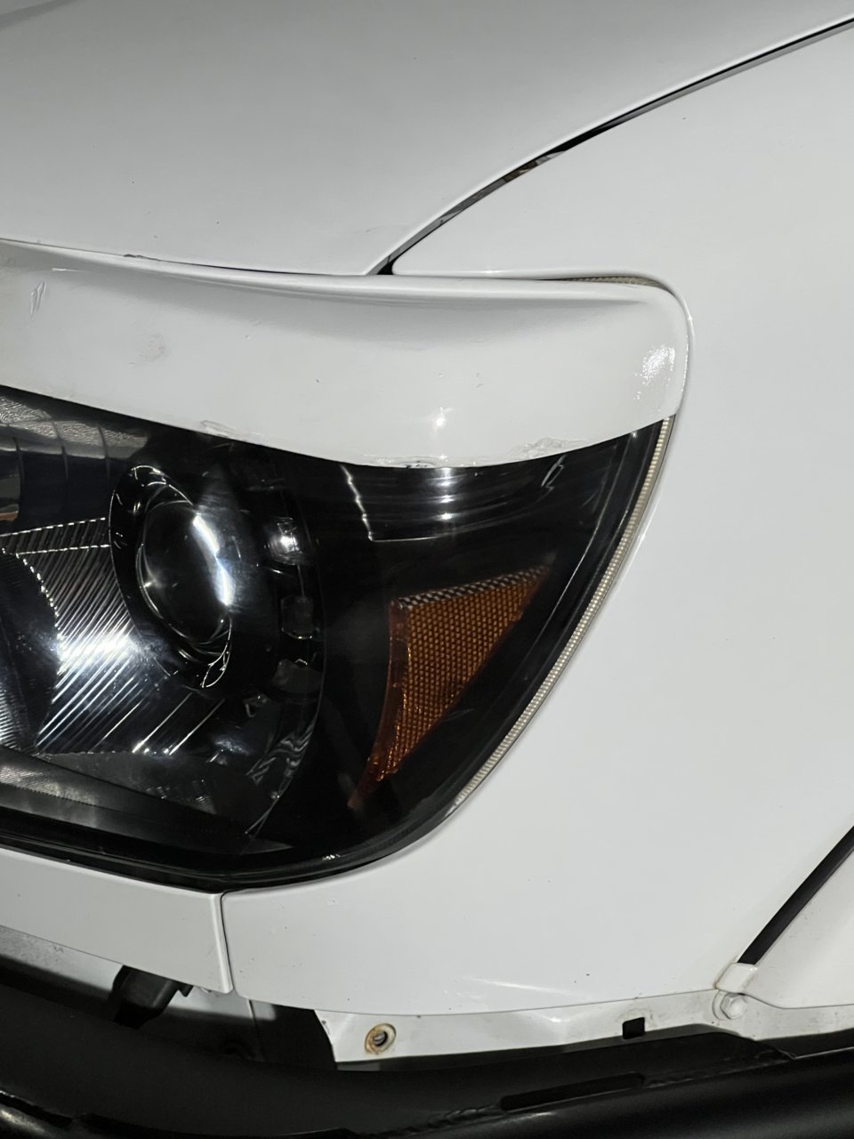

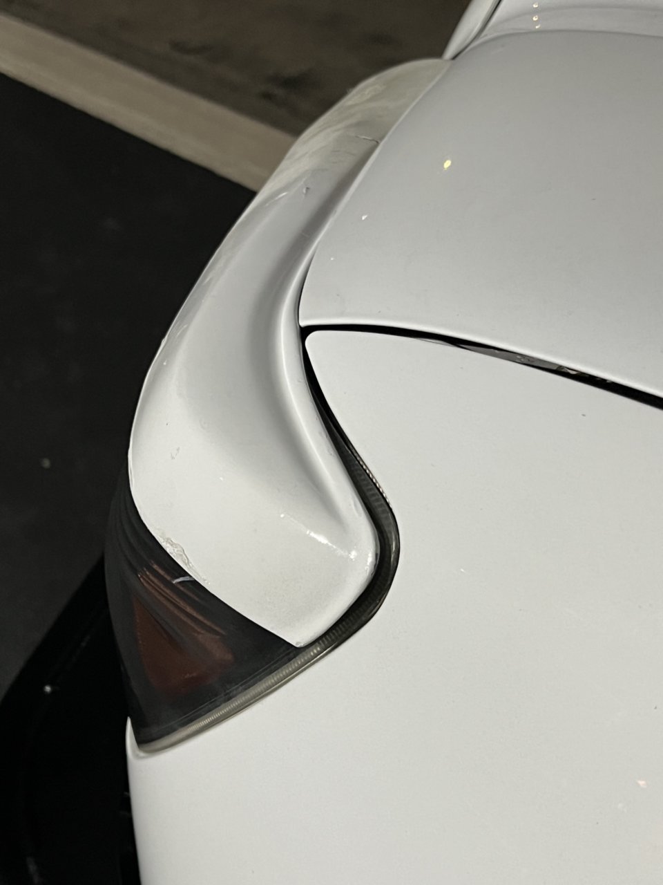

    So shop mixed me up new can with no bronze tint in it, the clear coat they sold me turned the base coat to a yellowish tint as well.
    New base coat with Rustoleum high gloss clear coat. Test piece btw lol!
