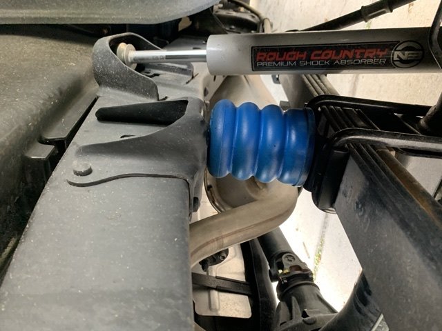

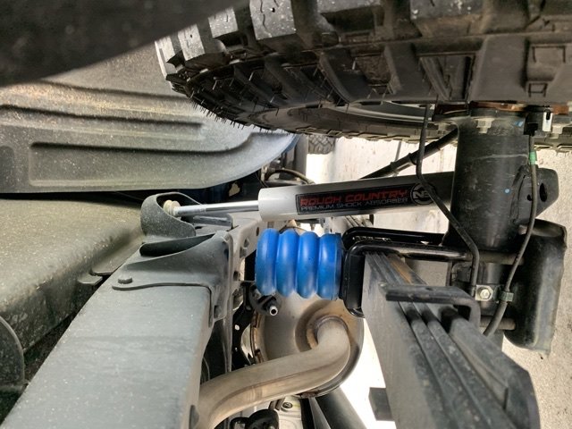

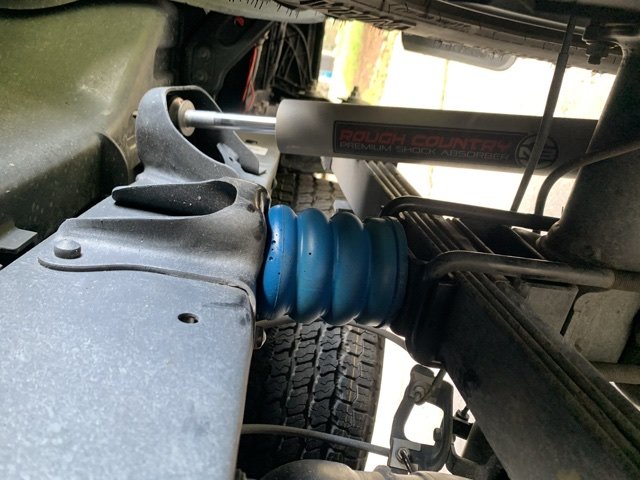

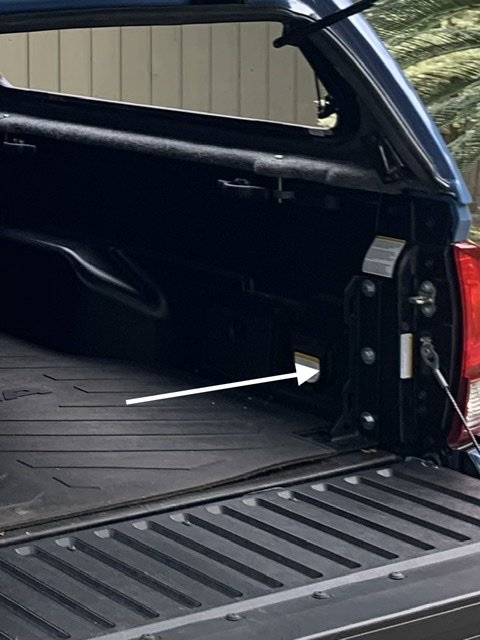

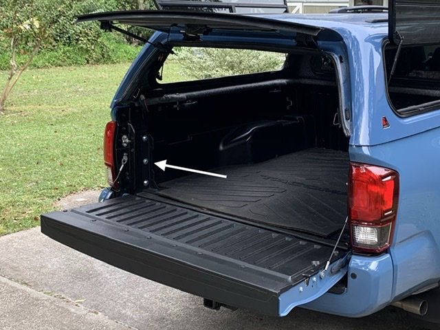

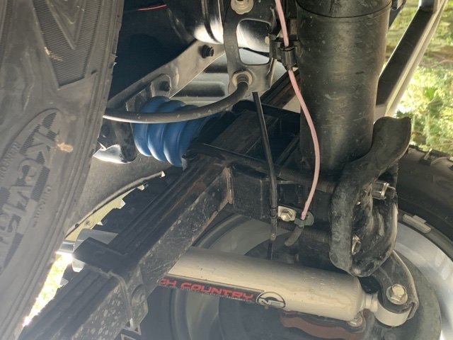

    I just recently purchased a Leer 100xr and in preparation for that install I pre-ordered some Victory 4x4 bed stiffeners and the #500 lb blue summo springs ... the install on both were pretty easy the summo springs being the harder of the two ... there are many YouTube vids helping with both... but if you have any questions fire away

    No towing yet but the ride is definitely different ... seems more in control and a less lean in the curves & turns ... also helped with the sag, I lost almost 1” after leer but gained it back after summo ... i def recommend the mod for under $200 as long as your comfortable doing it yourself :thumbsup:
