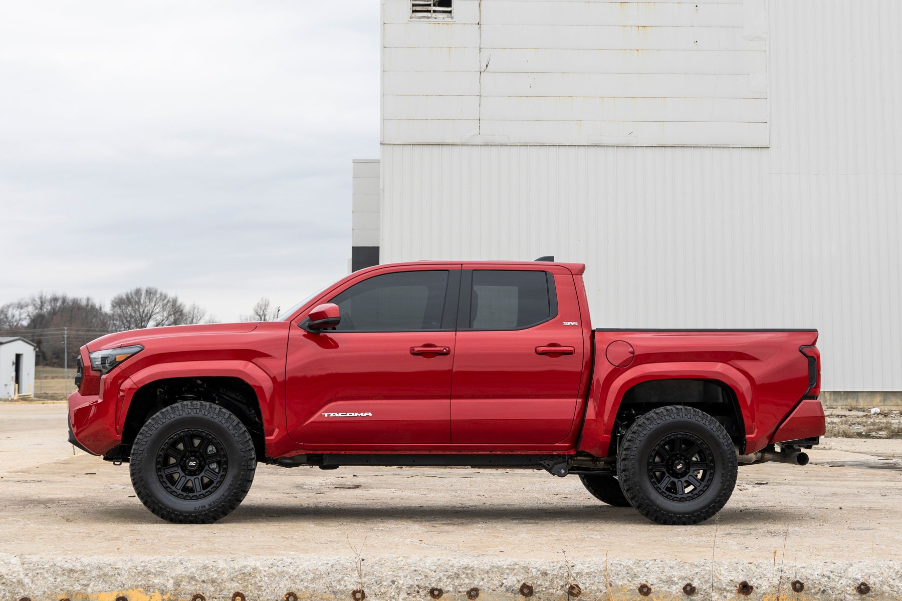

    You are still learning aren't you..
    "Similar" was in repect to the lift that resulted vs preload installed (or puck as done on your truck)
    Did you install the puck lift? Do you know if the puck is 1.5" thick or .75" thick?
    Do you know the actual change in lift with x% increase in preload?
    Have you measured the center of the hub to fender lip before and after the puck intall to know exactly the amount of lift attained? pictures don't mean much.
    3rd gen had approximately 2 to 1 ratio, lift vs preload. (1" puck produces 2" lift) Everything I've read indicates very similar results with the 4th gen.
    Here are the CV angles on a Gen 4 with the proposed TRD lift kit that will be marketed for the 4th gen offering ~ 2.5" of front lift.
    and with 2.5" of front lift obtained with the new TRD offroad lift that will be available

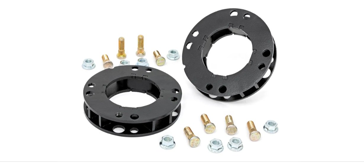

    In reality your lift is a .75" spacer offering 1.5" of lift,, similar to what the 3rd gen with a .75" spacer acheives as I thought you were capable of understanding earlier in the thread. Class over for the day.
    https://www.roughcountry.com/produc...rG5h44tmuK5TH_pCp7PbU2UR7saDHtYYaAnq0EALw_wcB

    WRONG! It is a 1.5" lift. Understand the difference yet?

    You should make another "pictures don't mean much" comment, and then post pictures of shit I don't even own rofl
