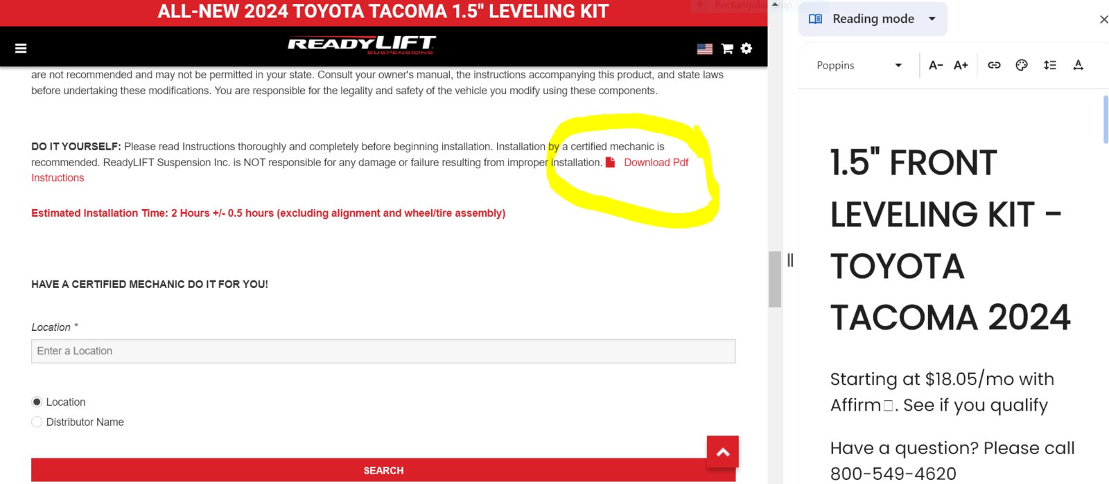

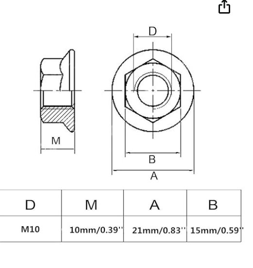

    C'mon @Fast1 tell us the size of the spacer smart guy. I'll even let you look at this:

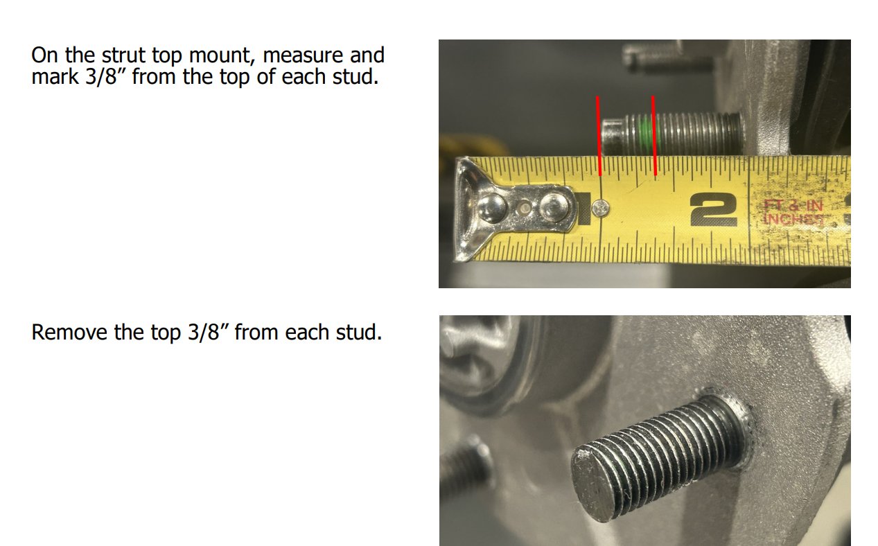

    read the directions... focus on page 8 where you cut the oem 1" stud down by 3/8" so that it will not interfere with the spacer height. That means you have 5/8" inch gap to fit within the spacer height of , lets call it 3/4".

    ^I didn't see the instructions at the time. And you're reading too much into the Readylift photos, since they show a mix of TRD OR and SR5 shocks and some prototype pieces. Don't assume 5/8" or 3/4" remaining stud length means the spacer is 5/8" or 3/4" thick, because there are also photos with uncut studs in the PDF :notsure:

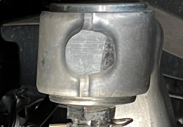

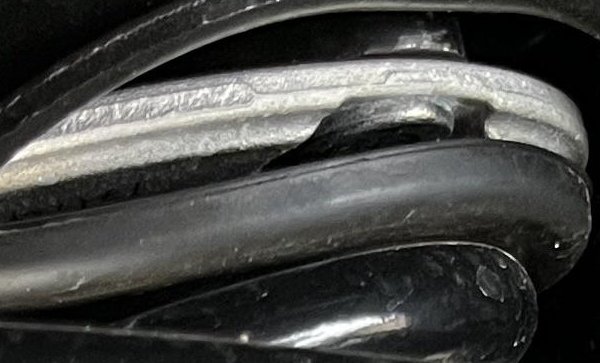

    @Visa_Declined thanks for posting these pics. Contrast the top hat casting appearance to the knuckle:

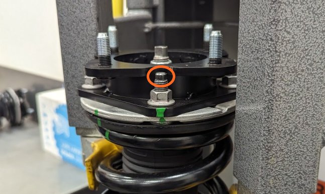

    see those metric nuts. they are 10mm in height for reference. it is abvious in that photo that the spacer height is not 1.5". Most likely 1" spacer
