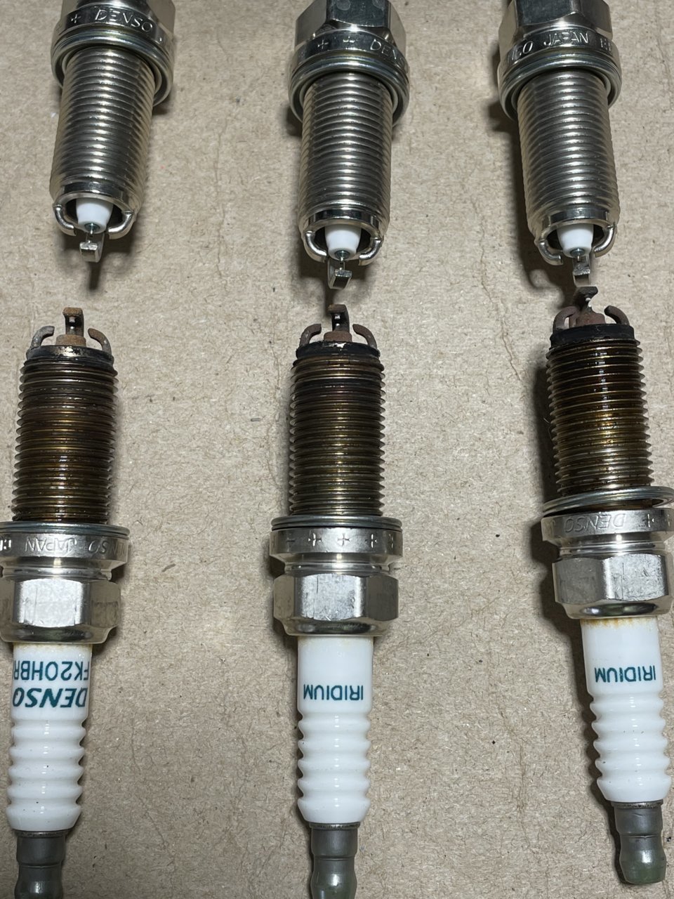

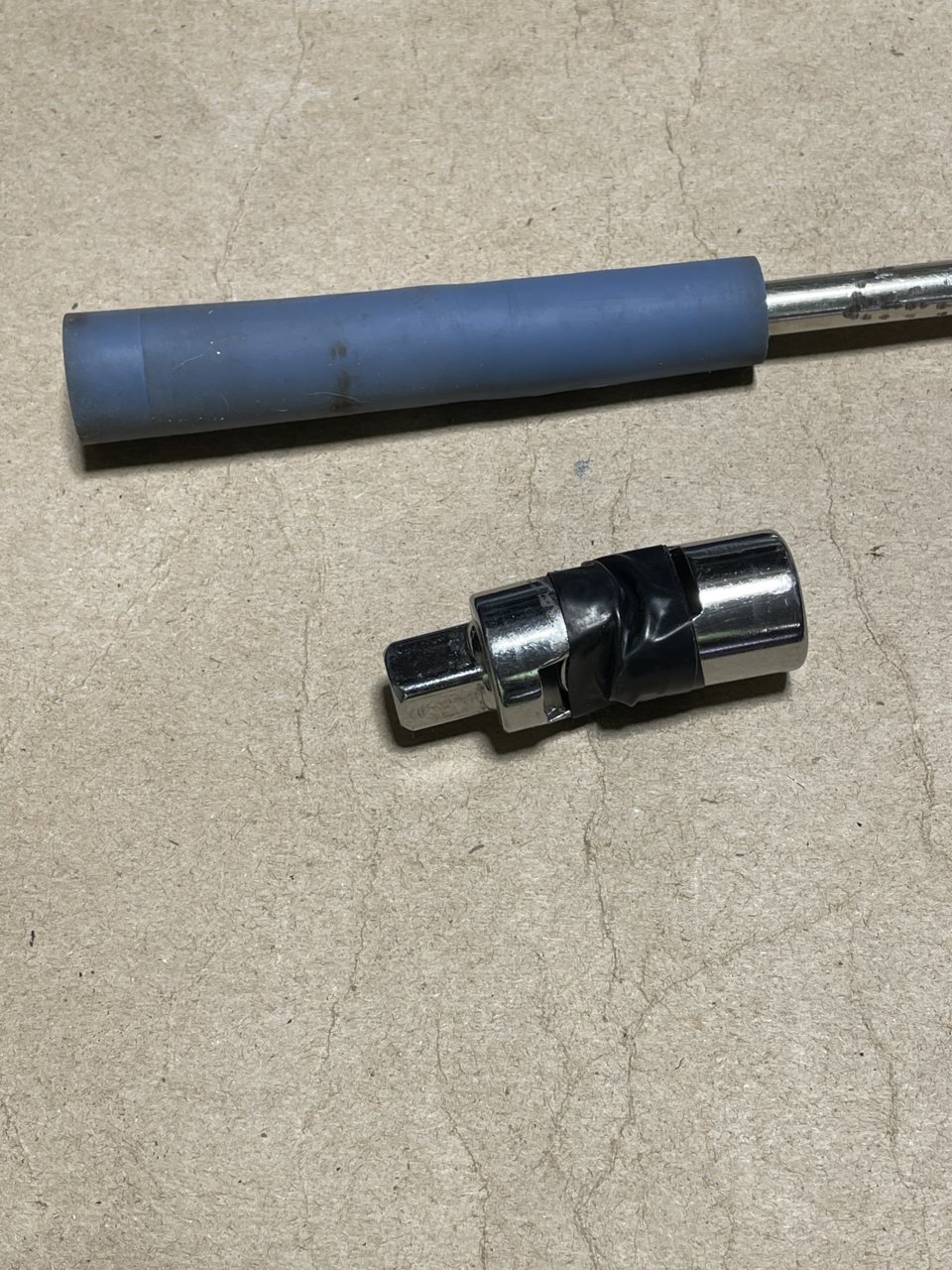

    9B97D840-13F3-4494-9BA6-DA98047A3702.jpg Did mine today, here’s a comparison the odometer was at 60,009 miles. A few tricks I use are- an old plug boot and a 1/4” extension to pull plugs out after they’re loose and to start them to avoid cross threading-if you have a socket swivel and it flops around too much then wrap some electrical tape around the knuckle(s)
