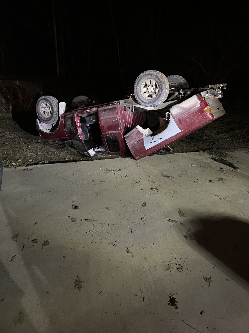

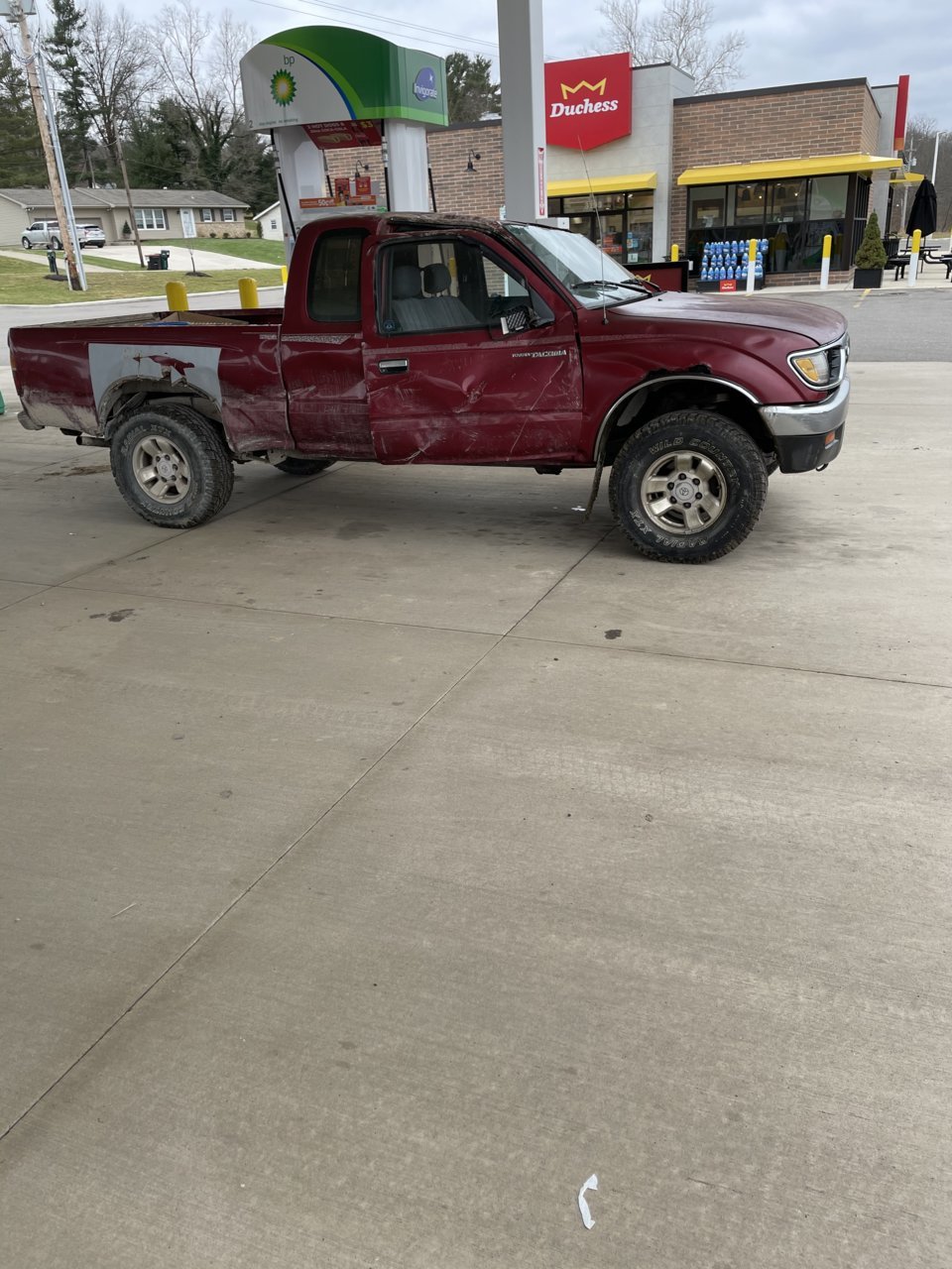

    Yes I went on and verified all the parts I mention are 100% the same according to that page. Good to know I got a good bit of xtra parts laying around. 65D9DDDE-DF98-4978-9FE3-F7CA5A3D2540.jpg
