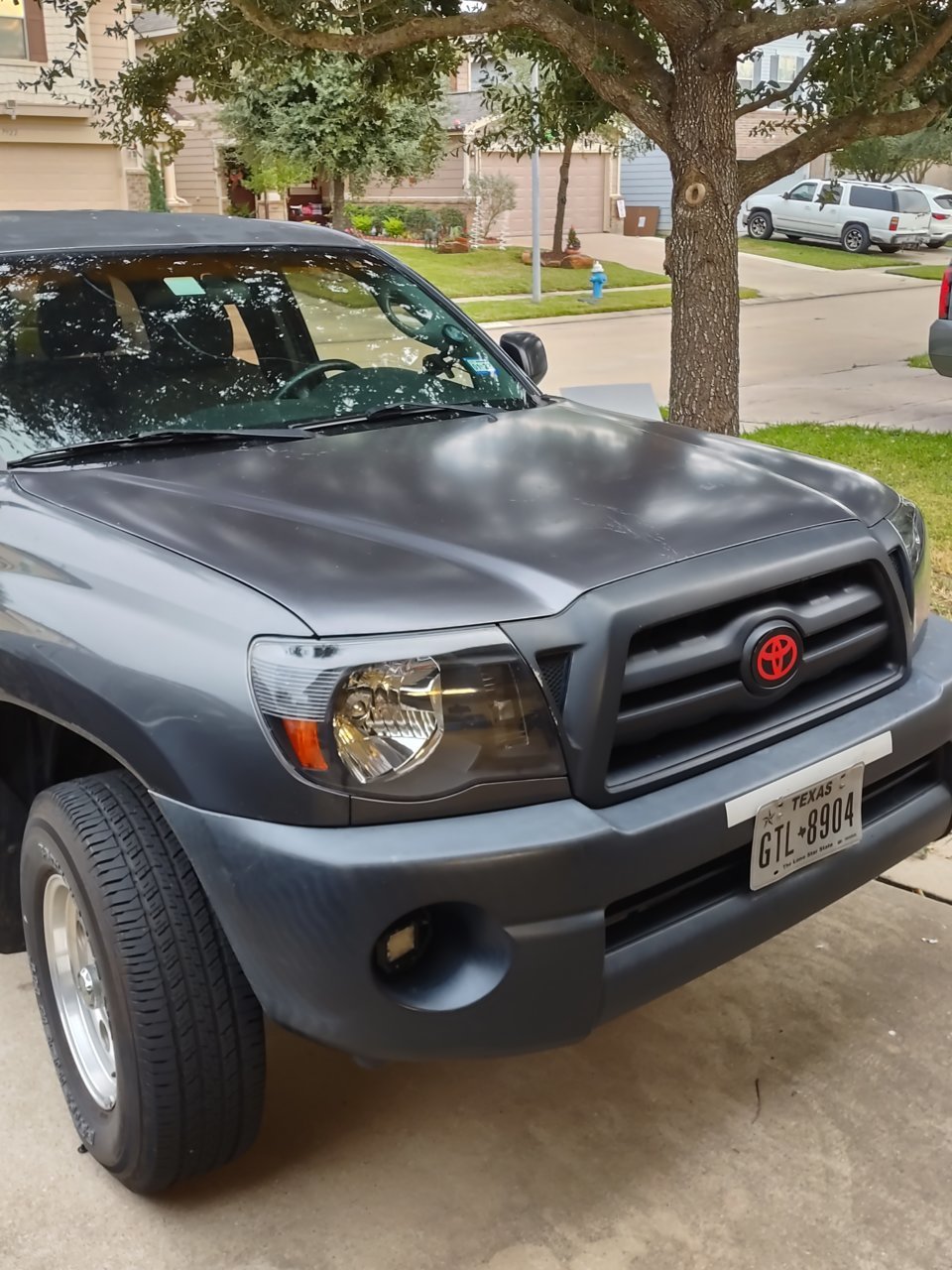

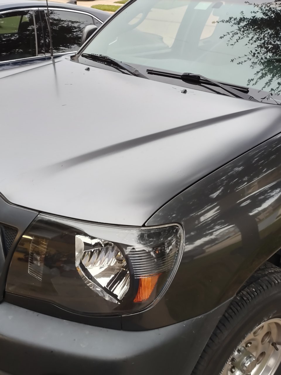

    First time with Wifey's help. I did have some wrinkles that I couldn't remove though. Total cost was 40$. For the wrap.20211206_165534_HDR.jpg 20211206_165605_HDR.jpg 20211206_165534_HDR.jpg

    Looks great. I've got indigo blue and need something for hood and roof.
