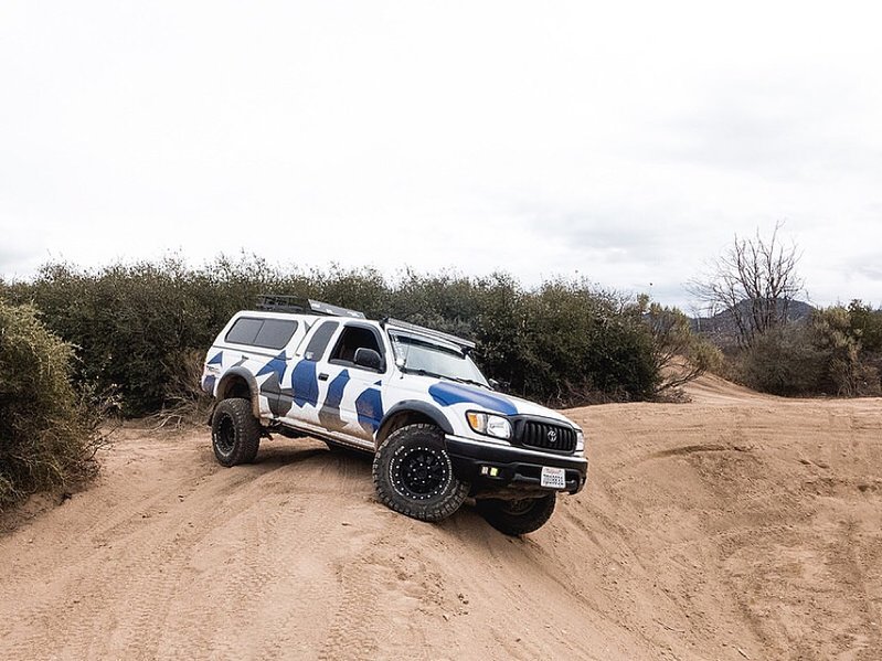

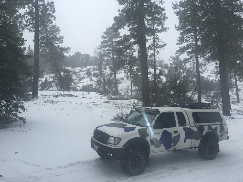

    Digital camo wrap this guy did. Said it held up great in the woods.

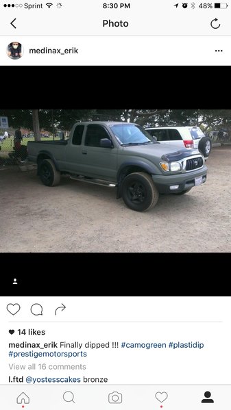

    Hey I did this to my truck I plasti dip the whole truck camo green it's nice but it's hard to keep clean and if something pinstripe it or something it hard to repair and looks ugly. I camo my truck with vinyl and loved it. Just make sure you heat it up real good and press firmly. It will last you more time and protect the paint more and if one piece comes off. You can always add an other piece on!

    Just wanted to show off a bit I wish I still had the old truck

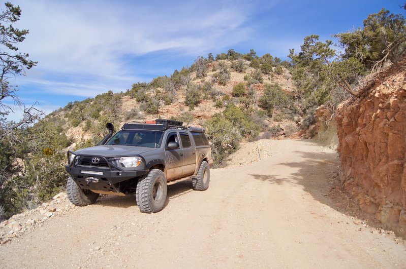

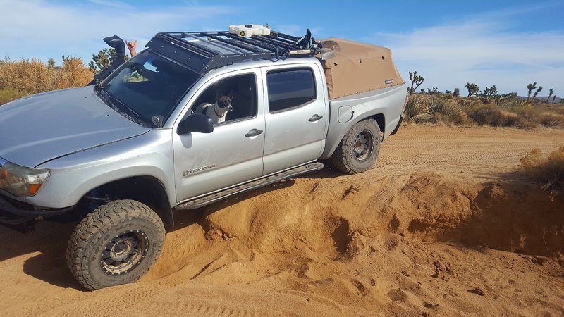

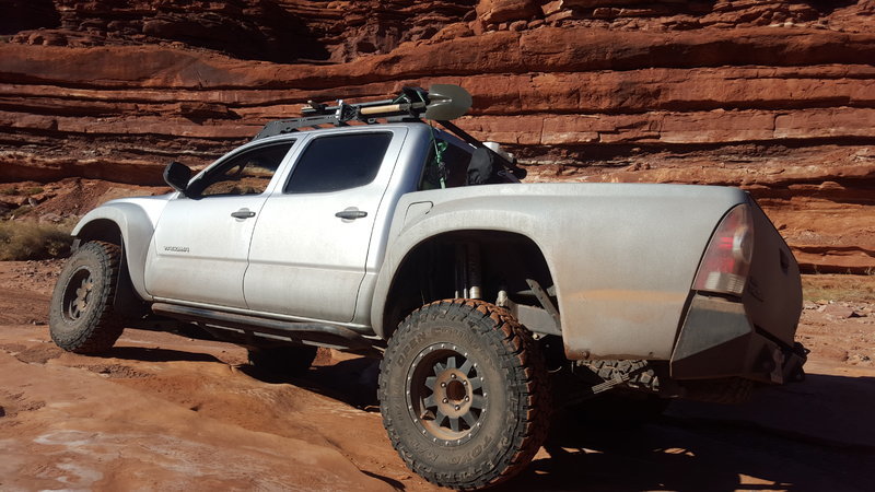

    Might I offer something different. Not sure if you ever plan on selling your truck but you could look at Line-x. I got mine line-xed about 2 years ago with a color match (1E7). Not the whole truck but my fiberglass bedsides, quarter panels, tailgate, and part of my front fenders. So far the Linex has held up great and has not faded since I got the "Linex Ultra" which has some type of UV protectant in it. The silver is the correct color match but is a little darker on cloudy days due to the texture.
    They can do that pattern that you depicted in the pic of your original post. I have tried plasti-dip and to me it isn't worth the effort and doesn't hold up to pin-stripes.
    Here are pics for reference.

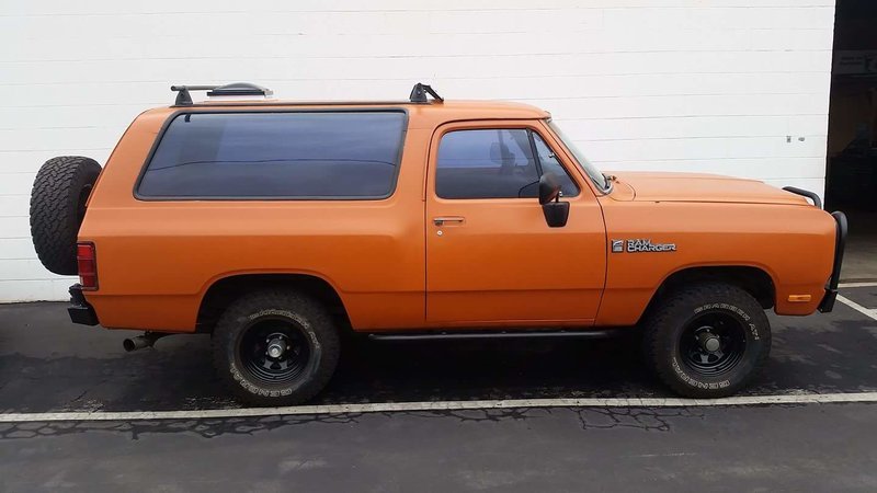

    Cost was about $1100. That includes Surface prep and the color match 1E7 paint, but I took all my bumpers and rock rails off. Every linex dealer is different and you can usually negotiate price. Price would be cheaper for just the Black with the Ultra (UV protectant).

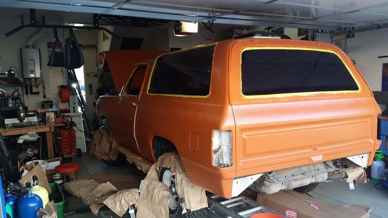

    You can also do Monsta Liner if you wanna save money. My buddy just did his Dodge Ram-charger. Monstaliner has UV stabilizers in it and no rubber fill like some other common bed liners. I might end up doing the rest of my truck in monstaliner if I can figure out how to correctly Tint the color.
    Some pics of my buddies project:

    Oh man I love orange on old trucks. We have a friend of ours that brings his Charger out with us sometimes. That thing is baller.

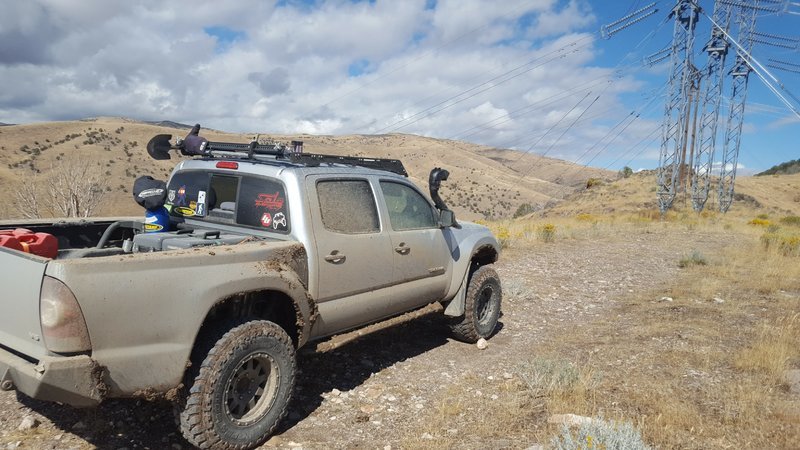

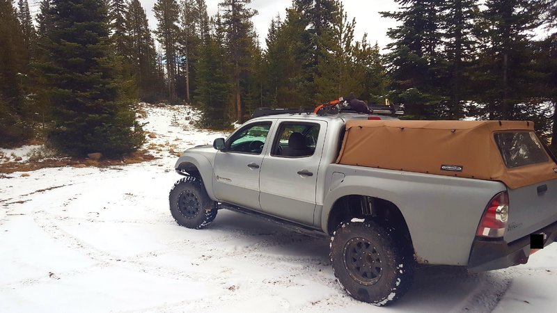

    My rock rails are that spray on rattle-can bedliner (Rustolem) and that does absorb some dirt. But my line-x does not really absorb (doesn't have deep pours). Dirt just sticks to it like it would for any paint. It is gone with the flash of some water out of the hose (literally just falls off and looks new again).
    I live in Utah so we have that common Red clay.
