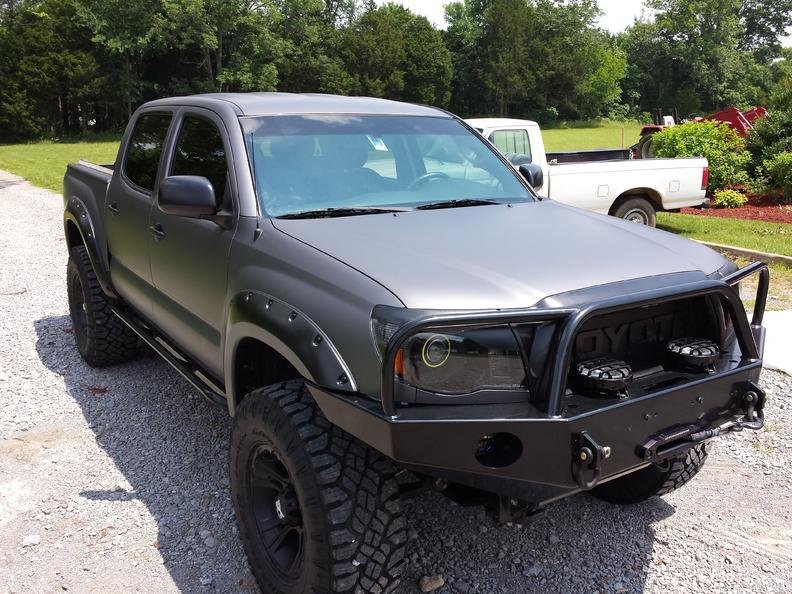

    Well, I thought I would post this here because I have had several people ask about it. I wrapped my truck with 3M 1080 M261, which is the dark matte grey. Took me a while to do, but happy with how it turned out. I had never wrapped anything before this, just watched a lot of YouTube videos and took my time. If you have any questions I would be happy to answer. I hope you like! It turned out pretty good. From 10 feet it looks great, but if you look close you can find a few small places, but overall it looks good for my first time. Actually everything turned out great except the panel that goes over the two doors, down the back door, then under both doors. That was the piece that caused my only issue.

    Looks good. It looks kinda like a cross between MGM and Pyrite Mica in that first picture.

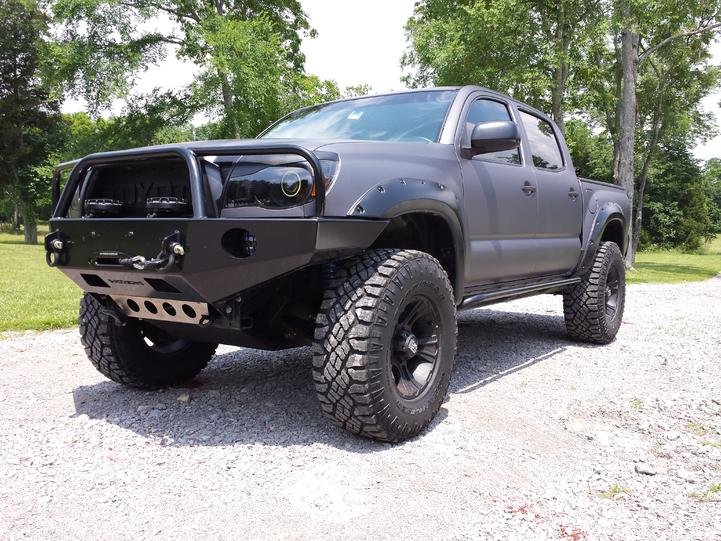

    In the last picture what's up with the difference in color on the fender versus the rest of the truck?

    I think it's just the way the sun is hitting it... It is the exact same and off of the same roll of vinyl.
