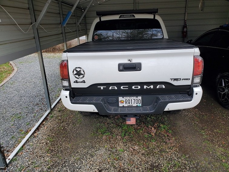

    I did mine 6 months ago using the wraparmor vinyl piece. It is actually more difficult than it appears to get it correct.
    So...ended up calling a friend who does vinyl signs and paying him because it was very time consuming. I'm glad he did it and it was worth the money paid!
    I also bought the white vinyl letter inserts.
    Here's how mine came out...

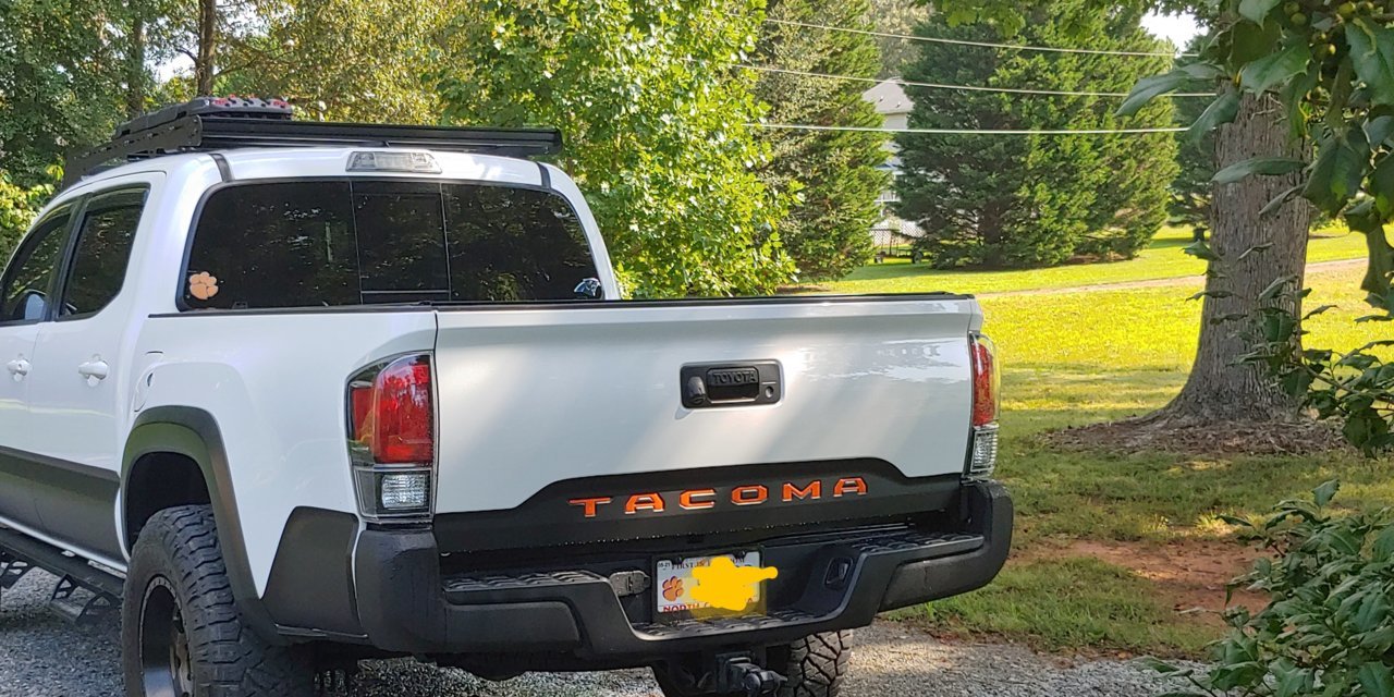

    Heat gun. Not sure about WrapArmour, but mine was Orocal as posted above. I didn’t want to derp it, and Amirak was willing to accept my crazies and “get it right”. I think in the end I did this four times between the vehicles. Use the soap float method to get things right and be patient. Heat gun (HF onsale), a needle and gloved fingers (those ones you have leftover from COVID) work wonderfully. Again, patience is your friend. I did it drinking lemonade under a popup, sitting on a mechanic’s stool. Done in about 4 hours from setup/tear down.
