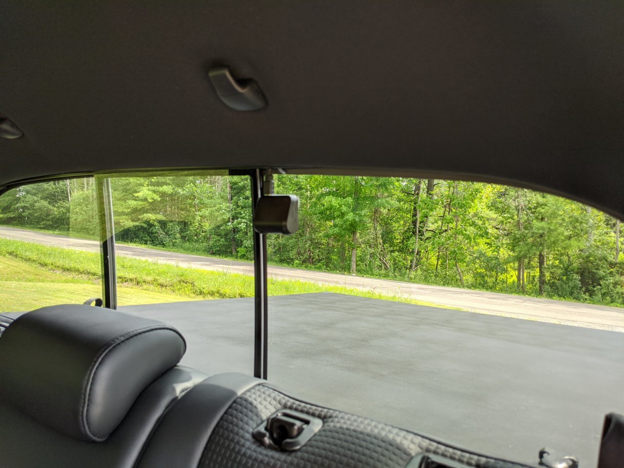

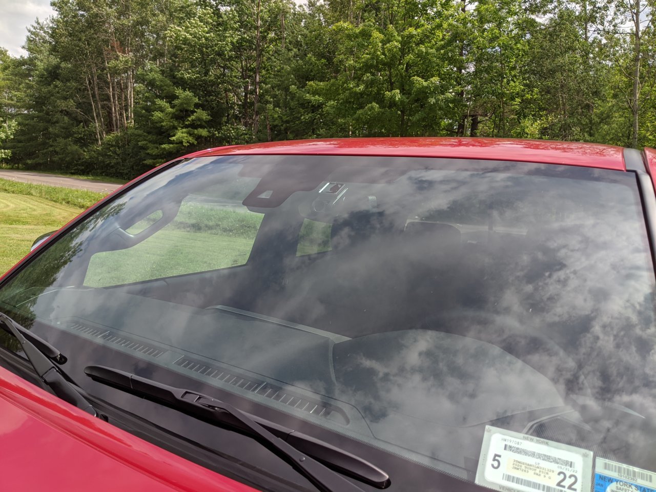

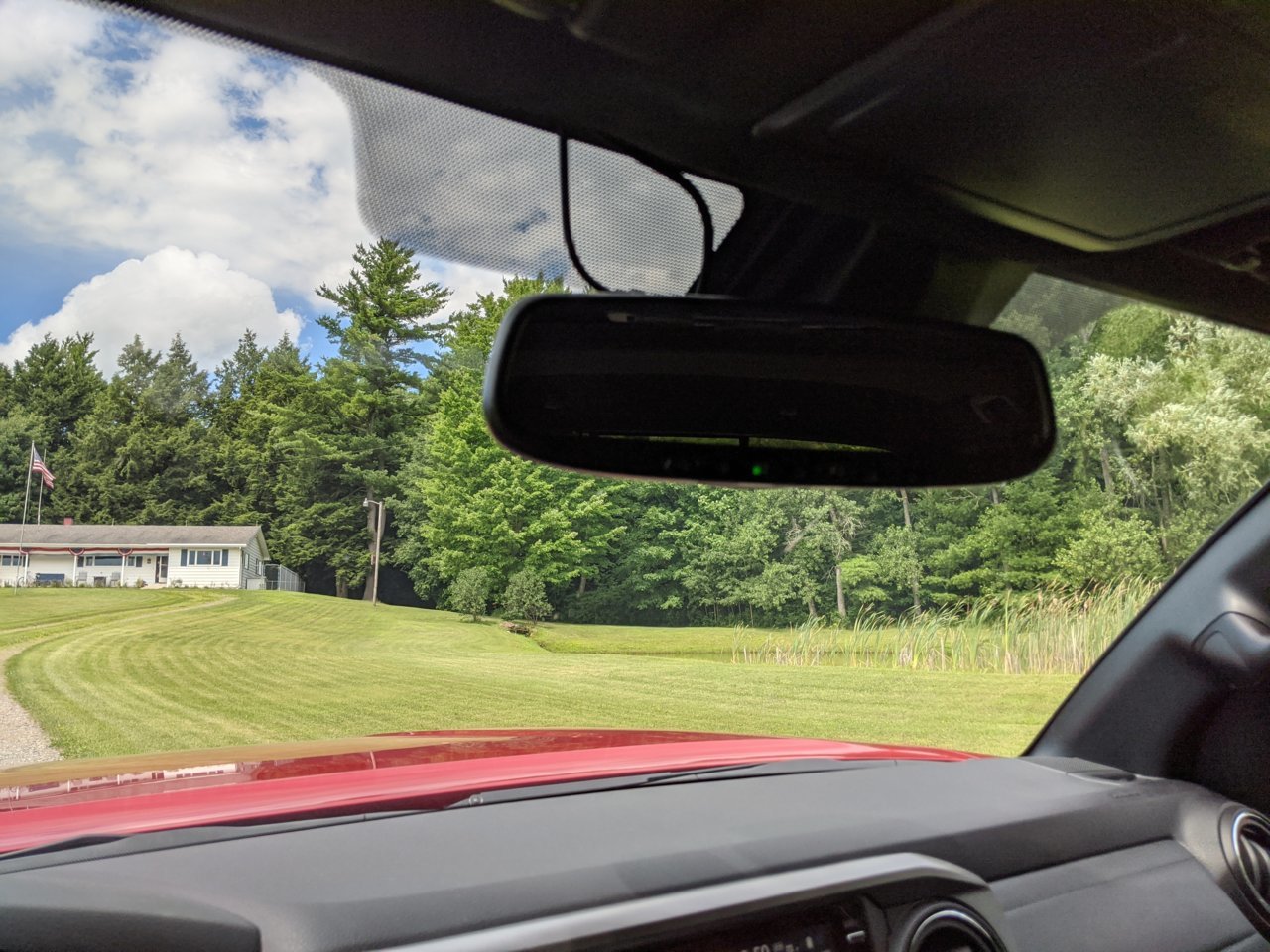

    Step 1: Find the mounting location for both cameras. I took some time doing this, because there are some things to keep in mind. You want the cameras to be fairly well centered in their respected windows. The windshield on my 2020 has the huge housing just to the right of the rear view mirror. You can’t mount too close to this because you won’t be able to remove the rear view camera cable and/or slide the front camera out of the GPS mount if it is too close to the box. You need to leave yourself a little room. You also need to leave some room on top for the two cables that will be connected. I wanted access to the left side of the camera so I could easily remove the memory card so this meant mounting it on the left side of the rear view mirror. Also, if mounted on the right side of the mirror, the camera would be way off center on the windshield and in the passenger’s line of sight big time. Where I mounted mine is out of sight (blocked by the mirror). So, that’s where it ended up. I wanted the rear camera on the passenger’s side to be more out of my line of sight in the rear view mirror. But, you need to leave that window clear so you can open your rear window. So, on the driver’s side it went. Make sure you don’t have the camera up as far as it can go on the window or you won’t have enough room to get the cable plugged in. Too bad the provided cable didn’t have a 90 degree connector on both ends because that would help some here. Both cables were plenty long enough, with some to spare.
    Step 2: Running the cables. This was easier than I thought it would be. You get a nice little plastic prying tool with the unit. This came in real handy. I just pulled the head liner down a little and tucked the cables up into it. I removed the A pillar’s cover and tie wrapped the cables down inside it away from the air bag. I used a plastic, triangular shaped pry tool I already had (looks like a big guitar pick) to remove the plastic tab over the 10mm bolt. After removing the bolt, the cover came right off easily. From there the cables went behind the weather stripping and the power cable when up into the underside of the dash where the fuse box it. The rear camera cable when under the floor trim pieces and up behind the rear seat. The seat’s folding down made this part a piece of cake. This made for a nice, clean install and the cables are only visible where they mount into the cameras and no damage, scratches, etc. on any trim. Air bags/curtains are unobstructed.
    I connected the add-a-fuse taps this way: Battery (red lead) to the sun roof. ACC (yellow lead) to a USB fuse. Make sure when you install these you plug them into the fuse block in the correct direction so the power goes through the fuse. If install backwards, they will be connected directly to the hot side and the voltage will not be going through the fuse. I verified mine were correct by testing with and without the fuses installed and verified they went dead with the fuse removed.

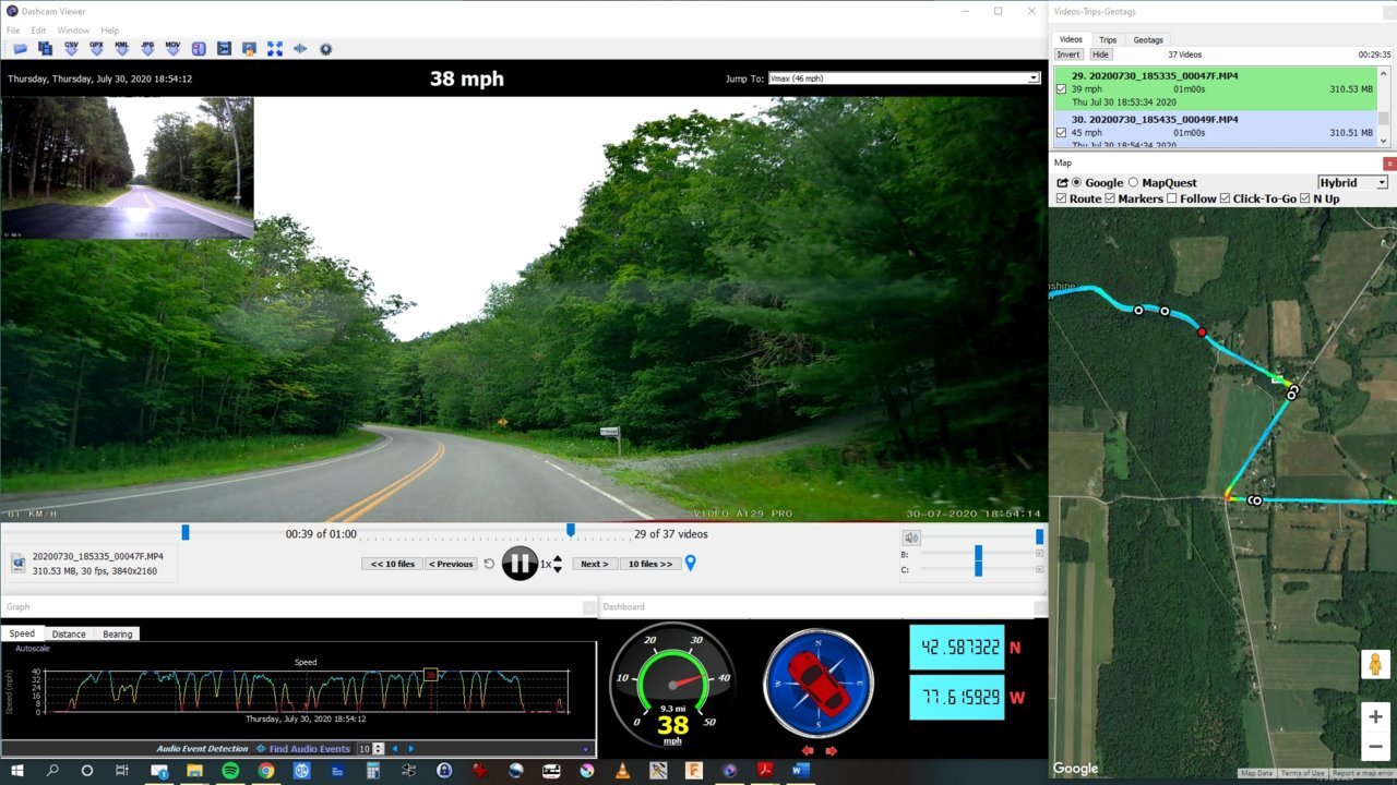

    Step 3: The fun begins! Now it’s time to drive some, do some recording and make tweaks. One thing to keep in mind is recording in 4K creates HUGE files! I think it’s best to just pop out the memory card and put it into the provided mini card to USB connector and stick it into your PC. Even copying the files from the card to your PC will take FOREVER! But, you can easily access the files right off the card. Using DashCam Viewer makes this easy peezy. There’s a free version available, but after using it for 10 minutes I bought it because it's awesome. It’s great with a Google Maps GPS track of where you drove, picture in picture of your two cameras, you can click on the GPS track and it will take the video right to that point and many, many more ways to play. It also knits all the individual movie clips together for continuous viewing. I am not affiliated with them, just very happy with the viewer. You’ll notice in the screen shot I posted that the speed is in KPH, time is off, etc.. I wondered what was going on since I changed all this in the setup menu of the camera. Then it dawned on me I updated the firmware to the latest release and it must have changed everything back to default settings. So, I suggest that you check that right away and get the latest version for yours if you get one and then change your settings. Also, if you register your camera from Viofo they will extend the 12 month warranty to 18 months so it's worth your time to do so.
    Don’t do what I did! I screwed up and forgot to remove the little white strip of plastic that’s on the mounting adhesive pad that allows easy removal of the protective covering... This doesn’t really hurt anything, but the white strip makes the camera a little less stealth. The cameras themselves are not that noticeable, but the white strip does show up behind the mirror from the outside. But, for now, I’m leaving it alone. Maybe after I make sure both cameras are mounted where I want them after testing I’ll think about removing them as re-installing. You get some extra adhesive strips with the camera so I can remount if I so choose.

    hey, I am looking to add a dashcam to my Taco, how did you get the power wire past the black camera box?

    I don't understand the question "how did you get the power wire past the black camera box?"

    Sorry, I see how that could be confusing. You installed the new dashcam to the left of center on the front windshield. In getting power to the dashcam, you ran it up the passenger A-pillar and then across the top of the windshield stuffed into the headliner. How did you get it past the black cover on the passenger side of the rearview mirror to the left side of the mirror? Thanks very much.

    I ran the cable up the driver's side A-pillar, not the passenger side.

    Smart guy, Good call. I ran it up the passenger side in my old 2009 taco, I read your install and just assumed you did the same. Thanks.
