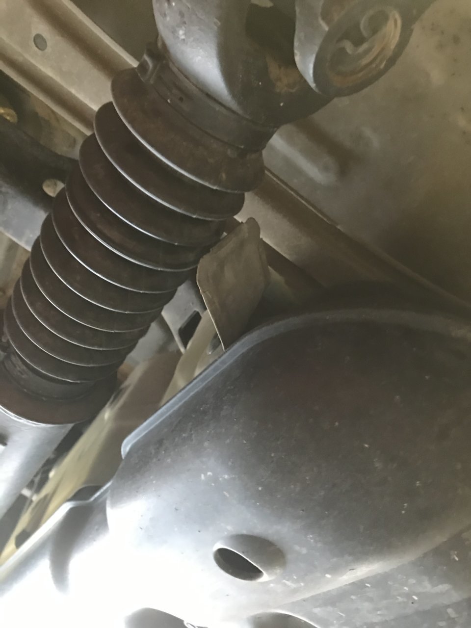

    Check the Center driveshaft boot. . No joke if it’s not lubed properly it will clunk like a MF
    Yetimetchkangmi likes this.

    I’m not sure I know what that is? The rubber bushing of the center bearing?

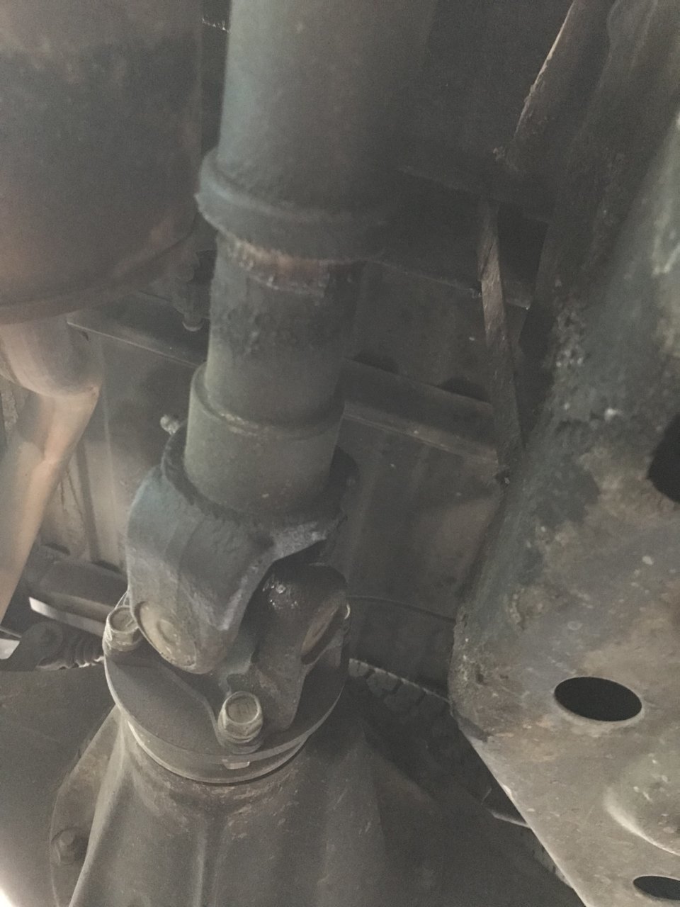

  18. Mar 28, 2019 at 4:49 PM
    #18
    jeg0005
    jeg0005 [OP] Well-Known Member
    Jan 21, 2019
    #280139
    707
    Jon
    BHM, AL
    2001 Tacoma SR5 double cab
    Full OME 883s, SPC UCAs, 33" STT Pros
  19. Mar 28, 2019 at 5:08 PM
    #19
    jeg0005
    Jan 21, 2019
    #280139
    707
    Jon
    BHM, AL
    I didn’t think so either. So what are your thoughts? Brakes? I just changed the rear diff fluid 2 months ago and it looked good. No chunks of metal to be seen
  20. Mar 28, 2019 at 5:10 PM
    #20
    Jason TRD OR
    Jason TRD OR SIBI BUILT LLC
    Feb 19, 2017
    #211030
    1,365
    Jason
    Sibi Built LLC Placentia, CA
    16 Tacoma TRD Off Road 4X4
    King suspension w/ compression adjusters custom valving and 700# coils. Icon DJ uca. Icon RXT leafs Option #3. Durobumps. Demello rock sliders. Demello 30” Light Bar Baja Hoop bumper with Smittybuilt X2O winch w/ Amber baja design fogs w/ single row Baja Designs S8 amber light bar. Brute force Fab HC rear bumper. Behind Grille Light bar. TRD Pro Skid plate. Pelfrey Mid and Transfer case skid. TC spindle and cam tab gussets. Pop and lock. Method NV wheels 16”. SpiderTrax 1.25” wheel adapters. Yokohama Geolandar M/T (315/75/16). CMC. Radiator core reinforcement. Pro grille. Tailgate inlays. Baja Designs A pillar Ditch lights. Leer 100 XQ shell w/ power locks. In bed mounted spare. Blacked out emblems. Bed Mat. Bed Stiffeners. K&N air filter. Black Headlight Mod w/ LED projectors. Wrap Armor Anti glare hood and bedside decals. American flag decals. Northstar 24F AGM Pro battery. Differential breather relocate to rear tail light. Prinsu Designs Cabrack and Cap rack. OVTUNE Sibi Custom performance 4.88 91 fuel AGM . Nitro Gear 4:88 gears. Mountain hatch tailgate insert. In bed mounted Krazy Beaver shovel with Relentless quick fist bedrail mounts. MESO ultimate turn signals. AJT Designs Quicksand Key Fob. ECGS front needle bearing bushing replacement. Tepui LoPro 2 RTT.
    Lube that part where the two driveshafts slip together I bet the clunk goes away
