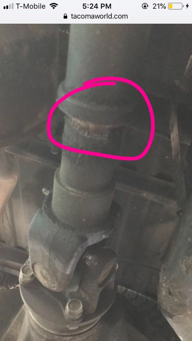

    that’s the slip yoke, right?

    Grease the spline

    Give it a try and also try retorqing your u bolts

    Grease everything up, like I said jack it up and turn the wheels in neutral and see if there's any noise coming from the diff.
    3 things"
    *diff (dump the fluid and check for metal shavings, if none present just use the same fluid if you want)
    *driveshaft (grease all fittings, I doubt u joints are the issue?
    *tranny (worst case scenario, take it to a shop and have them check it)
    I just got my tranny rebuilt with only 87k miles on it.

    I don't have an driveshaft boot like that either and would be surprised if that's the transmission.
    Just some thoughts:
    Transmission: Get rolling, put in N and apply brakes. might rule transmission out.
    My brain goes to making sure the u-bolts are torqued correctly and I'd aim to blame the diff.
    As for your comment about warming up, seems these transmissions like to "lunge" forward sometimes when cold. usually settles down after a while.
    Keep us posted on what you find. hope the suggestions help in some way.

    Check the rear brakes, reminds me of my fiancé’s jeep. Same concept was happening, I removed the rear drum to find the brake pads in pieces.

    I would just lube all the zirks because it should be done anyway, then pull the drums off and see what you’ve got. Order of simplicity. Go from there.

    Stop driving it before it does damage to the transmission. Drain the differential fluid and check for metal parts or shavings in the fluid.
