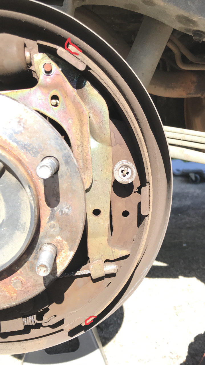

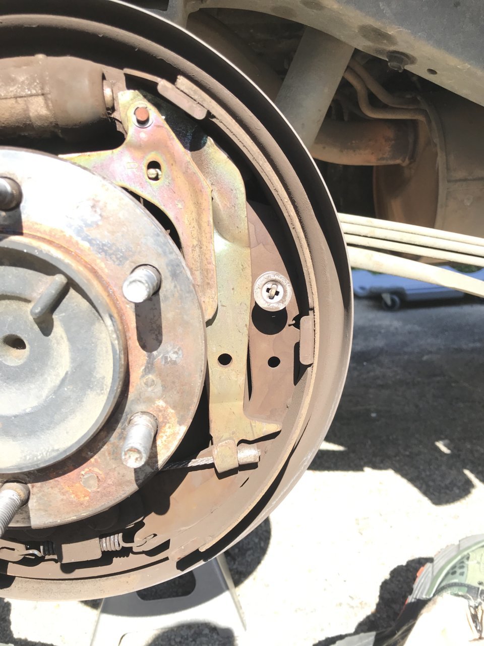

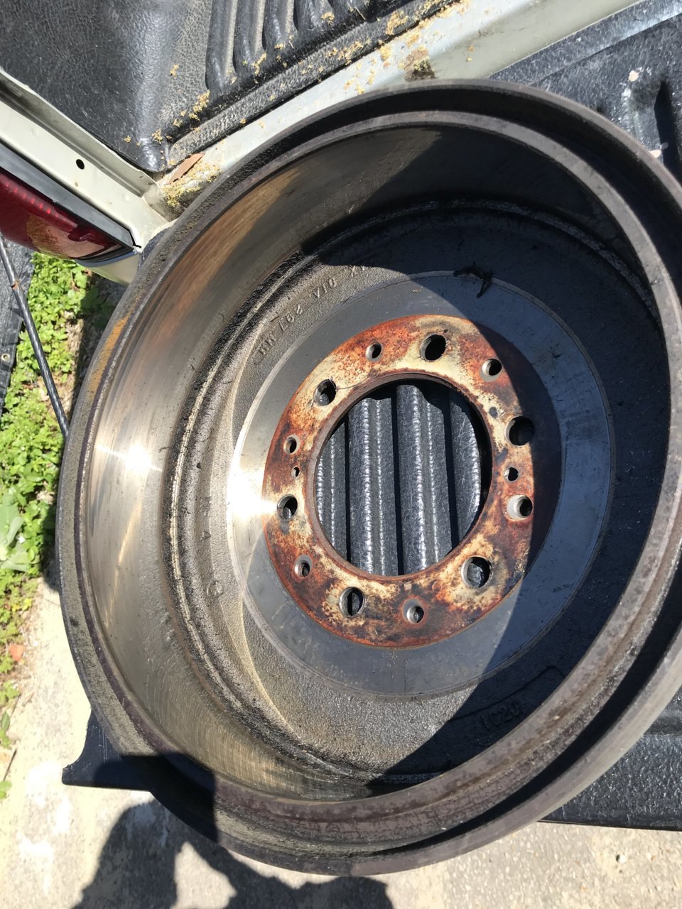

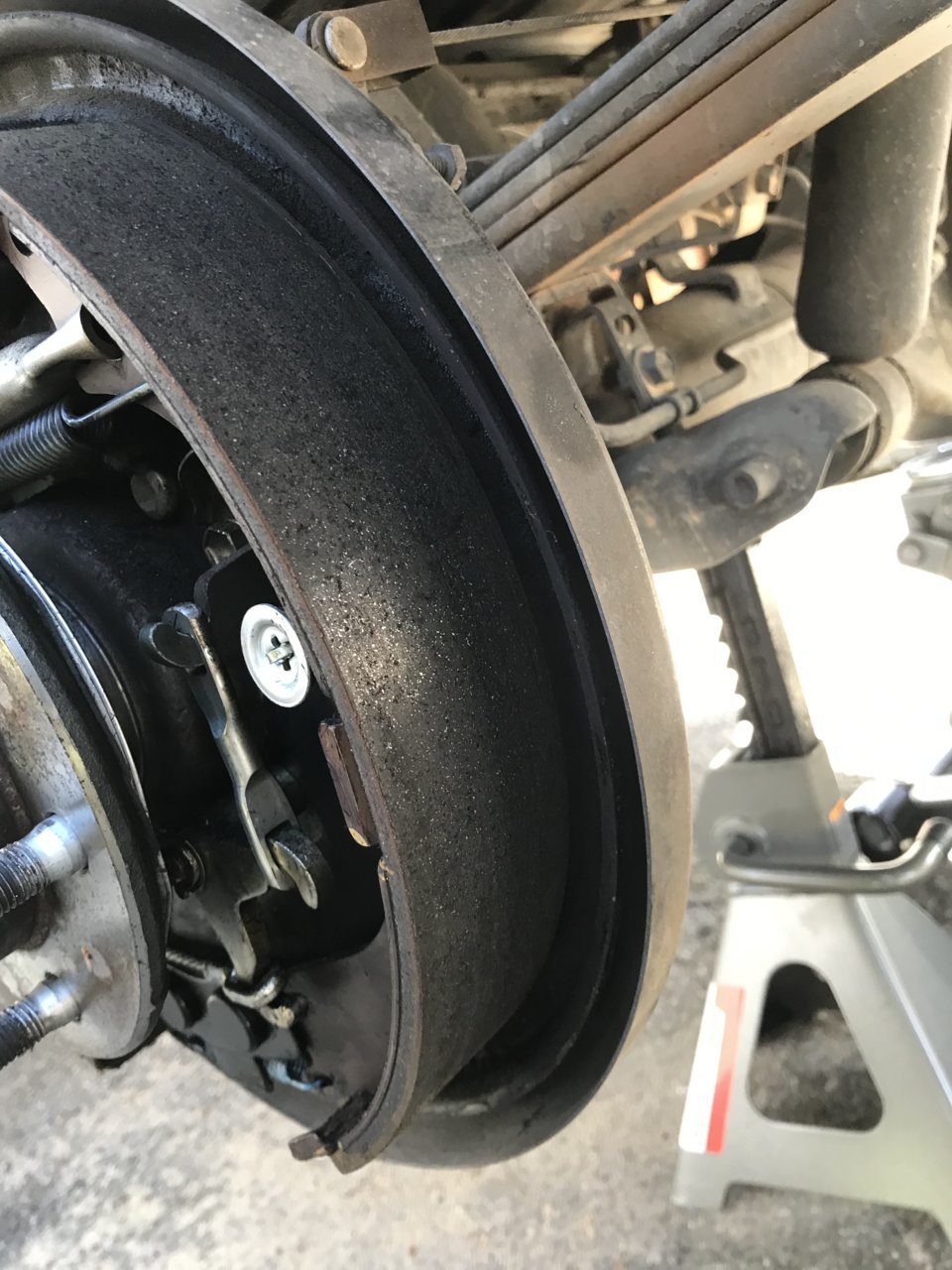

    0B18B5E5-7AA7-4E2E-8BDE-04DE137E4BD3.jpg 65ED8C26-082A-45EC-A02D-A26BD3601FA4.jpg 1CD5D359-DEB6-4D00-9D6A-59CC10AAB567.jpg A665560C-9CA1-411B-BEC5-23A9E45B4FCA.jpg F23FE165-8A42-41CA-8ED0-673D38158B2A.jpg Driver’s side rear brake. Nothing seems a miss to my untrained eye...

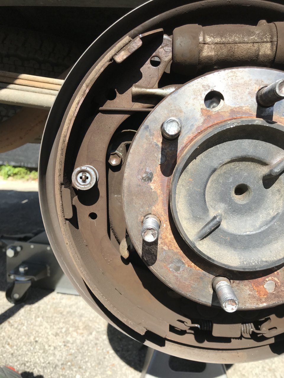

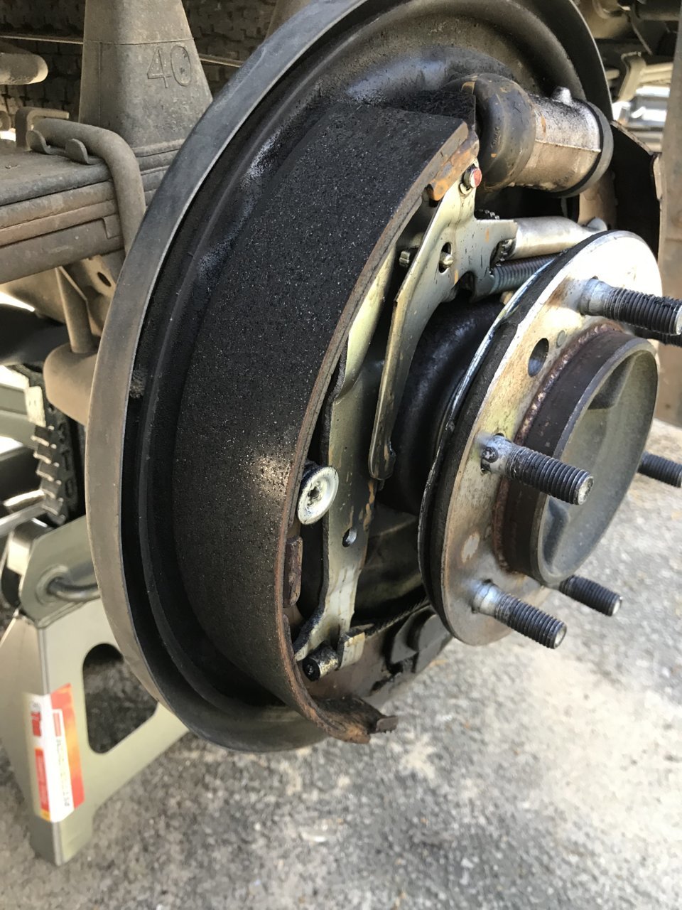

    Passenger side rear brake

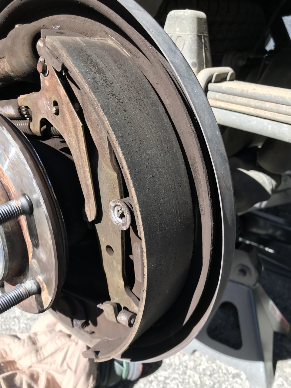

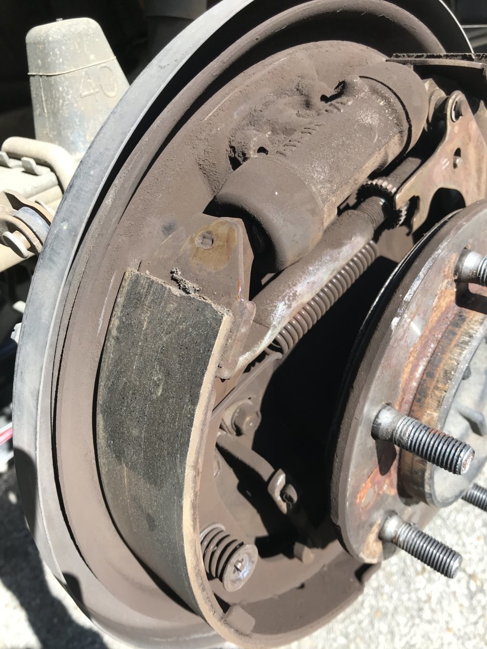

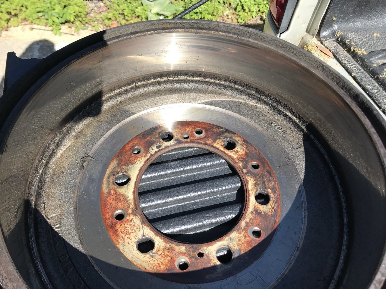

    Notice the difference in front shoe thickness on passenger side rear ...what could this indicate? 2429C0D9-D2A7-46B7-B21A-CF8FD2294DBF.jpg

    Ok so I’ve fixed it for now. I’ll try to post a video. All I did was replace the shoes and drum on the passenger side rear brakes with shoes from the donor axle I have laying around. When I swap the axles, I’ll do a complete brake job. But there is no longer any clunking when I brake.
    How did I narrow it down to the passenger side? I noticed that the passenger side brakes looked older and more work than the driver side. The front show was almost completely gone and the ends of the shoes were crumbling. The drum had visible and very feelable ridges and imperfections in it. I cleaned it all off and replaced the shoes as stated above. Reused all parts (don’t recommend this for a permanent fix) and put it back together. No more clunk. I’ll post a video soon.

    I was going to say it sounds like brake "chatter" and not trans or diff problem.
    why does your driver's side look so clean compared to the passenger side? did you do recent work on it, replace parts? have you adjusted the round bar so that you have "minimal" clearance on the driver's side (using the e-brake will self-adjust)?
    you should be able to put the drum on over the shoes and have it rotate without scraping but not so much that it doesn't make solid contact with the drum when you press the pedal, which by looking at the shoes on the driver's side appear they aren't really engaging. The cylinder does not move much so more than 1/2" is too much play. They should be slightly shiny and smoother like the passenger side.

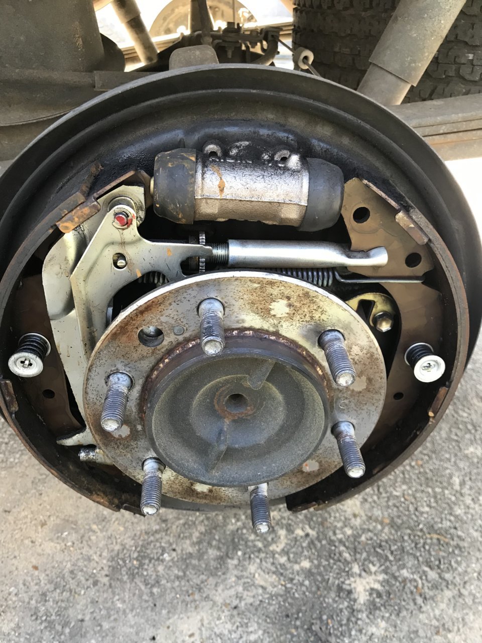

    Not an expert but i have never seen drum wear like this or as seen on one of your other photos. I would considering getting new pads and the drums turned. Or maybe swap out the drivers side brakes too with some from the donor axle.
