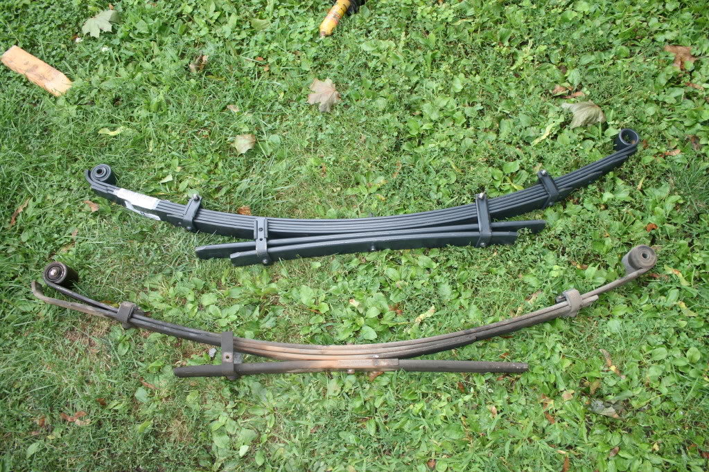

    If you're overloading it that much I would be surprised if you didn't have a broken spring or two. Tacoma leaf springs aren't very good at holding up to loads.
    Bottom one is stock. The top one is a Dakar leaf pack.
