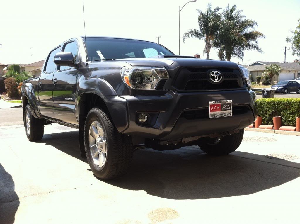

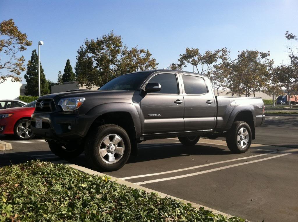

    I was given the opportunity to build my 2013 Tacoma DCLB for this year's SEMA show, so I'll be documenting the build here. Since I only have about roughly a month to do this, it will be quite the challenge to say the least but one that I am glad to take on. The truck is being built with an Overland theme in mind and I am fortunate enough to have great support from awesome manufacturers, many I am sure you are all very familiar with.
    As she sits now, after the 2013 SEMA show. - Red Rock Canyon State Park, NV 11/09/2013
    When I first got her back in August

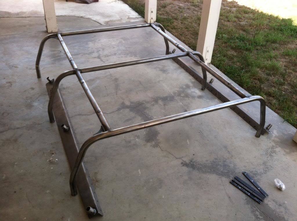

    We were able to get the All-Pro Pack Rack on this weekend. This one was a bit hairy, the provided hardware bolts didn't seem to work so we had to improvise a bit with washers, but in the end it worked out. I'll be replacing the mounting plate hardware with correct length tamper proof torx bolts soon.
    Here's the final installed product. I had the AP logo painted silver as an added touch.

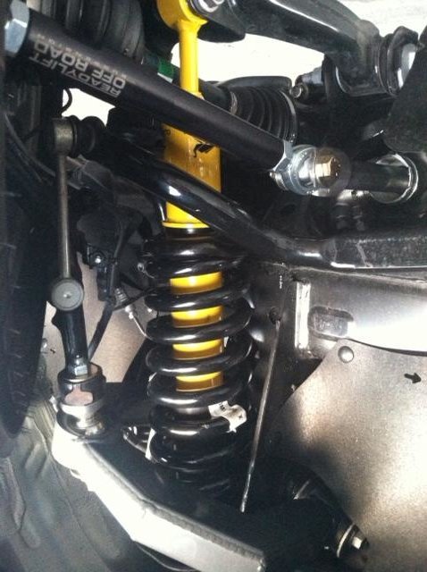

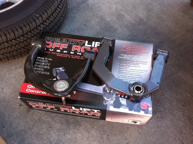

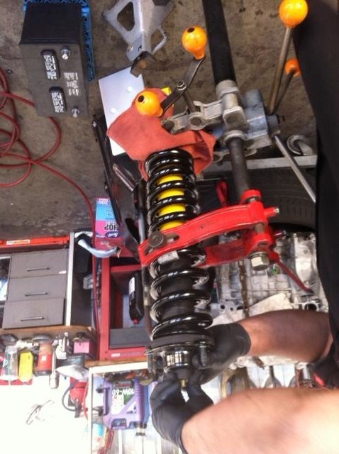

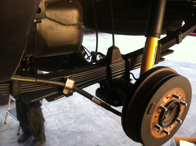

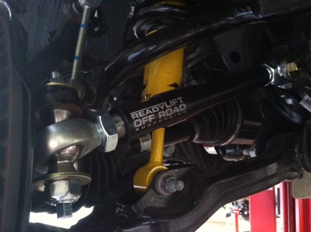

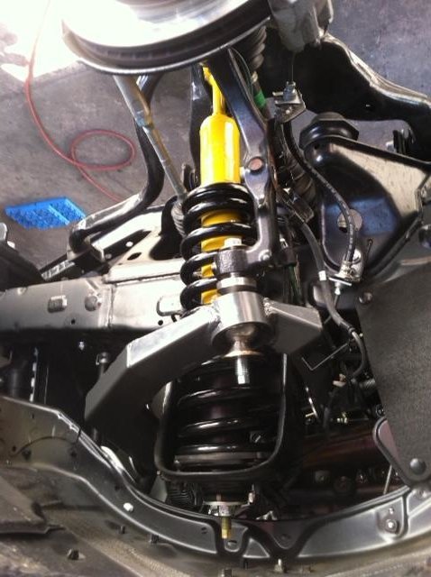

    Had a busy weekend getting the suspension goodies installed. Put on the OME Heavy suspension along with the Ready Lift UCA's and Steering kit.
    Stock UCA's vs. Ready Lift UCA's
    Dakar Leaf packs and rear Nitrocharger shocks are on!
    Better shot of the Ready Lift UCA getting installed
    Ready Lift Steering kit is on!
    The OME kit came with a drive shaft spacer as well
    All done!
    Height after the suspension lift and alignment.

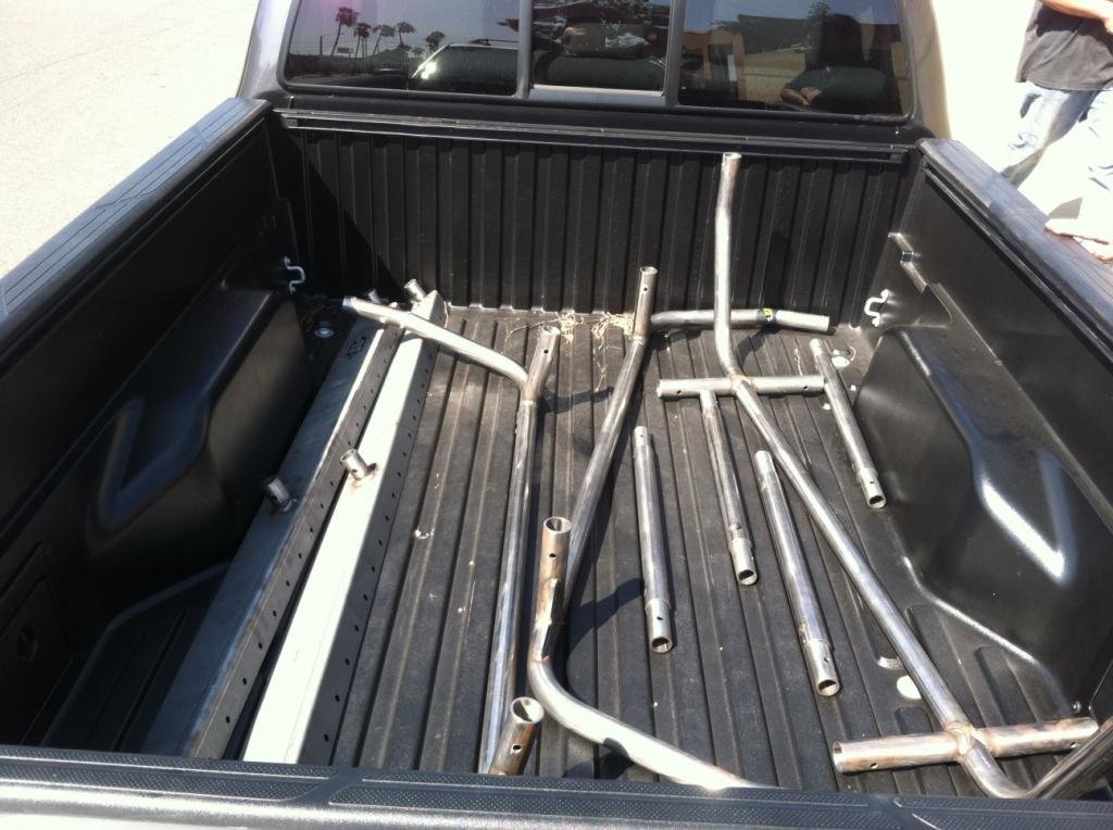

    The All-Pro Offroad Pack Rack showed up late last week. I received the bolt-on version and it came in a bare metal finish. I mocked it up real quick to see what it looks like and it looks great, it'll look even better once it comes back from Powder coating.
    image8_zps7b56f7d3_54a298af18a88a999f5dbca5b6ca8edfe5418afb.jpg[​IMG]Dropping everything off to get coated in a semi gloss black

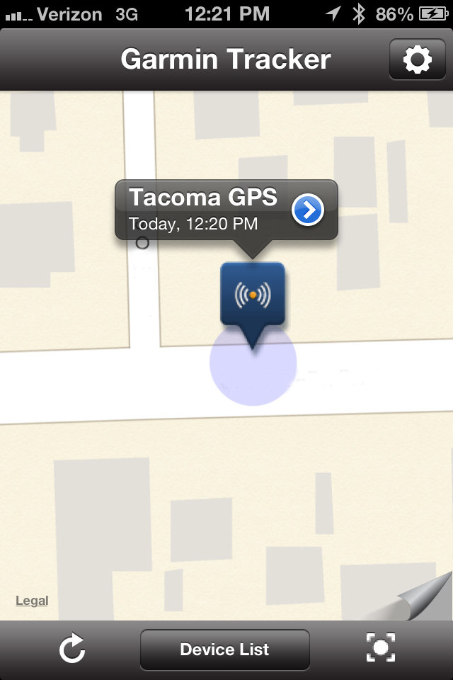

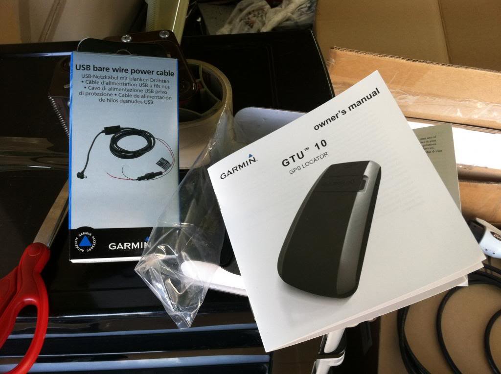

    On a side note, I addressed vehicle security while waiting on a few things to get back from powder coating.
    So, instead of an alarm, since the vehicle already has an immobilizer, I opted for a GPS tracker in the interest of recovery, not so much prevention.
    Using a Garmin GTU-10 tracker, I am able to track my vehicle's whereabouts on demand through an app. I was also able to create Geofences that will alert me via email and by text should the vehicle leave the designated area. The device charges of off the vehicle and should the thieves disconnect the power source, the tracker has a battery life that lasts several days based on a balanced usage schedule.
    Pretty neat stuff.

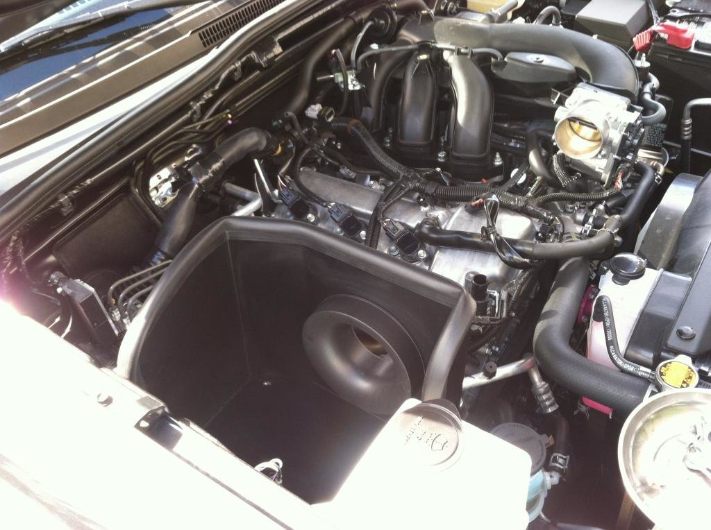

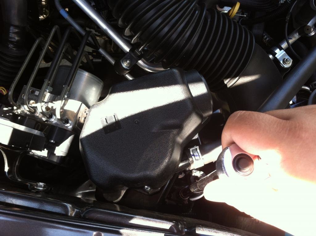

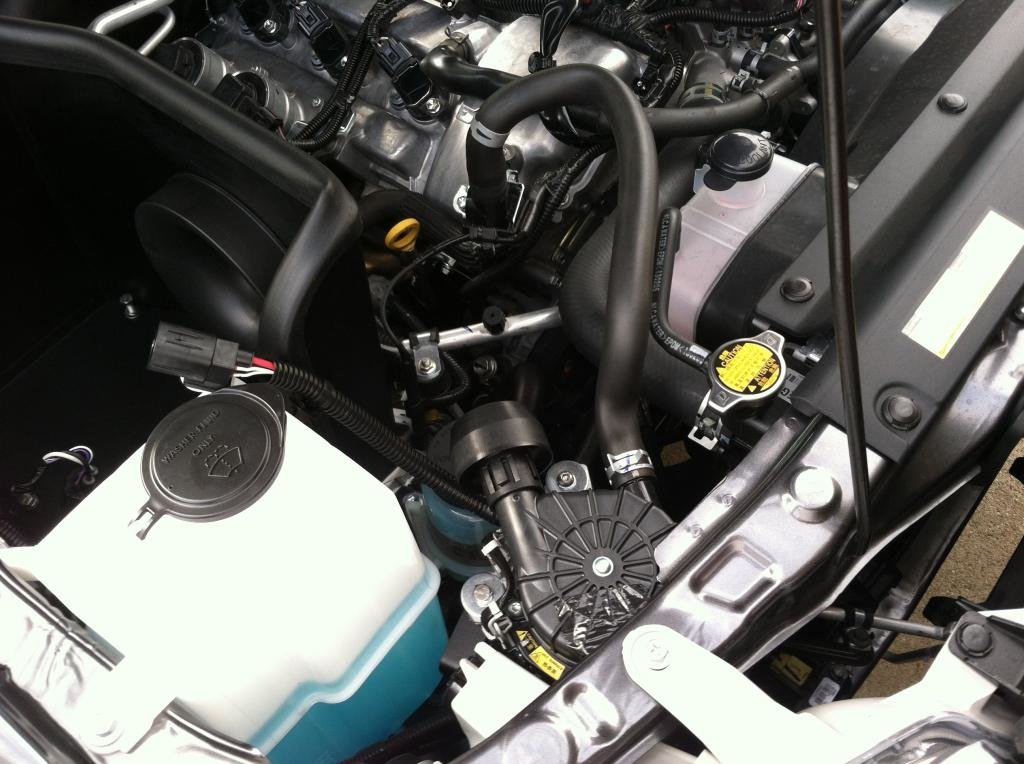

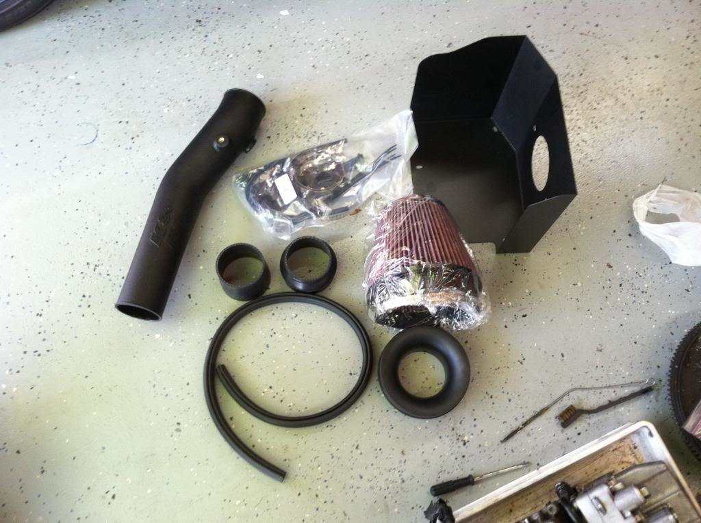

    The guys over at K&N sent over their AirCharger Air Intake for the 2012- 2013 Tacoma.
    The kit itself is simple and the instructions make it quite easy to install.
    If any of you are familiar, the 12-13 Tacoma has a secondary air pump that is located where the air filter will go. This posed a bit of a problem up until recently (Late last year IIRC) regarding how to go about relocating the pump effectively. The solution was simple enough, K&N provides new brackets that relocates the pump next to the passenger side headlight on the other end of the coolant reservoir.
    Secondary Air Pump relocated.
    Install complete!
    The AirCharger has a nice sound to it at around 2000-3000 RPM, then gets super loud at 4000+ RPM. According to K&N their dyno test showed a gain of 8.6hp, pretty impressive my butt dyno felt the same.

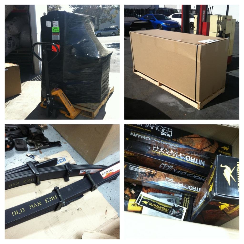

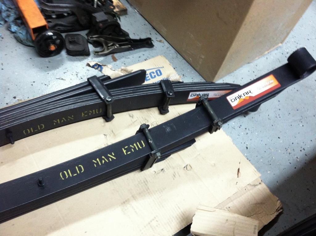

    All of my ARB gear and Bushwacker fenders arrived! I'll update as I begin installing various parts very soon.
    Dakar Leaf Packs are super buff!
    Intensity LED Spot and Flood
    There's a ton of ARB stuff that came on the 2 pallets but I'll have to get to it at a later post.
