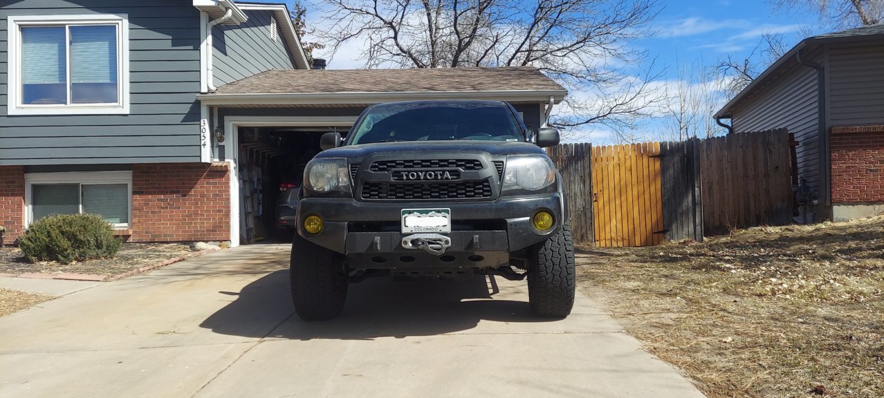

    Just did mine today. I trimmed the front screw mount off the wheel well liner, poked a hole, and zip tied them up to the fog light buckets.

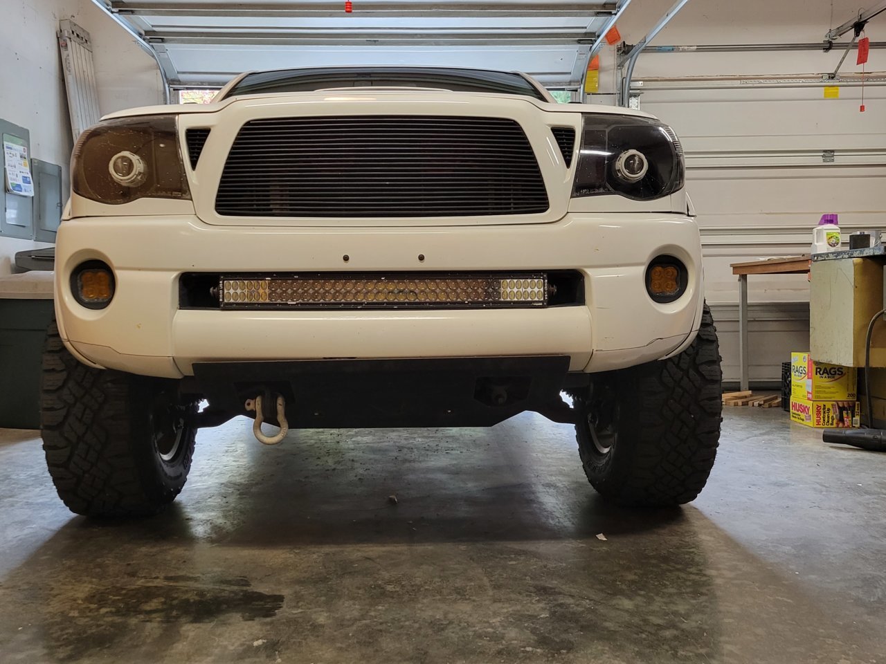

    Hadn't seen it before. Figured I'd do it

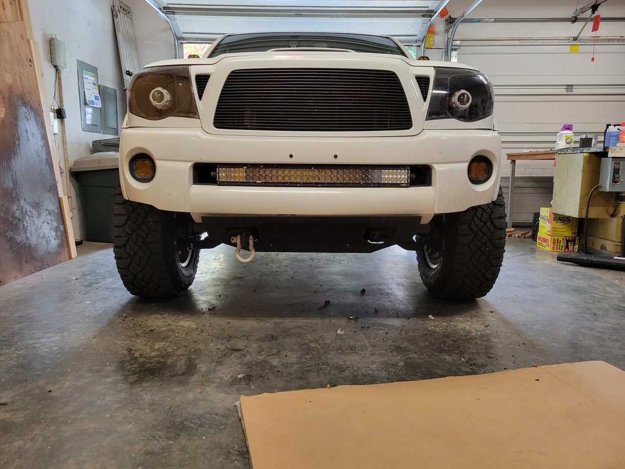

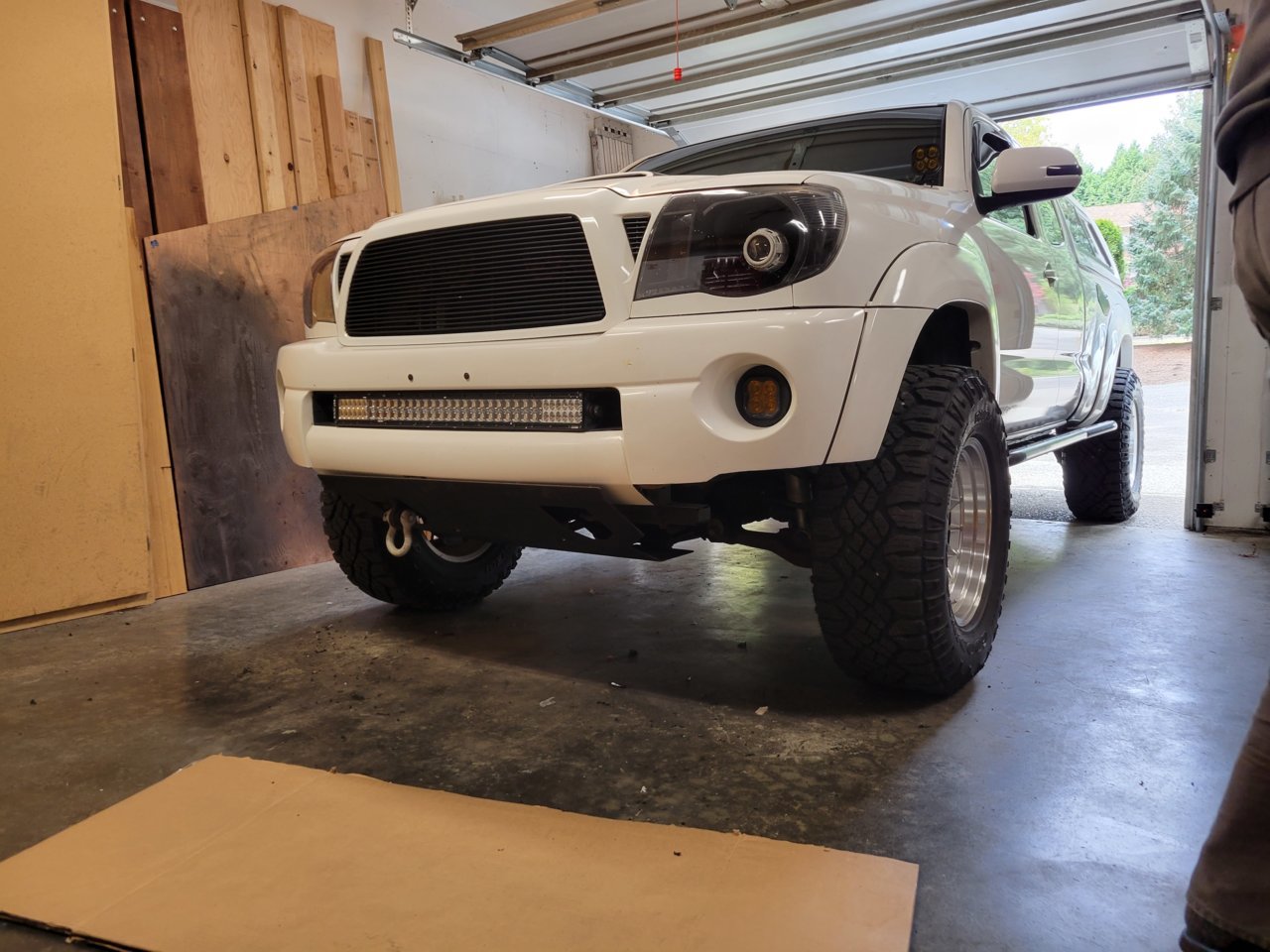

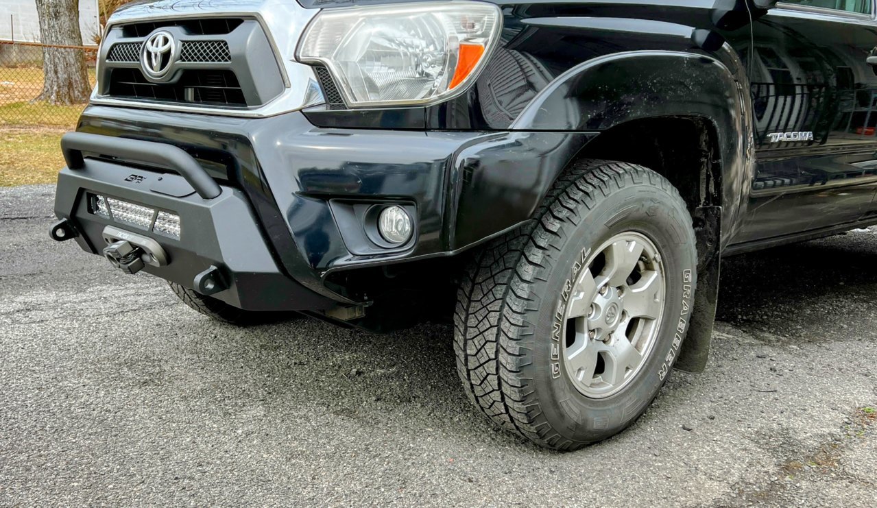

    i just cut mine to match the front[​IMG] this is how i did mine. the inner fender i just cut straight accross if i remember ill take a pic later for you

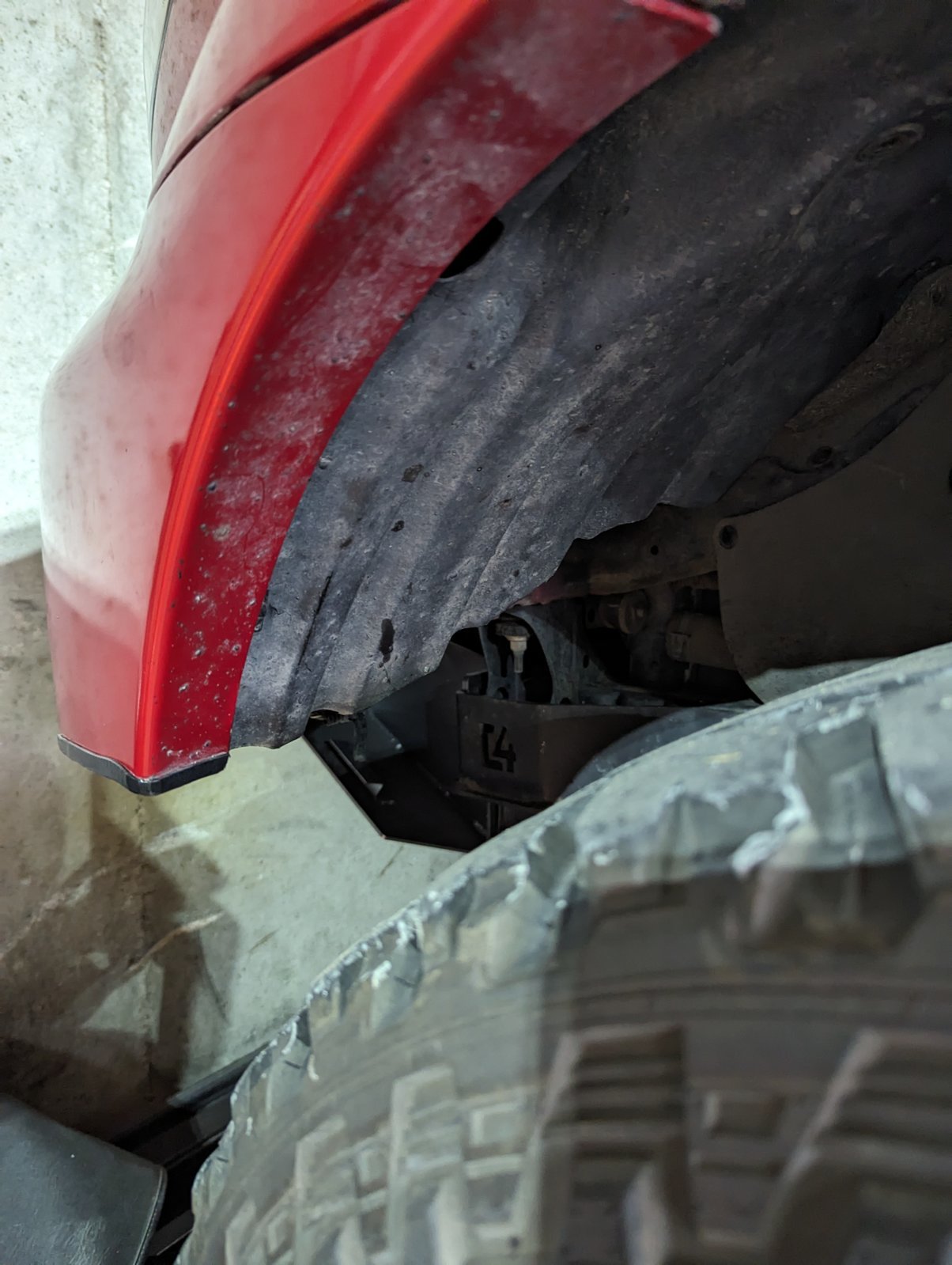

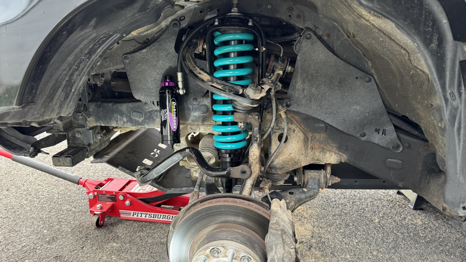

    Here is a pic of mine was able to get a sec to go down to the garage lol

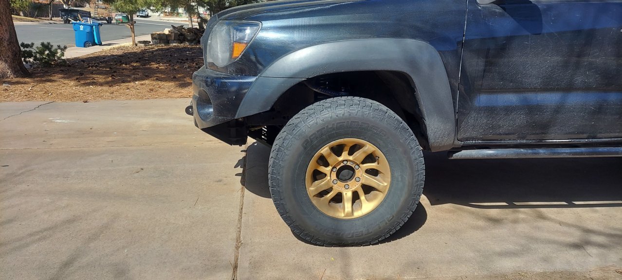

    Not the best picture, but I minimally trimmed mine and then used a heat gun to bend it up and zip tied it.

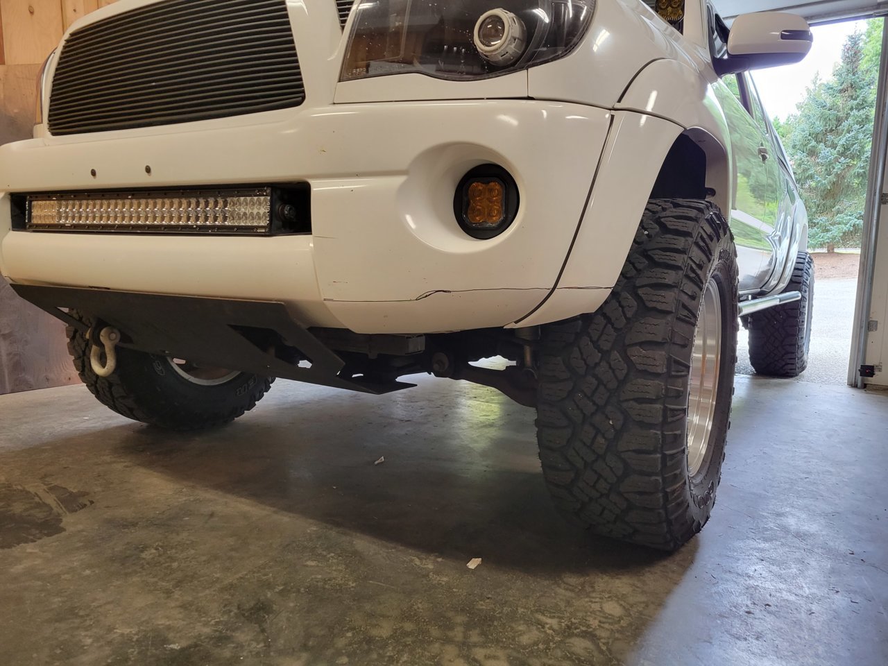

    I cut into my OEM flares.

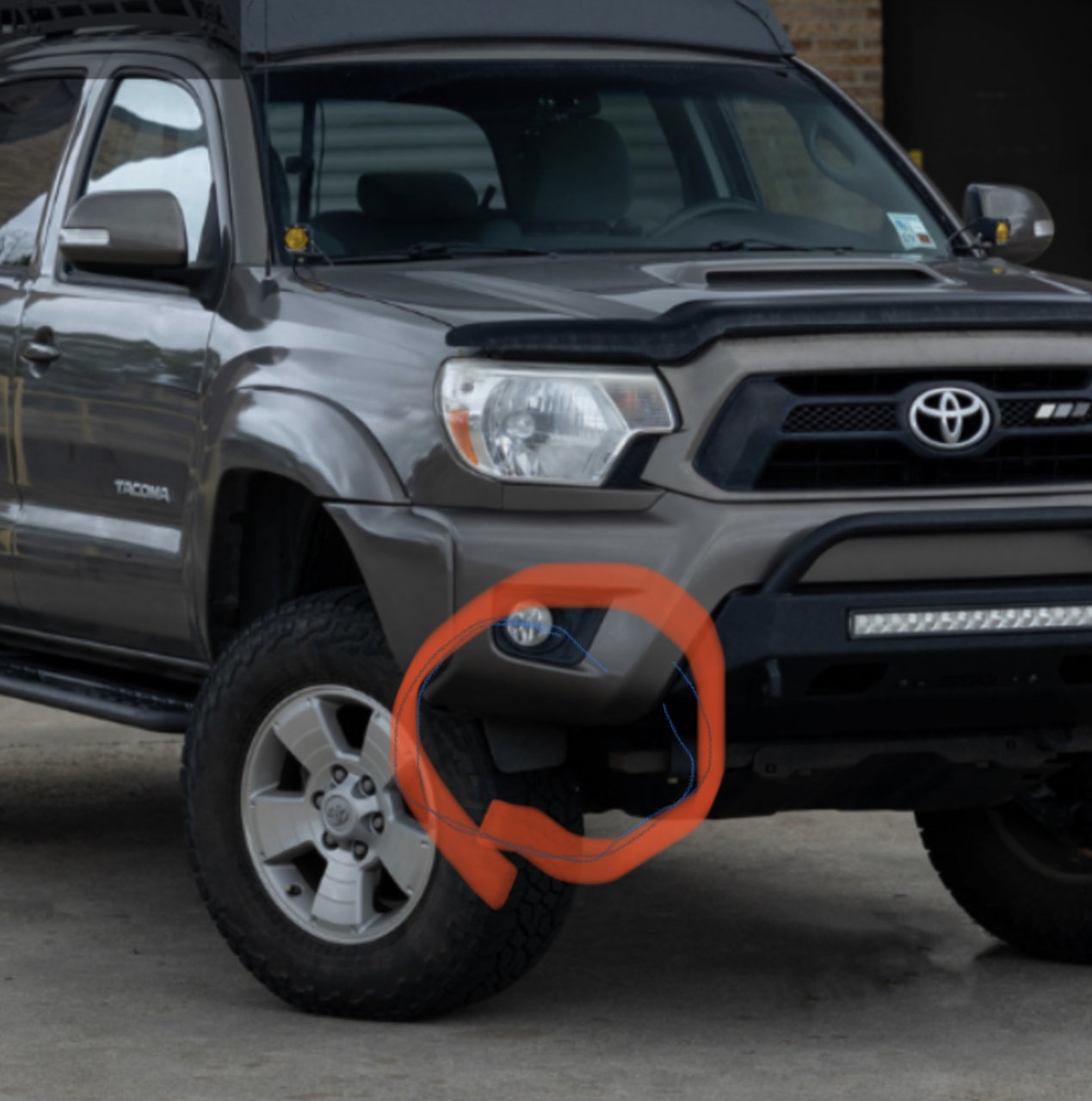

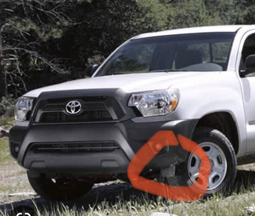

    EDIT: I messed up my reply. but I think the 2.5gen can pull off the viper cut better than the plain 2nd gen. Since you can follow the straight line under the fog lights.

    Yes that’s what I believe as well. I’m on straight 2nd gen and think that it won’t look as nice
