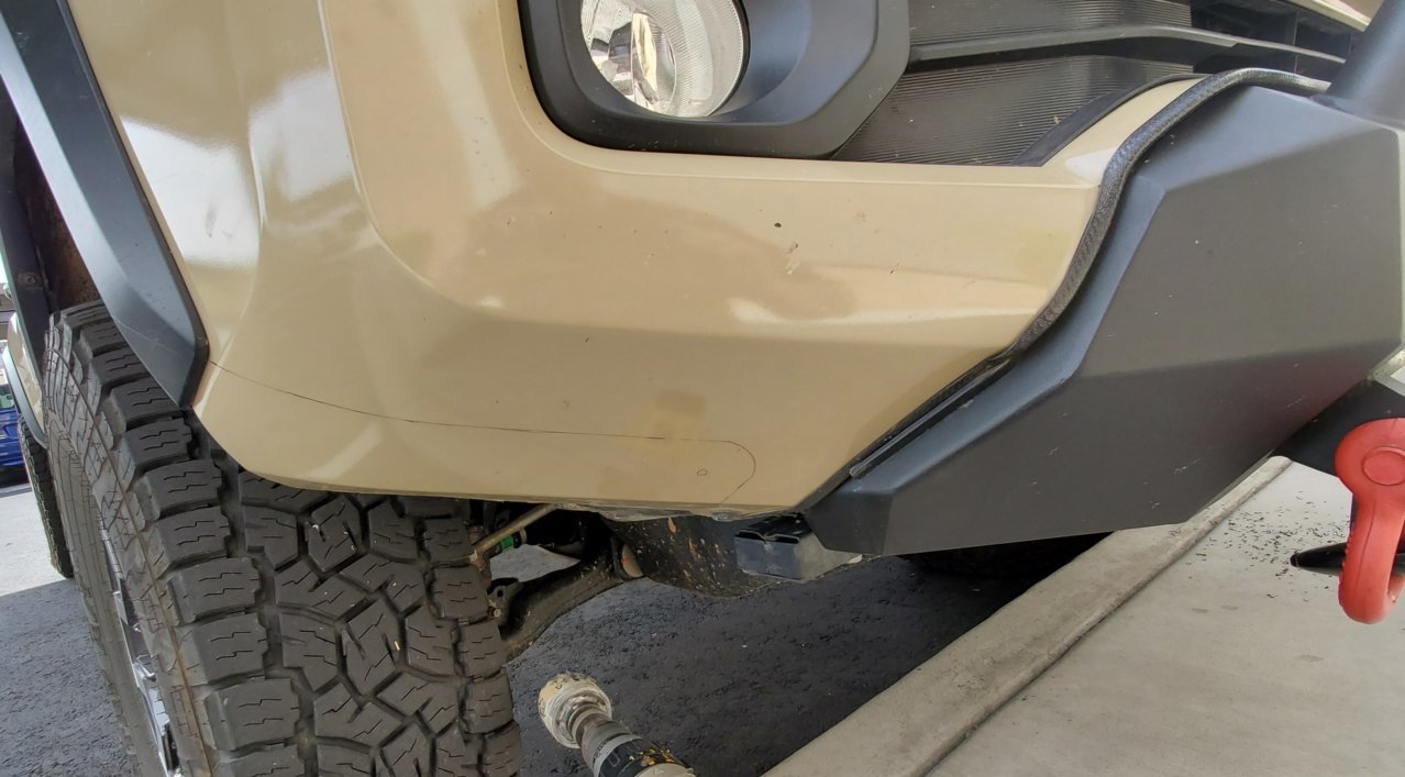

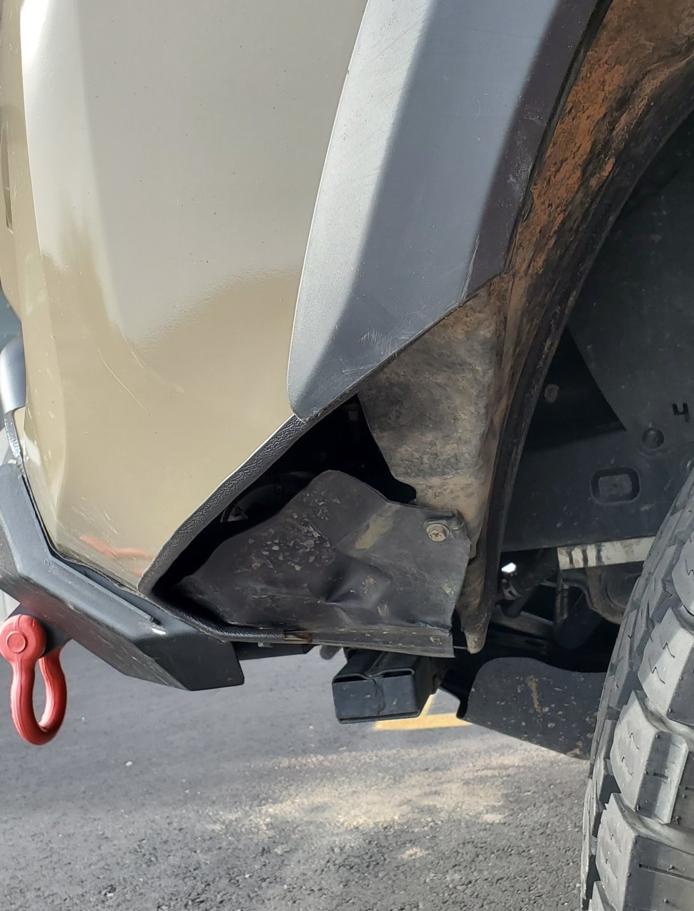

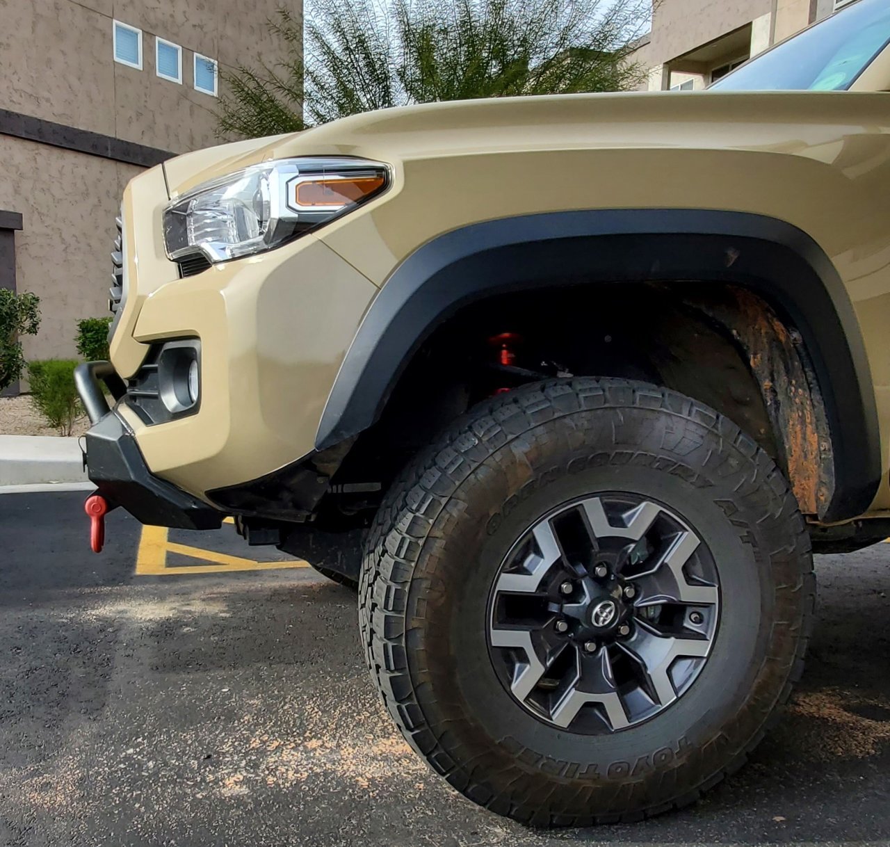

    Did my "viper cut" today:thumbsup:
    Wasn't too bad, the worst part was figuring out what to do with the remnants of the inner fender well/liner. So, I cut it, folded it, formed in place with a heat gun and the ultimately, bolted to itself with the OEM body clip/fastener that I removed in the trimming process. That said, I did a very "subdued" viper cut only taking a few inches off and resulting in an upward sweep on the side that's not so exaggerated. You can see by my pre-cut marks how much I took off. :cheers:

    Yep, all done. See Post #3 above. I'm with you on the inner fender liner, don't want to throw rocks through the backs of my fog lights. I was able to trim, fold, and re-attach the inner reasonably well using a heat gun. :thumbsup:
