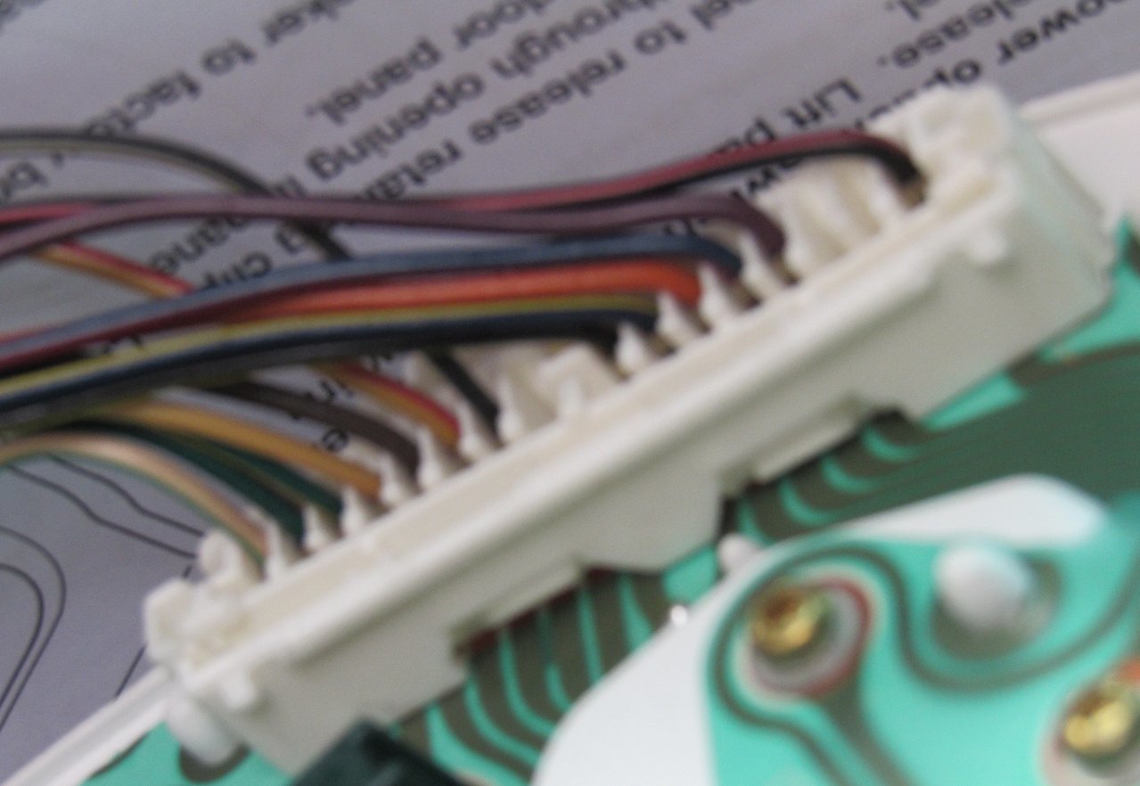

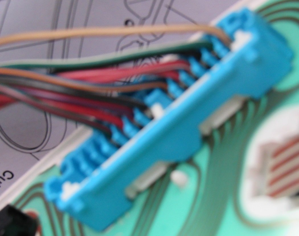

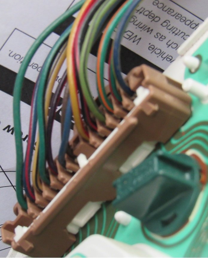

    The previous owner had a Viper installed but didn't hookup the wire to the tachometer. As a result, it often doesn't start on the 1st attempt. I've pulled the dash apart and am ready to attach the wire, but I'm not 100% sure which one to hook to.
    I'm looking for help from someone who has installed theirs or does it for living.
    The Viper is a model 410EV and the tach wire from it is purple with a white stripe.
    The tach wire into the back of the instrument cluster, I THINK, is a light-green with black(?) stripe wire.
    Here is the wiring diagram (for a 2003, mine is a 2001), and the 3 connectors to the back of the instrument cluster. White connects over the tach/temp gauge, blue connects in the center, an brown connects over the fuel gauge. The brown connect does have a light-green/black wire. However the wiring diagram only says "LG-B" - does the B mean black, brown, blue, ????. Does LG mean light-green, light-gray, ????.
    Which wire do I cut?

    In that case, the wire you should be looking for in the cluster is going to be Light Green with Black stripe located in the 13 pin brown connector. It should be pin #4.
