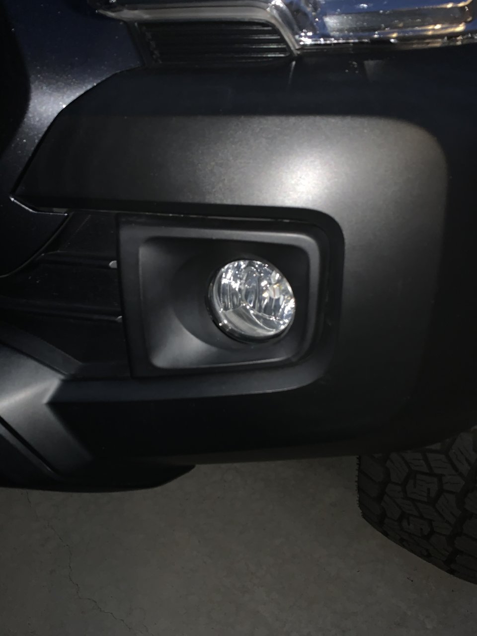

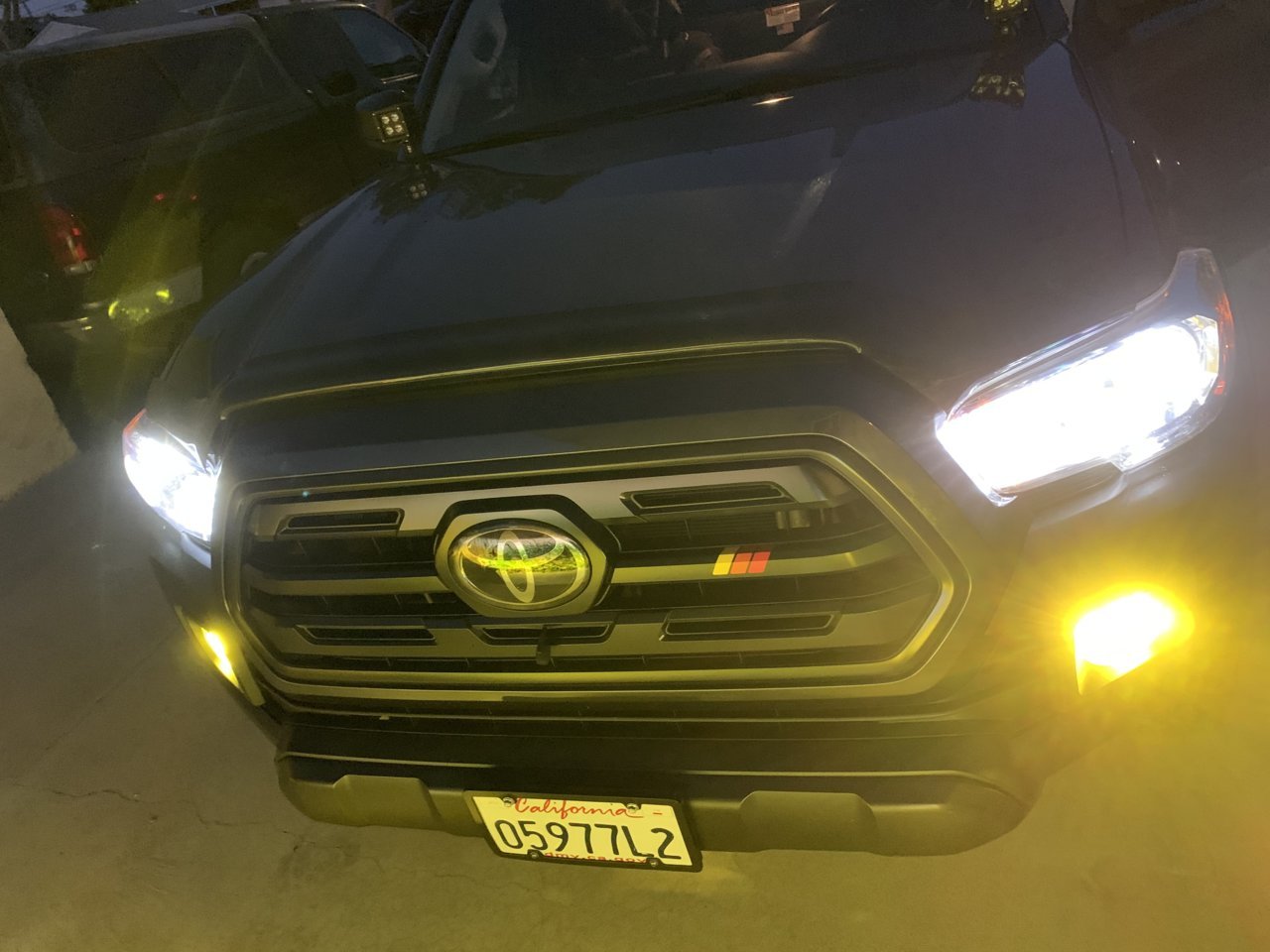

    I believe the fog light fuse is hot all the time so it’s not going to work for you. I bought an h11 wire harness with relay and fuse and did the wiring myself. I bought 2017 trd or fogs and bezels and added a circuit to the low beam fuse so the low beam and fogs turn on at the same time, but it’s easy to add a switch. I use lasfit h11 for low beam and lasfit h11 switchback for the fogs.ADE43F52-9533-4EF5-8DE1-AB8230429C8D.jpg91AE3D0E-7684-464D-A2A1-48EAD5900784.jpg

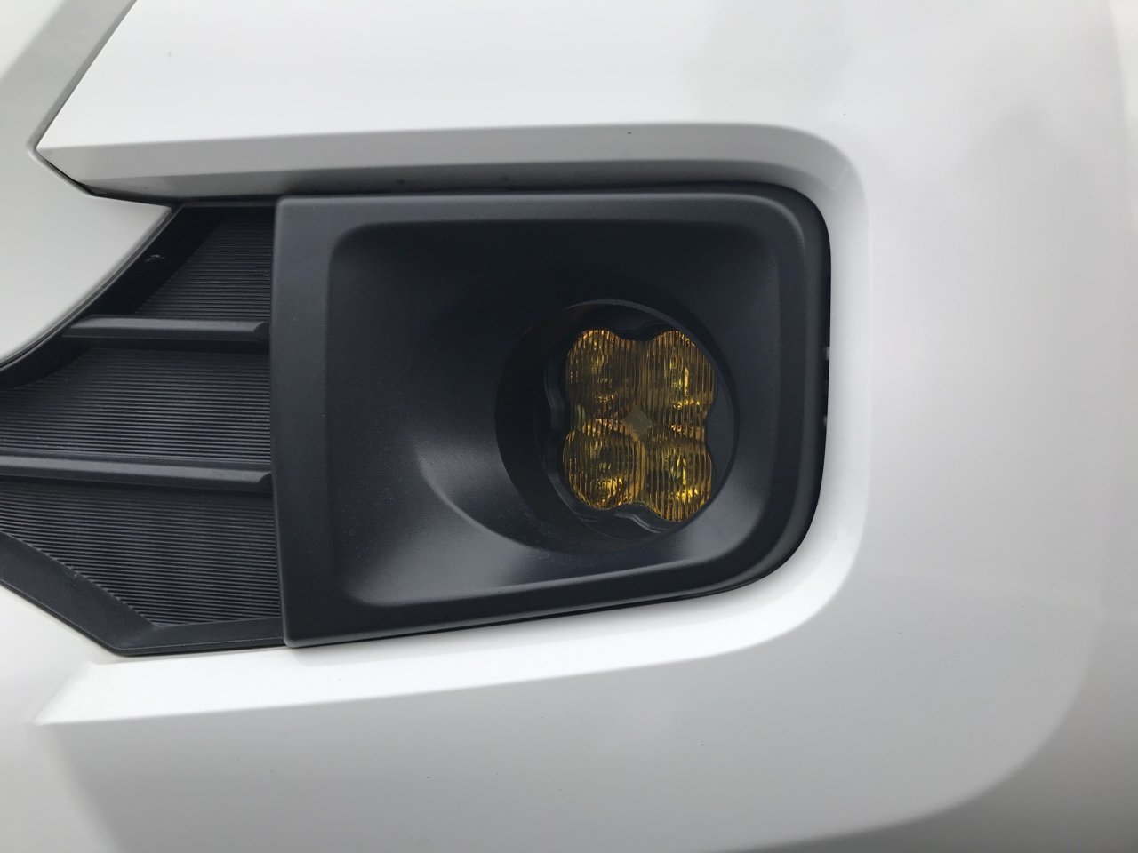

    Much easier to wire them like you would wire a lightbar for example. All you'll need is fog lights (I would recommend the Diode Dynamics SS3 Pro (thats what I'm running)), a wireharness for the fog lights (aftermarket might be the way to go), and a switch. Here is a link to the exact switch I could recommend purchasing if you go this route.
    https://caliraisedled.com/collectio...s/products/toyota-oem-style-fog-lights-switch
    don't forget the bezels, heres the part numbers: (52127-04020 (right) and 52128-04020 (left))
