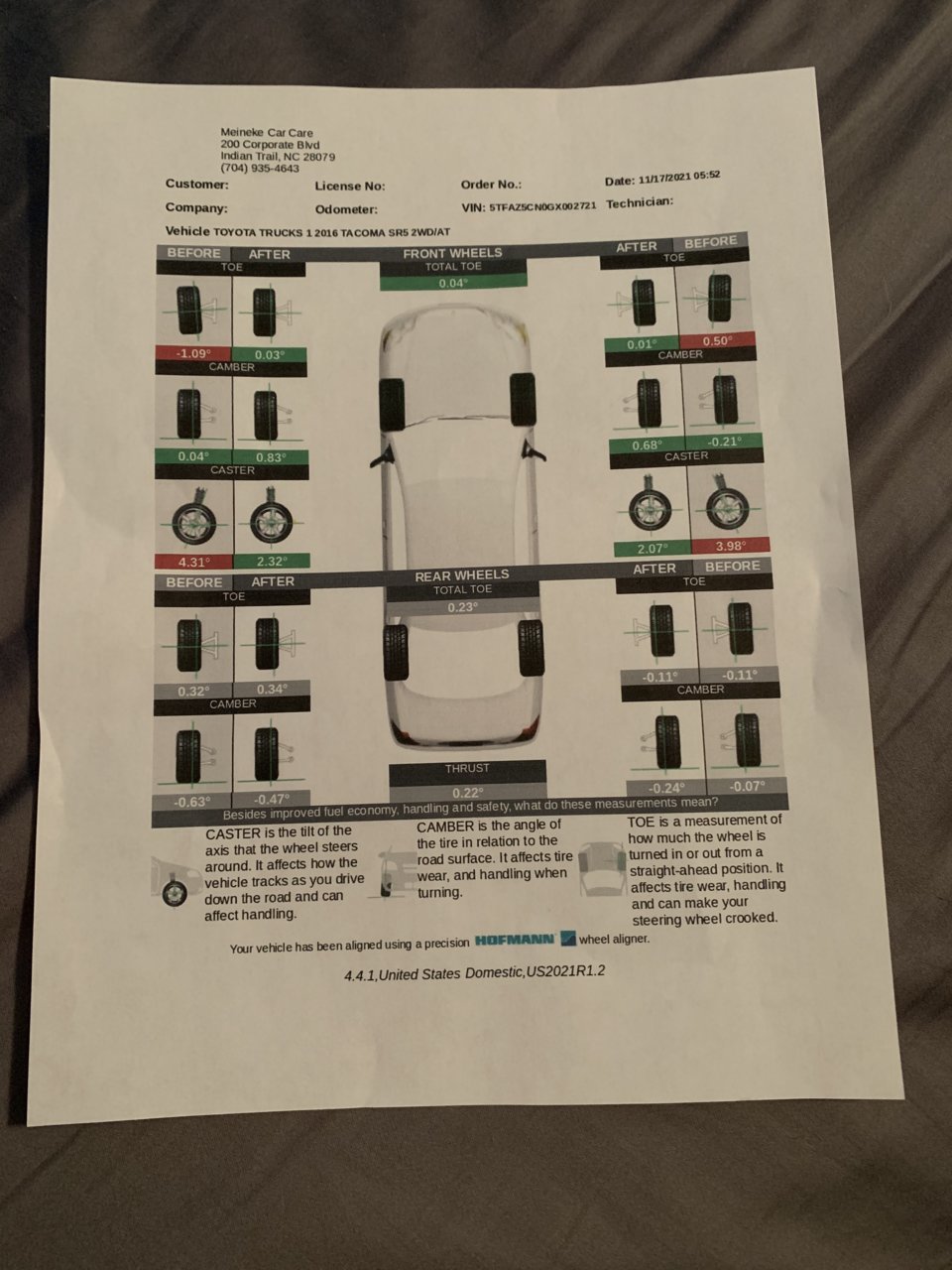

    I recently put a 3 inch spacer leveling kit in the front and 2-4 inch lift UCAs. I still have positive camber even after several alignments at multiple different places. I’m frustrated after spending hundreds on alignments. Any help?

    Post pics of your alignment cams and a copy of the most recent alignment spec sheet.

    Here is the printout. The reason why the numbers were so bad before is because I tried to align it myself and it didn’t work out. I then took it to an alignment shop and told them that my camber was visibly positive and they said they would fix it. Well, they didn’t.

    Normal, especially with spacer lifts. You have to sacrifice camber for caster.
    The lower cams can't compensate for the puck lift you put in.
    2 degrees of caster and just under 1 degree of camber is normal.
    If you want better you need after market control arms like SPC arms.
    Ideally you want 2.5++ caster and near 0 camber.
    Superdave1.0 likes this.

    you literally just needed a toe set and it probably would have been fine

    Just find a different alignment shop, your before measurements were almost perfect except for the extreme toe.

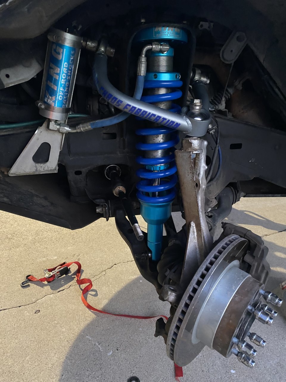

    anthony250f
    anthony250f Well-Known Member
    Feb 18, 2012
    #73066
    16,666
    Anthony
    San Diego, CA
    2008 dcsb trd offroad 4wd
    Or go TC HEIM uppers. I have a perfect alignment now3A0AA93E-470F-4C01-89AA-D666C3096BE9.jpg

    Service manual tolerance range for camber is -0.3 to +1.3 deg. There's also the requirement that LH and RH wheels should be within 0.5 deg of each other. Your numbers meet those requirements :notsure: http://www.ttguide.net/adjustment-1410.html Does the truck drive straight?
    Which part of the country are you in? Being 5 years old, at least one of the cam bolts may be seized, which will limit the number of things the mechanic can adjust.
