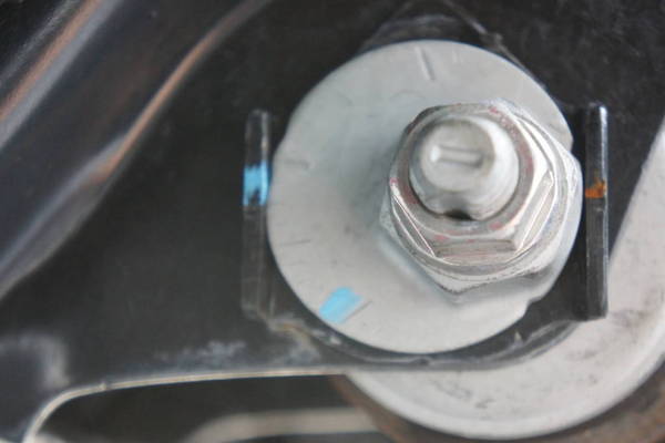

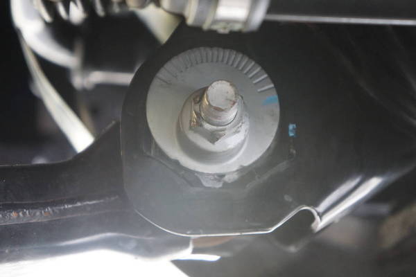

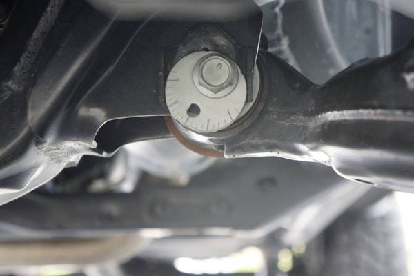

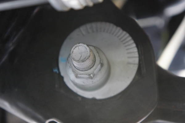

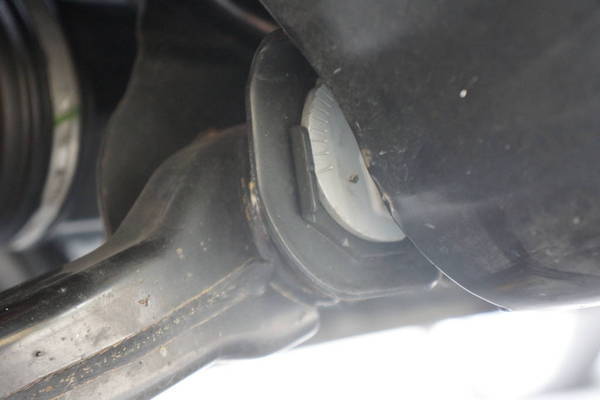

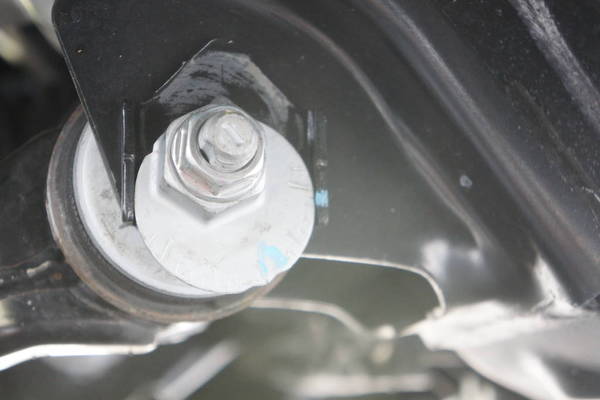

  8. Oct 31, 2013 at 9:06 AM
    mrad
    mrad [OP] Well-Known Member
    Jun 18, 2013
    #106570
    77
    michael
    2013 TRD sport 4x4
    camburg 2.5 coilovers camburg uniball upper uca wheelers add a leaf bilstein 5100 on rear
    Heres the left
  9. Oct 31, 2013 at 9:08 AM
    mrad
    Jun 18, 2013
    #106570
    77
    michael
    2013 TRD sport 4x4
    heres the right

    I would need to see the specs but those eccentrics are not maxed out negative camber, although two are. Because you will want them maxed out (if you are really that far off) caster will change. But caster is not a tire wear issue. My guess is that by maxing those out you will gain a little negative camber but also drop caster down to the point that the truck will wander. From experience, the only way you will get your specs within range after a 3 in lift is with adjustable uca's. I'm at 1" lift and I barely got the specs in stock range, with lower caster than I'd prefer. Go get yourself an uca with camber adjust or spindle and get er done right.
