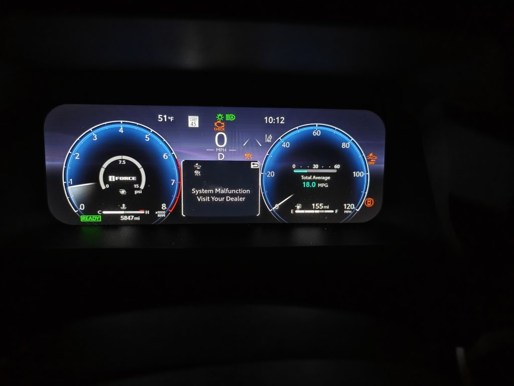

    I was messing around with radio and ignition on, I managed to drain the battery to the point I needed a jump start. After the jump start, the dash says visit dealership and flashes with these messages.
    System Malfunction visit dealership
    Check Engine visit your dealership
    Drive Start Control Malfunction visit your dealership IMG20250309231227.jpg IMG20250309231221.jpg

    Allow your 12V to get charged and then see if the codes dont clear. Go for a 30 min drive or something.

    Too late now, but I will in the morning.

    Update: after a couple of drive cycles, it cleared up. Scared me to be honest with you as the battery drained once before also but I didn't have the error codes
