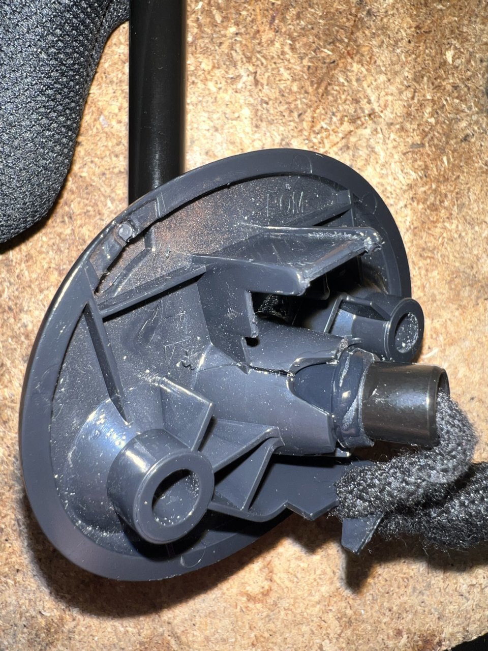

    I probably shouldn't be posting this on Christmas eve, but here goes. If no knowledgeable replies I will bump it later.
    Looking to remove and service my driver's side visor. It is making squeaky noises over bumps. Squeeks go away if I put the other end into the clip, but I move it around constantly, especially this time of the year with the low sun.
    I've removed the two screws holding it in place and it turns out it is held in place with more than those two visible screws on the plate.
    Has anyone jumped into this problem before? Does the headliner have to be partially removed?

    I completely pulled my visors to remove the safety decals with an iron. Removed the screws, yanked them out of the roof and then unplugged the wiring harness for the vanity mirror lights. I seem to remember it taking a little force but not so much I was afraid something was going to snap. It’s like a metal clip or something that holds it up without screws.
    Definitely check for a video on removal before taking my advice, but I don’t recall doing anything special.

    Found short video:
    2016 Tacoma Sun Visor Replacement - YouTube
    There is a clip holding it in place.
    Christmas eve is not such a bad time after all to ask an esoteric question.
    One of the things I will be doing tomorrow.

    Thanks guys.
    Got it out and it is broken and that is why it is squeaking. Added a little lubricant to it and I’ll see if that helps with the noise.

    The lubrication worked well on the squeak. Now the visor swings from side to side with a good turn hitting my head; can't win!

    Hm thats funny thats where mine also cracked. I think it comes from there not being a stop on the inside for the plastic part that attaches into the header. The shaft is flared so over time pulling it down or putting stress on it causes the crack. Mine hits me in the face when making turns if the visor is out over the driver side window blocking the sun.
    Let me put my tinfoil hat on for a sec but I could see it technically being a problem and causing an accident in the right situation. Wonder if there is a way to report it to Toyota? I guess they don't care till it actually causes an accident though haha.
