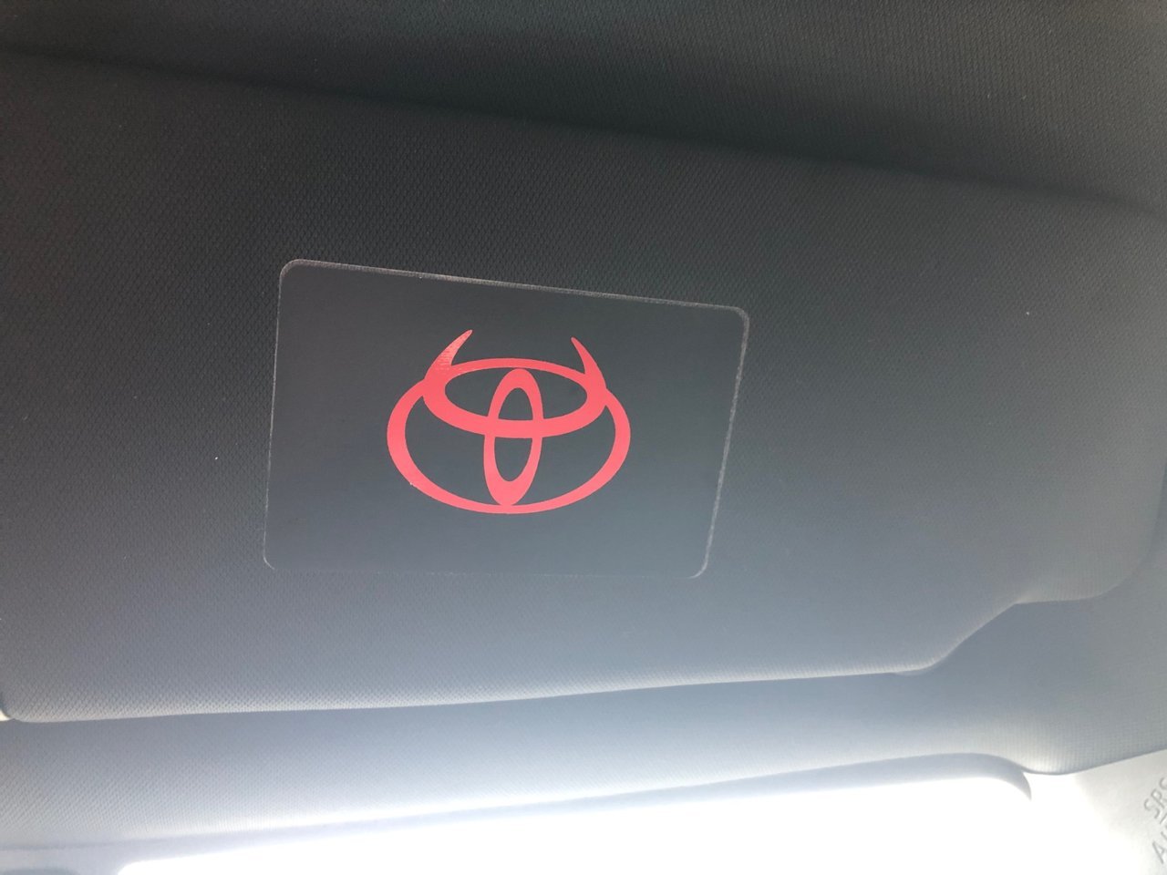

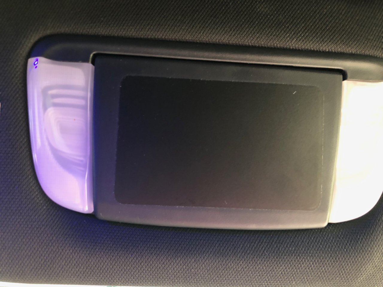

    Too bad they don’t work!! (Pics or it’s not true),

    I got some stickers...
    Pics look a little rough but for real looks good.

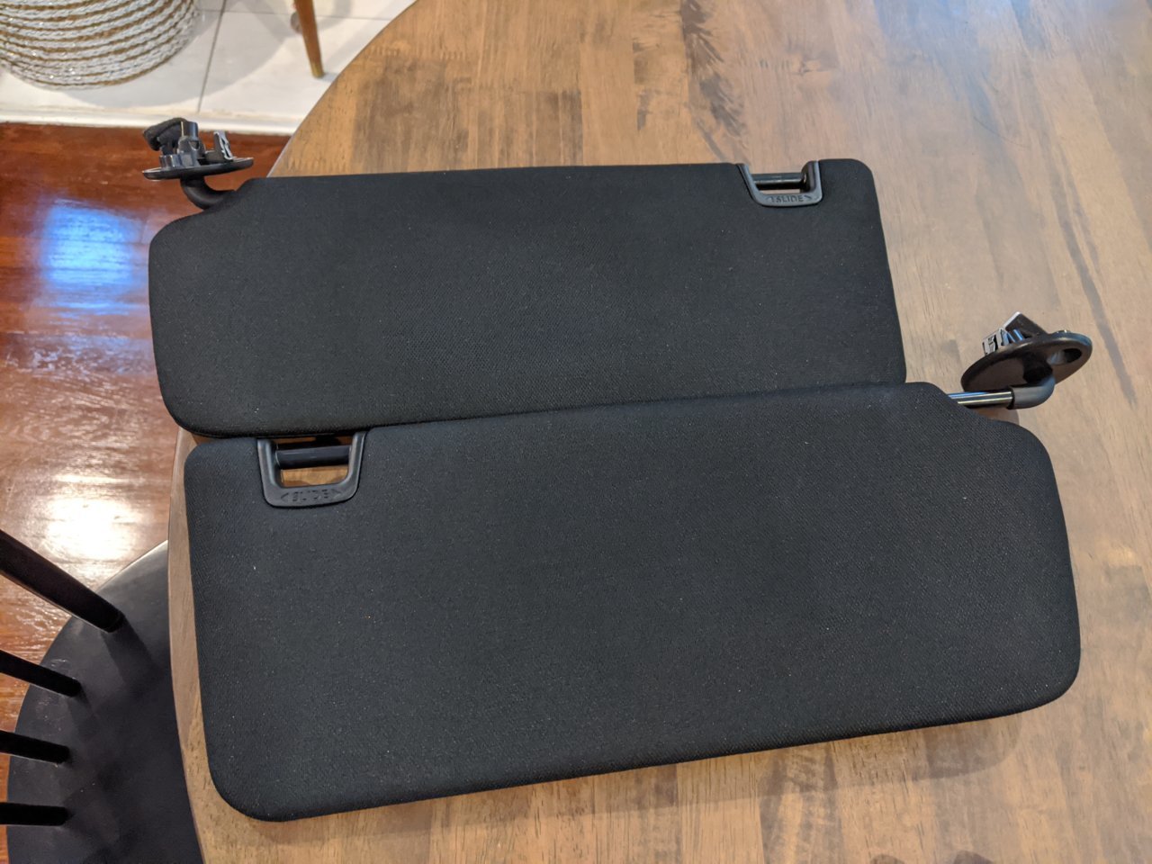

    So I just removed the stickers from the "showing" side of the visors.
    The two sides started differently... The drivers I peeled off just by picking at it. The passengers I used a hair dryer and peeled.
    Using the hair dryer to melt the adhesive, I dabbed with a paper towel as I melted the section. Then I scraped with a plastic ruler. After that used rubbing alcohol and wiped the area. Sprayed googone and let sit. Scrubbed with soap+light water. Heated/scraped/dabbed again.
    I basically did everything... And it turned out nicely! You really can't tell there was something there unless you examine. A new rider (or fiance who could care less what I do to mod the truck) would not notice any residue.

    And you get extra points for the MESO Custom photo bomb
