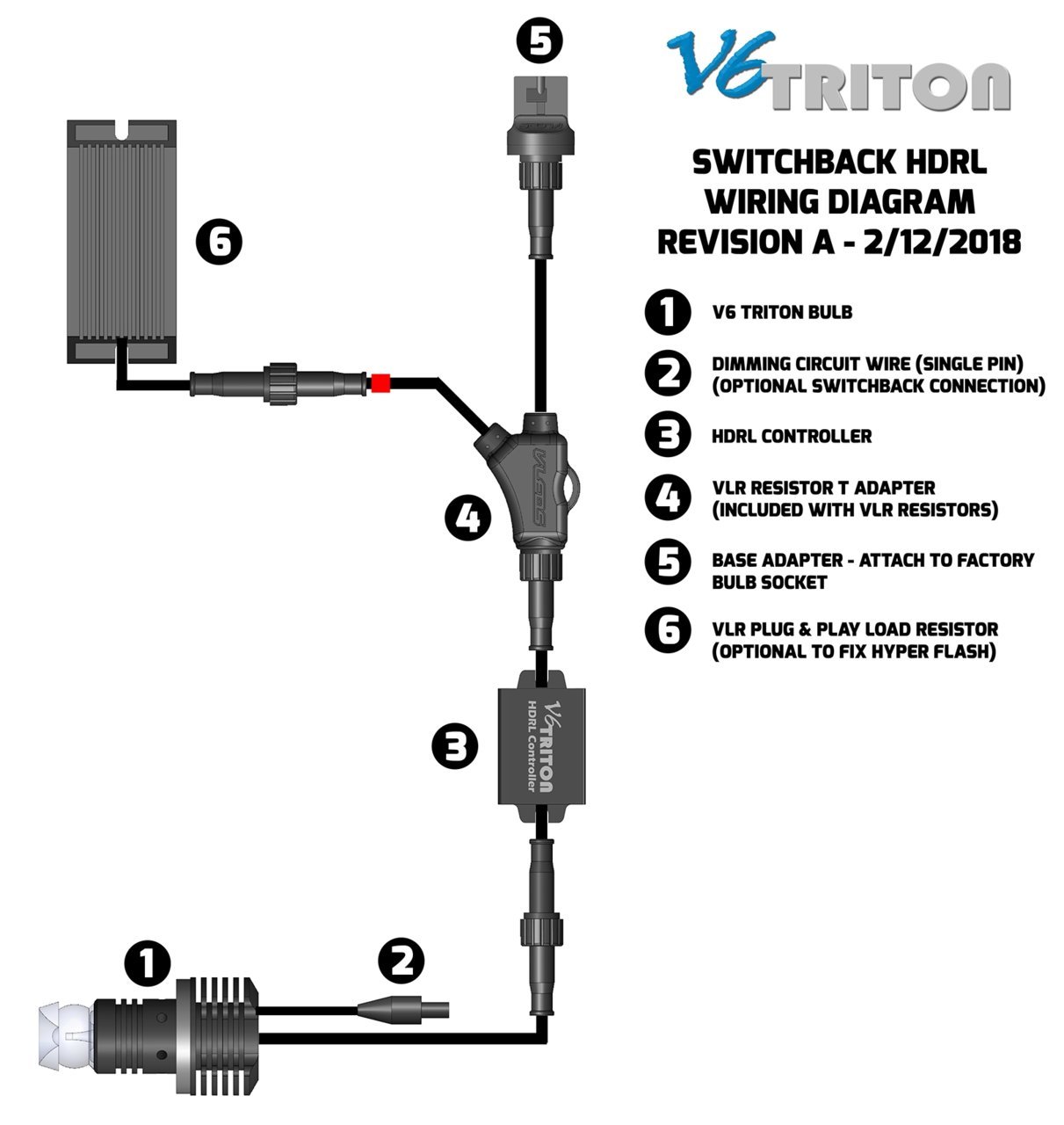

    I have a 2017 SR5 and I'm doing a BHLM and installing some Diode Dynamic Halo (switchbacks). Going to install it all on Wednesday. On the SR5, the DRL uses the turn signal bulb so it makes it a little difficult when wiring everything up for the switchbacks. I'm trying to avoid running wires to my tail light turn signals.
    Anyways... I'm also installing the VLED Triton V6 switchbacks as my DRL/Turn Signal. I'm assuming there's a way I can wire up my Diode Dynamic Halo switchbacks by taping into my VLED switchbacks and that's where I'm needing help.. Below, is the diagram for the VLEDs

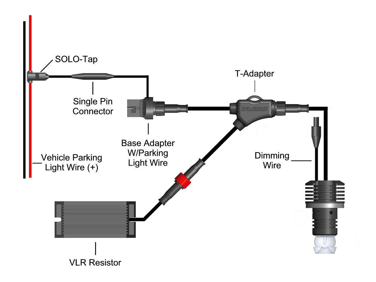

    Because my truck (and all SR5s) use the DRL as a turn signal, I had to buy a separate controller to help with the switchbacks... The separate controller diagram is shown below.
    Hoping someone can help me with identifying which wires to splice for my Halos to switchback when my DRL/Turn signal switchback.
    My goal is to have my DRL and Halos white with the DRL and turn amber when my blinker is on.

    @Mudrucker Damn man, I'm sorry. Been so busy, this one slipped my mind. Tell you what, to make up for it, I will make you some harnesses that do everything you need them to do. All plug and play, no splicing or anything. I will make them this Sunday, ship them out Monday. You just want the halo to mimic the switchback, right?
