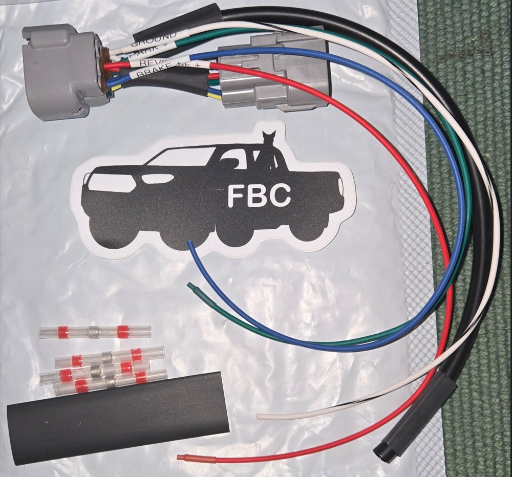

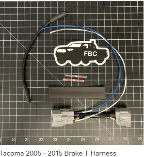

    So I was gifted a VLED LPX by @kmorgan3
    and remembered this in FBC (@daveeasa )
    So I asked for this:

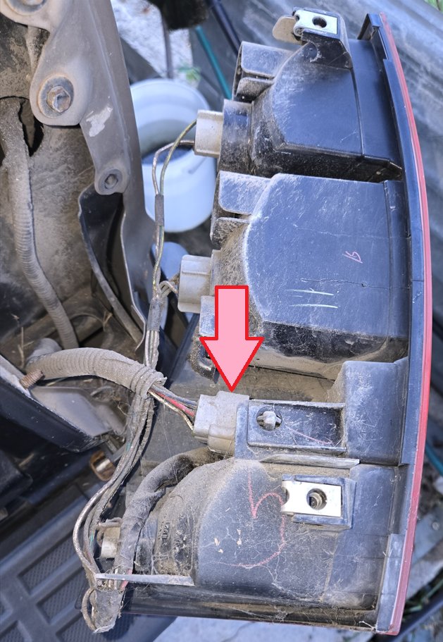

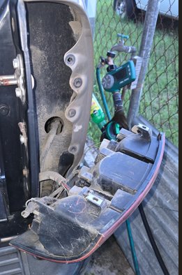

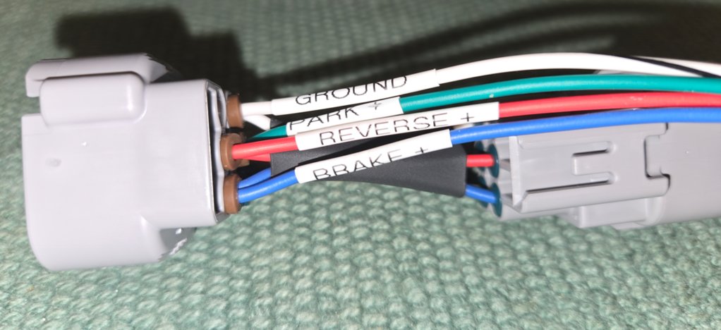

    The prior harness is for Back Up circuit and ground. This one above has Park-Brake and Back Up (Reverse).

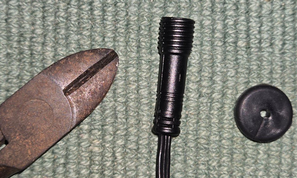

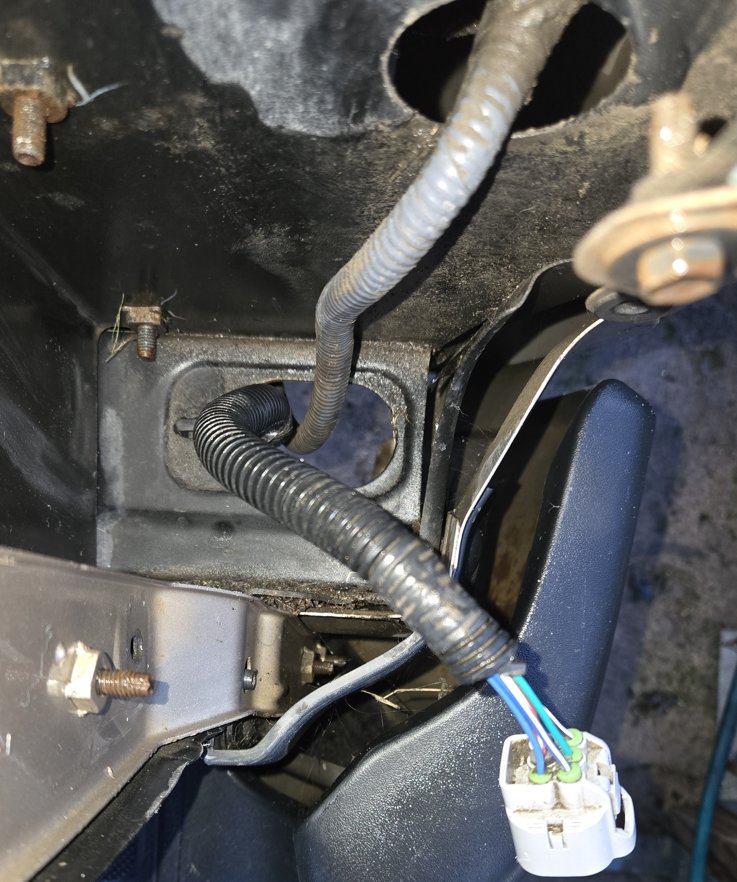

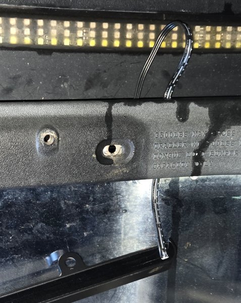

    I had to remove the wire "bushing" so it would fit behind the bumper top cover:

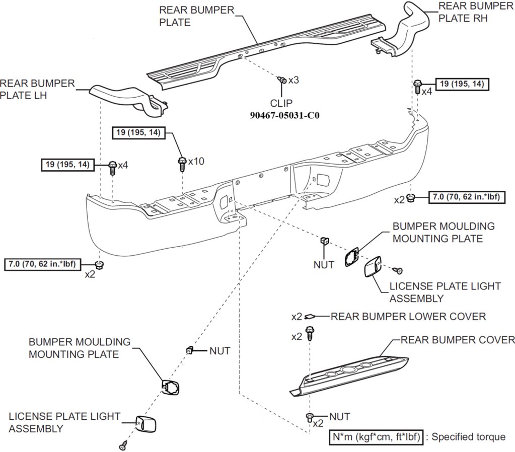

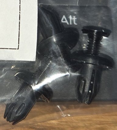

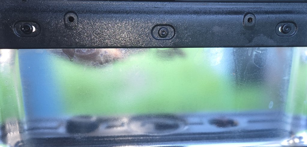

    Also had to remove (destroy) the plastic clips to make easy room to pass the cable.
    Clips locations, cable was routed under and behind cover.
    2nd Gen has no holes in bumper like 3rd Gen

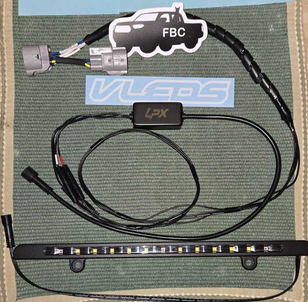

    Final assembly before install.

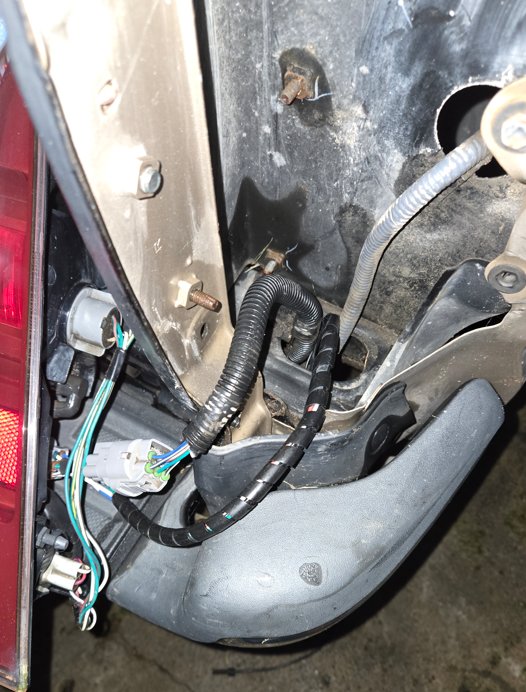

    upload_2024-9-16_23-51-1.pngupload_2024-9-16_23-52-13.pngupload_2024-9-16_23-52-44.png

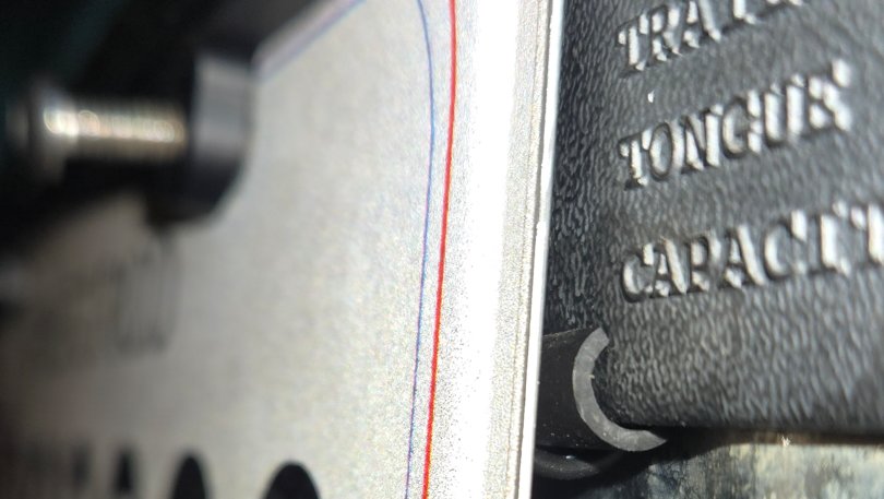

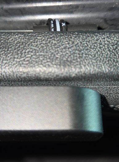

    Split hose for cable "cushion"
    Top edge with "cushion"
    Bottom edge with "cushion"
