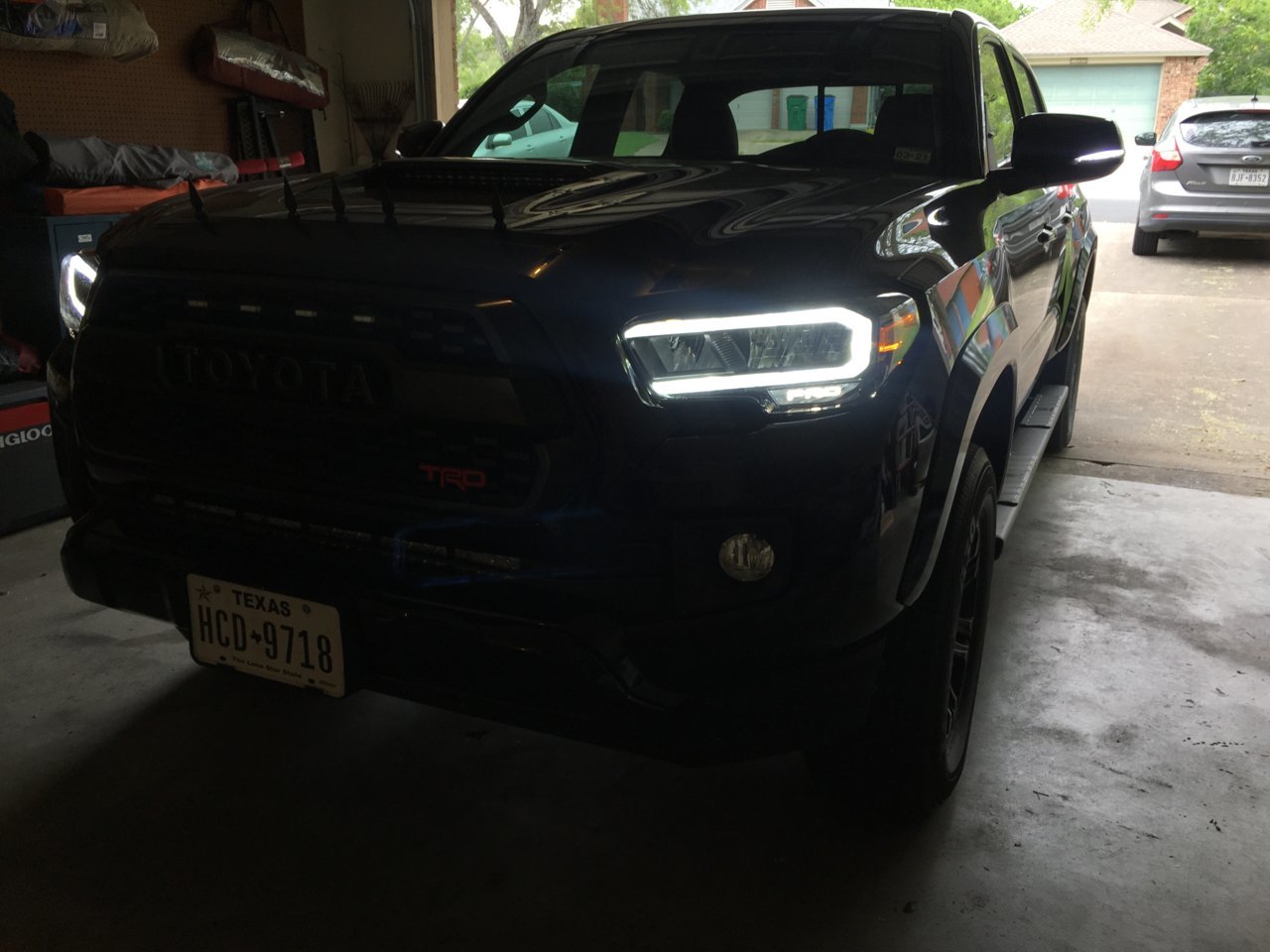

    Yeah I have Meso’s limited edition turns so I have white DRL already.
    Yeah the full size trucks option do look really nice. I’ve never been an amber fan but the past year or so has been growing on me

    The leds they are making these days seem so much better. Whenever I see the new F series I'm like oh yeah that's the future right there.
    Got any pics of the DRL s on the mirror ?

    they are pretty sweet and switchback to intense amber.

    Sick AF. I need those mirrors so bad lol.
    Also the new 2020 head lights you have with the LED side markers are nice! Good combo

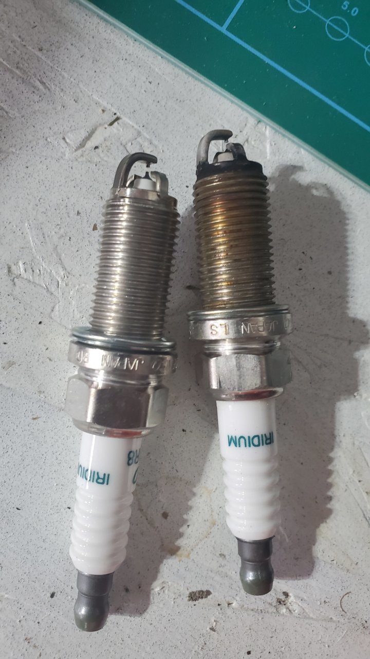

    On another note currently I am knuckles deep into drivers side plugs :frusty:. Long time coming 20201031_132409.jpg 20201031_131602.jpg

    OMG its like Taco Heaven when you get to passenger side. I started with the harder side first. So much space to work with. 90% of the work is all driver side.

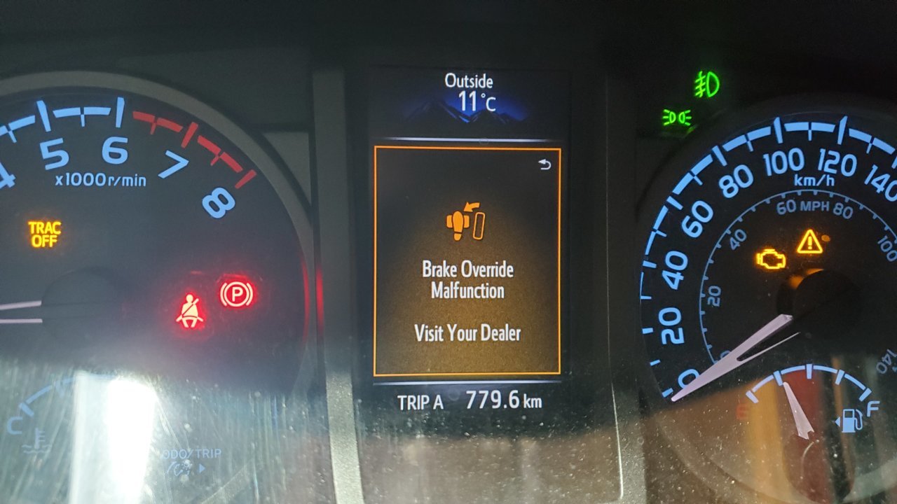

    Well- that's what I get for trying my own plug maintenance lol. Now it's time to take the trick or treaters out! Anyone else ever have this issue after plug change? At first I went back and re checked my work and found i forgot the small black connection on Edit: passenger side it showed Trac Off and check engine light.
    After I found it, i connected it and now I have brake override malfunction.

    So I got home from the tricking and treating. Had a few minutes to look up the Brake Overide Malfunction. Did a quick check on fuses and tail lights all seem to be OK. So I hooked up the scanner to see what it would tell me. Throttle actuator control system - stuck open. And I believe camshaft position sensor "b" circuit high. Using OBD Fusion App on Android. See below.
    While doing the spark plugs I had the intake hose off and I wiped out the throttle body with a rag and manually opened/closed the valve.... I wonder if that fudged something up? Would cause the fault to the throttle actuator system...
    Anyone shed some light ! ??:facepalm::help:

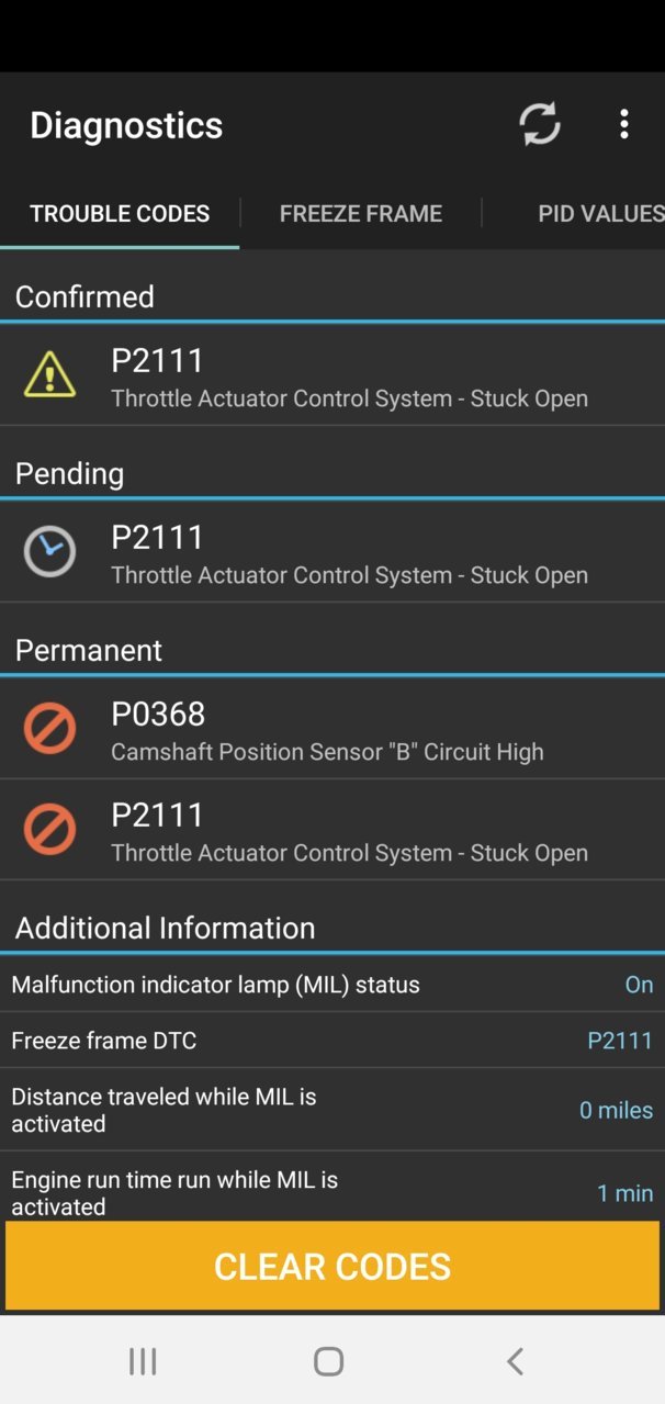

    Ill update this because others have seen Brake Malfunction limp mode. I scanned codes as mentioned and found P2111. Which led to the triggering of the Brake Override Malfunction.

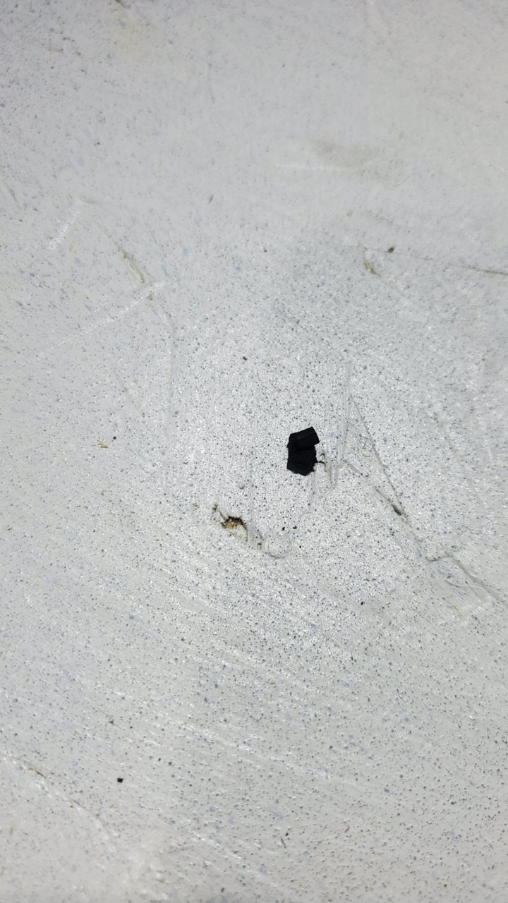

    After checking out the code P2111 "throttle actuator stuck open". I found that a very small piece of the rubber intake hose had broken off while reinstalling it after changing my spark plugs and was jammed right in the throttle body. 20201101_095705.jpg
    Little gremlin! ^ :fistbump:
    The brake override malfunction was cleared immediately after clearing this out.
    After some reading on here and the net I found that the PCM has several paths to triggering the brake override malfunction for the drivers safety. Although most of the time on TW it seems it's related to brake fuses, keep in mind it should be diagnosed thoroughly. Take your time!
    https://www.troublecodes.net/p2codes/p2111/?amp
