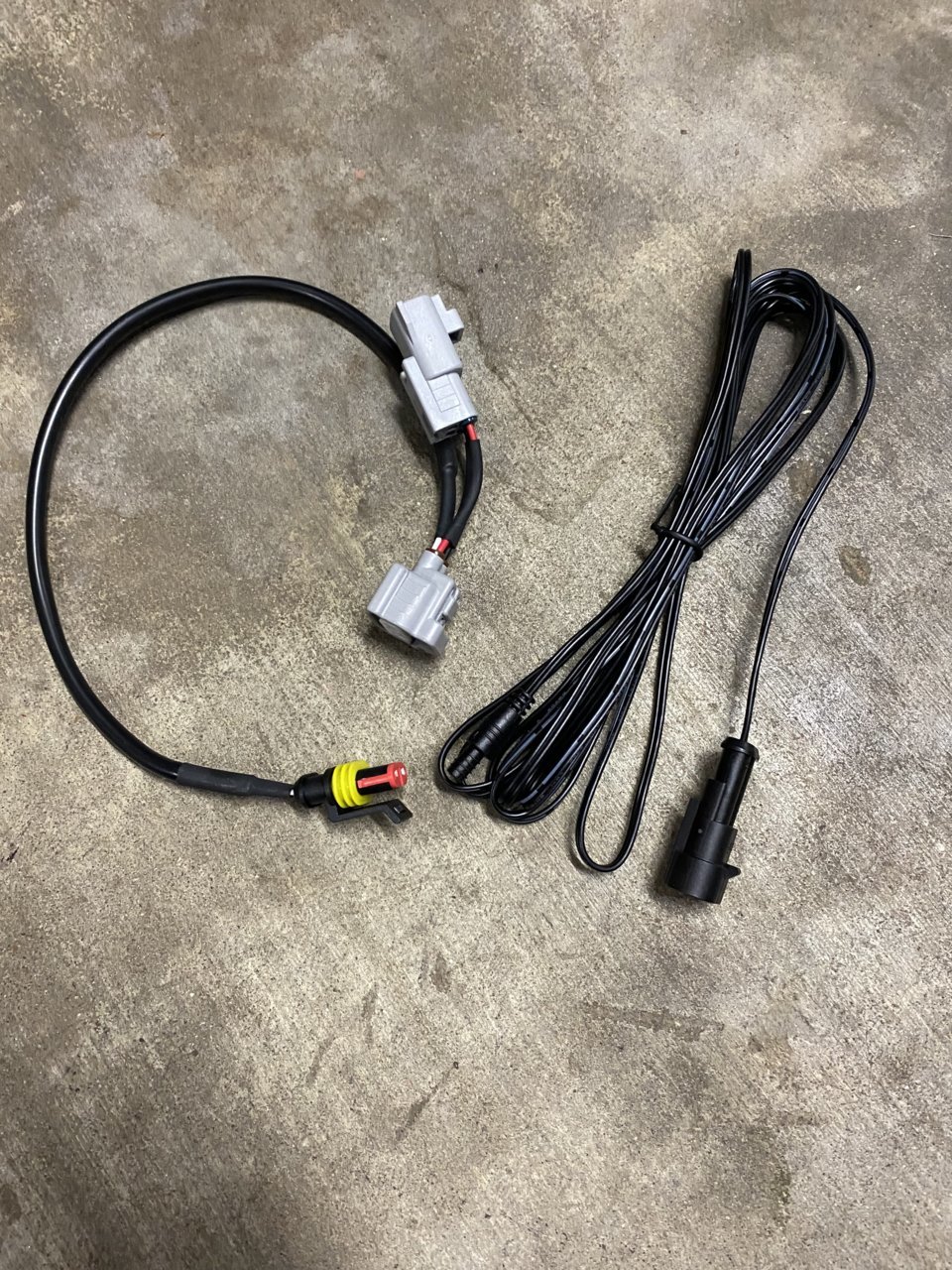

    I run the LPB brake on the Tacoma and the LPR reverse on the tundra. Both using a pigtail harness made by members here so I didn’t have to use the duo tap that splices factory wiring

    I am definitely going to order that wire harness for my 3rd brake light on my Bestop. This truck is too expensive to start hacking into the wiring harness

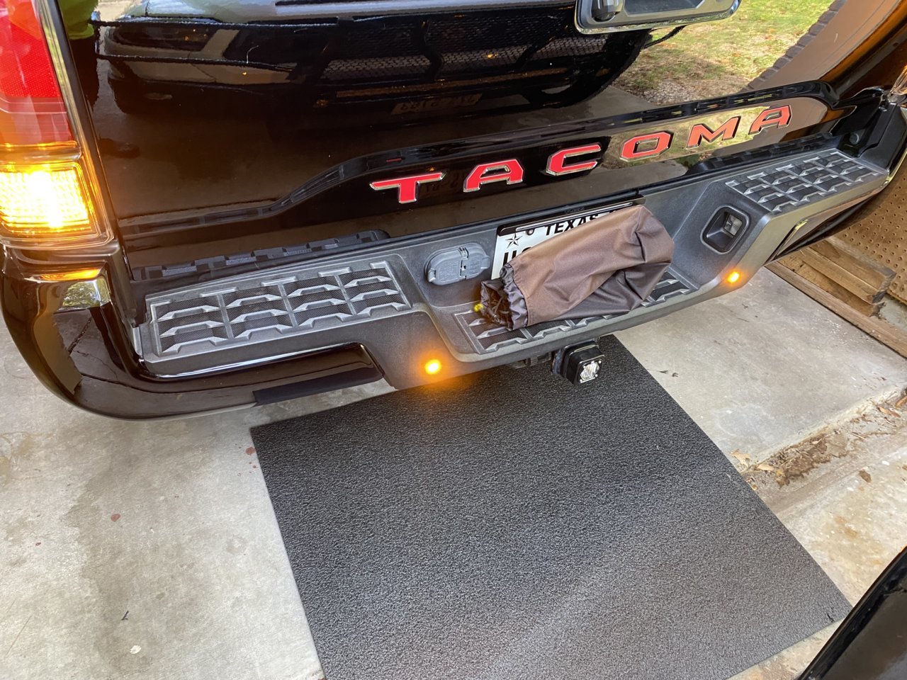

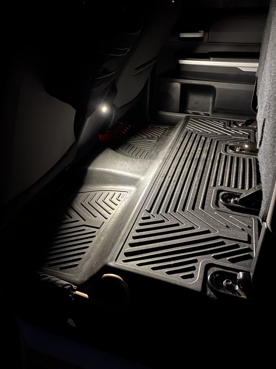

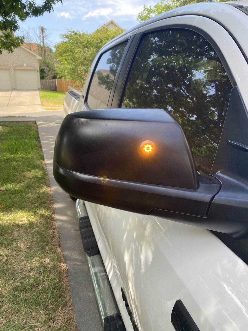

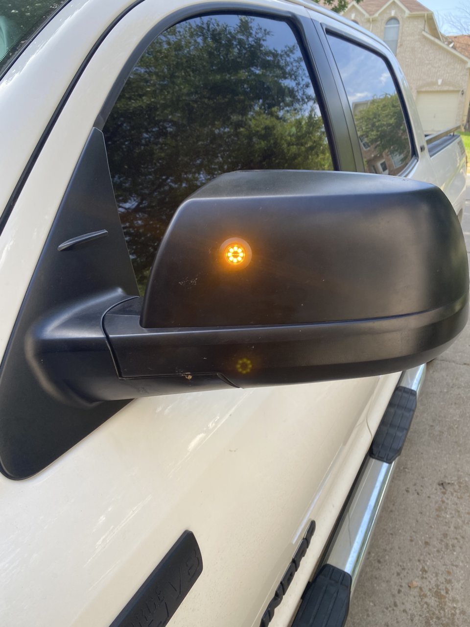

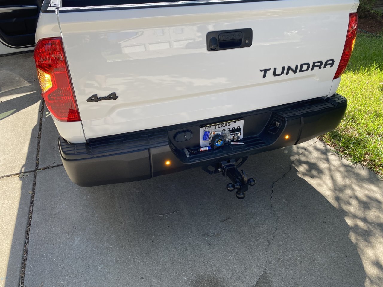

    Update.
    Aux turns and taco and tundra with some front facing turns and interior footwell light. Have a few ideas for more but in no hurry

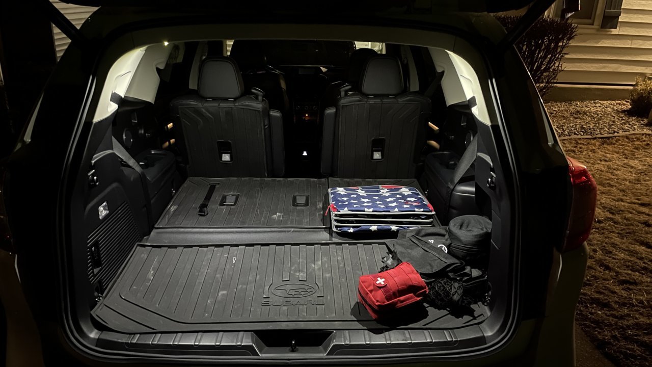

  15. Aug 1, 2023 at 12:59 PM
    #55
    TacoFergie
    TacoFergie Well-Known Member
    Dec 21, 2015
    #172832
    1,304
    Iowa
    Have you guys looked at Oznium's bolt lights? I have a set of the White/Amber switchbacks but haven't found what vehicle to install them on. They also have a Red/Amber switchback as well. Oznium has been around for well over 10yrs and was very popular when I was in the Scion scene back in 2008-2010 time frame. I've used plenty of their stuff with great reliability.
    https://www.oznium.com/led-headlights/bi-color-led-bolt
    I used 2 11mm Neutral White NO Lens option for our Subaru Ascent cargo area. The picture is ONLY the 2 Oznium Bolt LED's. It's a perfect amount of light IMO since it's not so intense that it's blinding, but enough to do most everything without much shadowing. The "No Lens" option is sealed with epoxy and gives a wide spread beam pattern. The "lens" option has a 60 degree pattern.
    https://www.oznium.com/led-bolts-prewired-leds/led-bolt

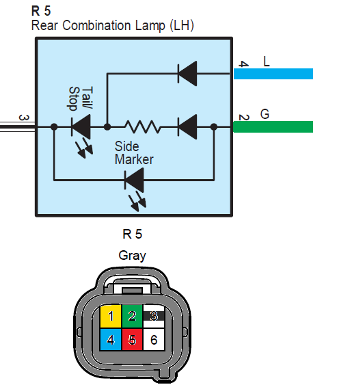

  19. Apr 11, 2024 at 10:28 PM
    #59
    TacoTuesday1
    TacoTuesday1 Well-Known Member
    Jun 19, 2019
    #296781
    7,795
    SD CA

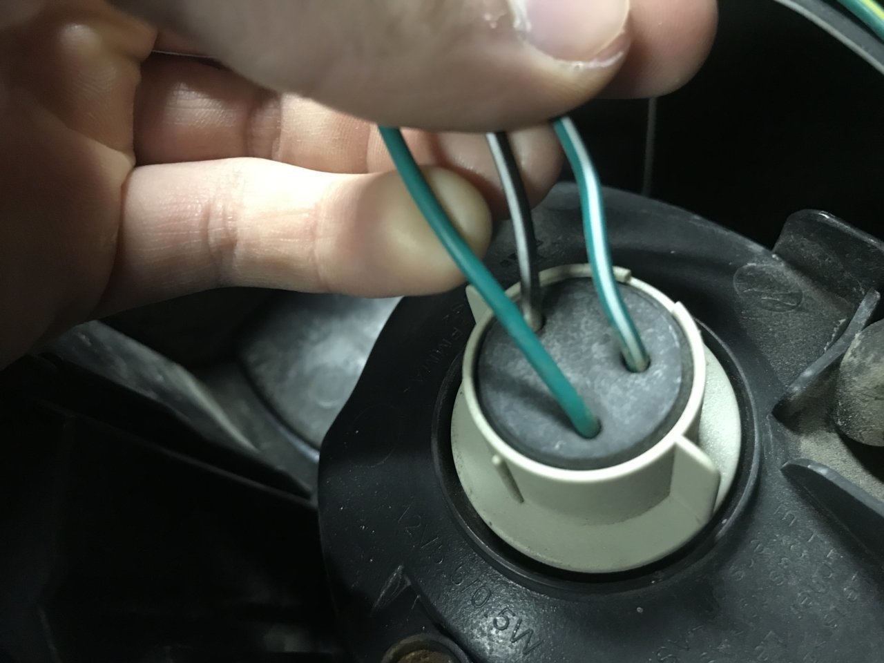

    got the fronts done
    same thing just 2nd gen. Looks better.
    tap was easy. Headlight side marker has two wires.
    -striped color power purple
    -black ground
    need to figure out rear tap next going to be harder.
    The tail lights are LED so the brake socket has 3 wires. I assume 2 power 1 ground.
    1 power for the pedal brake.
    1 power for running red with lights on.
    as the center LED circle is responsible for both.
    Going to be a challenge to determine which of the power wires is for running that I need, and not pedal brake.
    It doesn’t really disassemble and that might not reveal what is what. Might be time to search for wiring diagram.
    that or poke it with a needle to see what is what. Then seal back up the wrong wire with a dab of liquid electrical tape that I don’t think I have…
    I’ll see if I can find room and any bare exposed metal to stick a probe and find. Rather do that than dig through a 400 page book that might not even be accurate.
    don’t know if 3rd gen tails are that same way too.
    That is assuming I should tap at basically close to that part of the tail.
