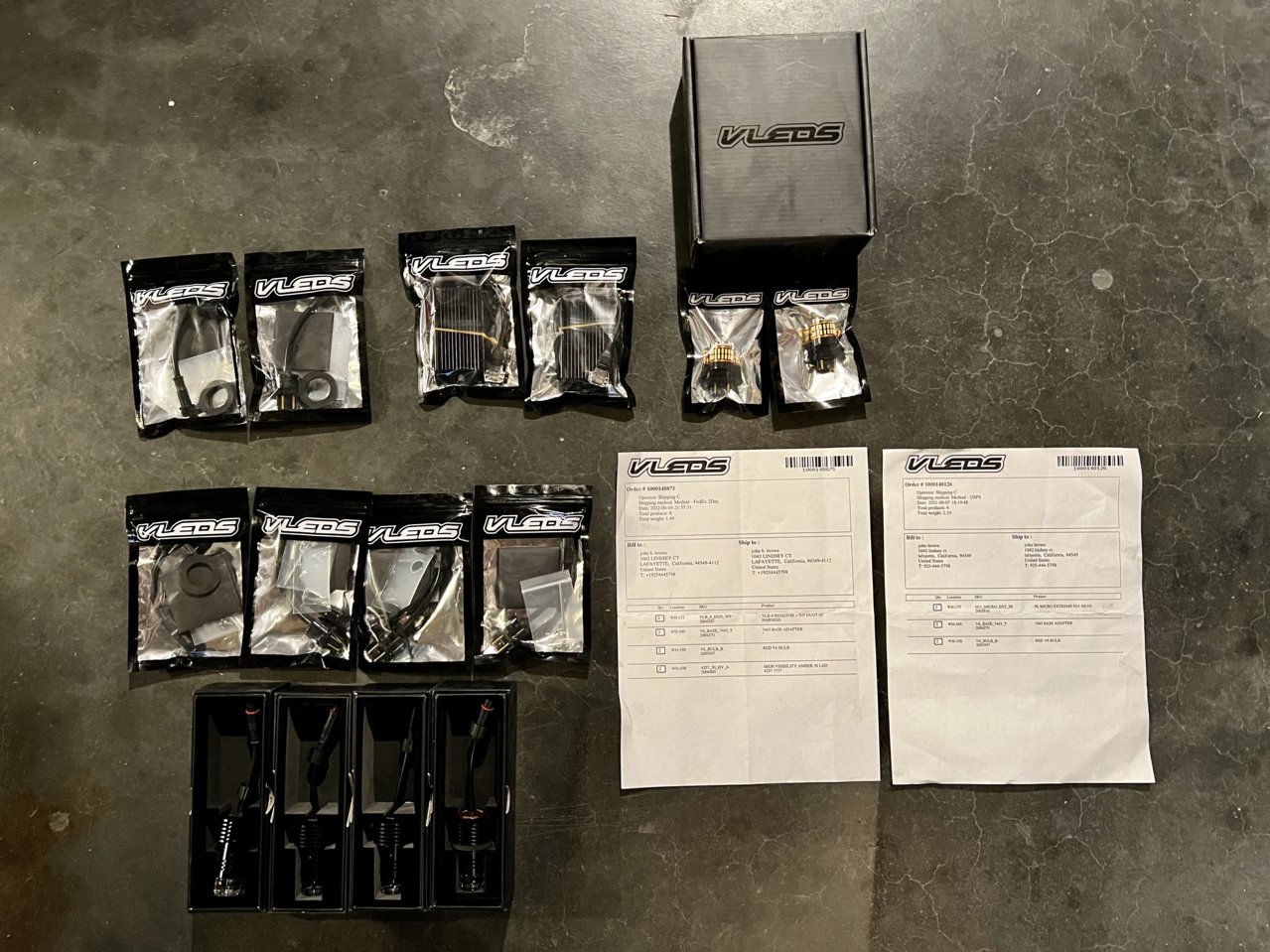

    Hey guys-
    Hoping someone out here has some experience with installing VLED lights.

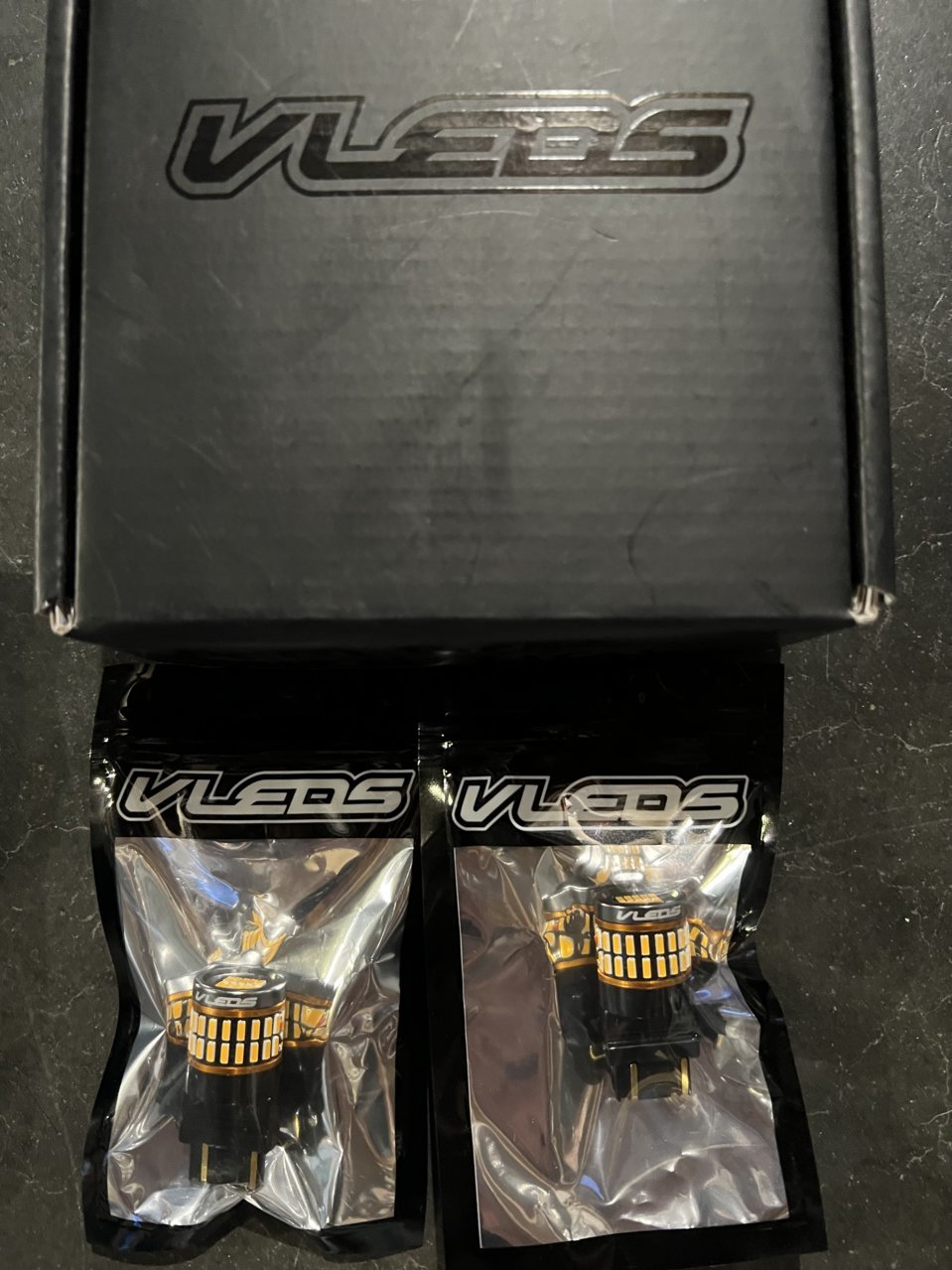

    I have purchased VLED amber front turn signals, the resistors/adapters for them but see no way to install these on my truck. This isn’t my strong skill, messing with lights and electrical, so any help would be appreciated.
    On a seperate issue, i also purchased VLED triton v6 red tail lights to upgrade my Meso total tail stage 1 kit. Same issue as with the amber turn lights….don’t see how these install. No videos out there or reference guides on vled site either.

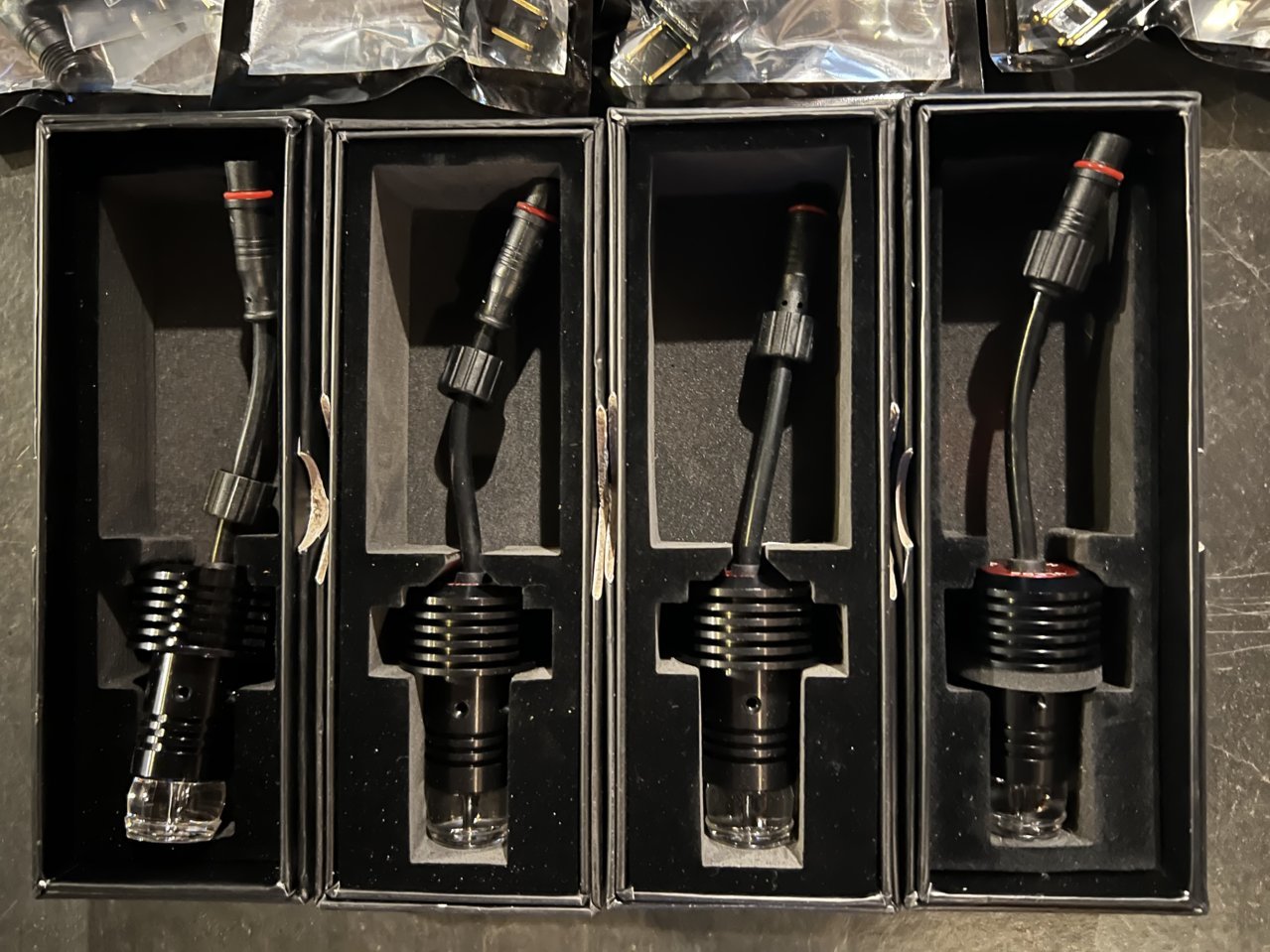

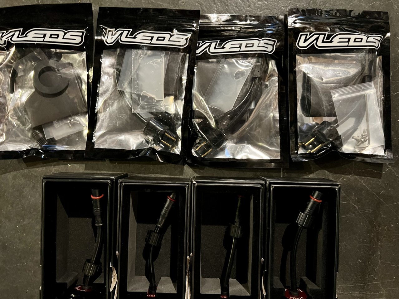

    Here’s what i have:
    392A3A0C-07CB-4BB4-94FC-4F772A5B1B43.jpg 2115EECA-2ED8-45E6-9803-E2B753B9ABBA.jpg 3CE74847-8E2C-452D-B3DB-4F393ECEC5DD.jpg 1F54EDF5-9CA1-4B69-902F-00D37635C2F8.jpg 47B967BC-6621-4B0C-82AD-D34E20D41B11.jpg 1F2DC8CF-BC7A-481E-9A1B-EACF762AFB34.jpg B25248C1-9A03-4932-890E-DBEC5BB06BD5.jpg

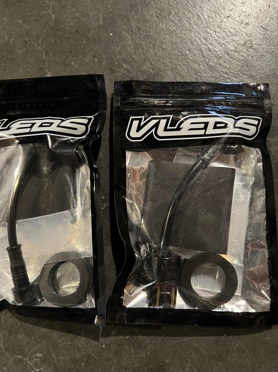

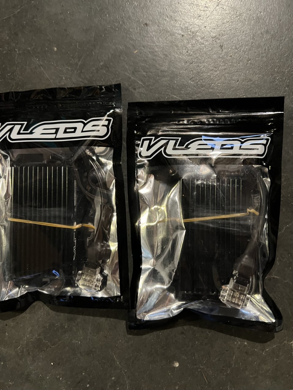

    There should be a y connector one goes to the light the other goes to the resistor, and the other goes to the truck. They can only fit one way

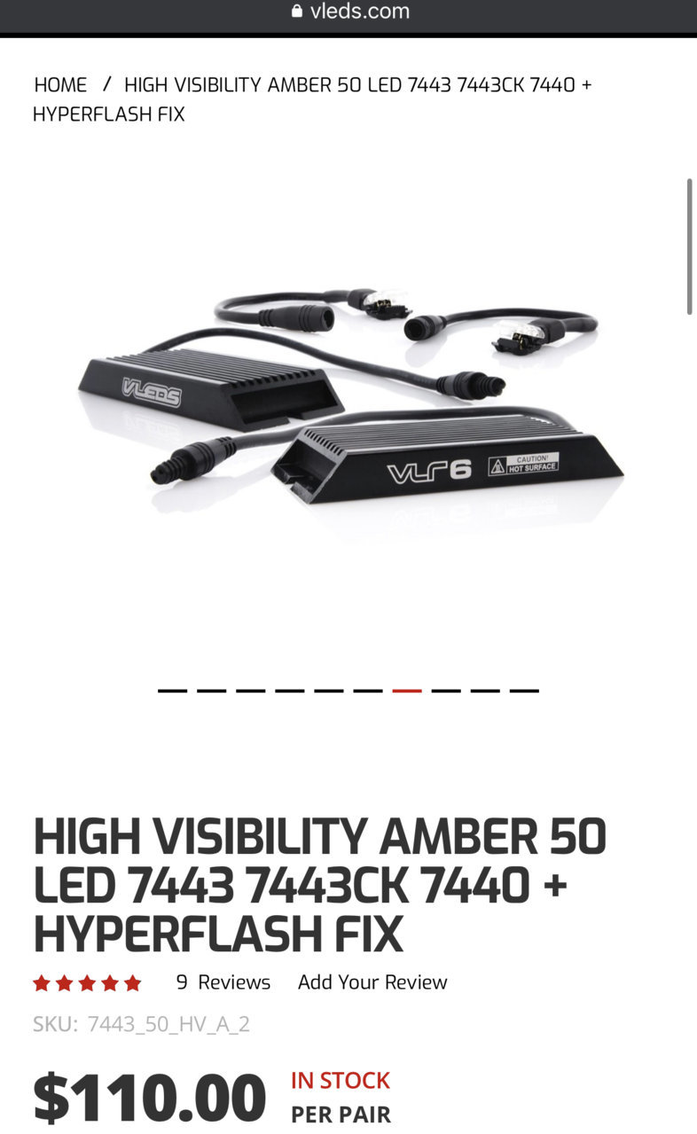

    You got the wrong resistor kit. Get the 15 Ohm kit that comes with the Y splitter. It will interface with the Meso switchback bulbs and will work perfectly.
    https://www.vleds.com/vlr-15-wp-t-adapter-2.html
    as for the red V6s you just put the screws in them so you can twist the bulb into the housing, then you use those bagged adapters to thread onto the V6s and then plug them into the old bulb socket that you removed from the lamp housing. Put some heat shrink over the socket and socket adapter harness if you want to prevent it falling apart, though it’s pretty snug on its own.

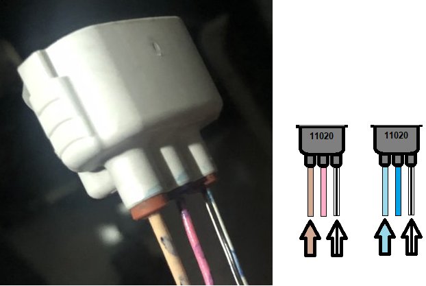

    For the front turn signals (it's on their site)
    On your Sport, the turn signal connector should have 3 wires.
    I suggest you fill the taps with dielectric grease to minimize moisture intrusion.

    I thought sports should have the same 2-wire turn signal as the off roads and pros since they have the L shaped DRL instead of the amber parking lamp/turn signal DRL the SR/SR5s have?
    Pretty certain he just needs to get a 15 ohm kit, one resistor per side of truck and stick them out back. They can be plug and play with the Mesos rather than using the crappy duotaps. Shouldn’t need anything up front.

    Dunno what the OP has...:boink:
    L-Shape DRL might be the White only kind (Bright/Dim)
