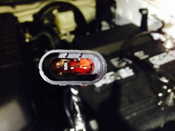

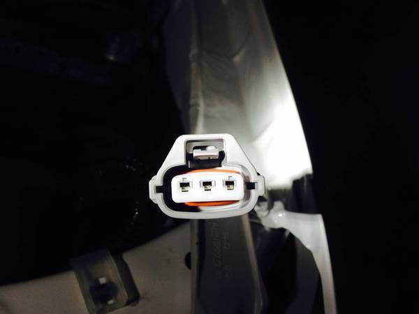

    Need help!!! Just finally got some time to install my V3 Triton's, however, I'm have a problem. My drl connector on the vehicle harness does not fit the connector on the ballast, as it seems as if they're different connectors. Is this right, or am I doing something wrong?

    Is this on your 14 taco? if so, i hope this doesn't happen to me when I order for my 13 taco.

    Yea, this is for the '14...not too sure if you guys have different connectors on the '13

    Did you try plugging in the harness at the bulb socket? looks like you're trying to skip a connection.
    it should be;
    factory wiring -> factory bulb socket -> Triton bulb socket plug - > Triton harness & relay box -> Triton bulb.

    From vleds.com
    "Tell him not to unplug the stock harness but rather use the V3 bulb base
    adapter where the stock bulbs goes to install."
    I think that's pretty much what Luka pointed out.
