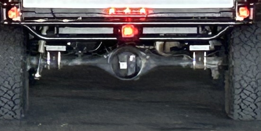

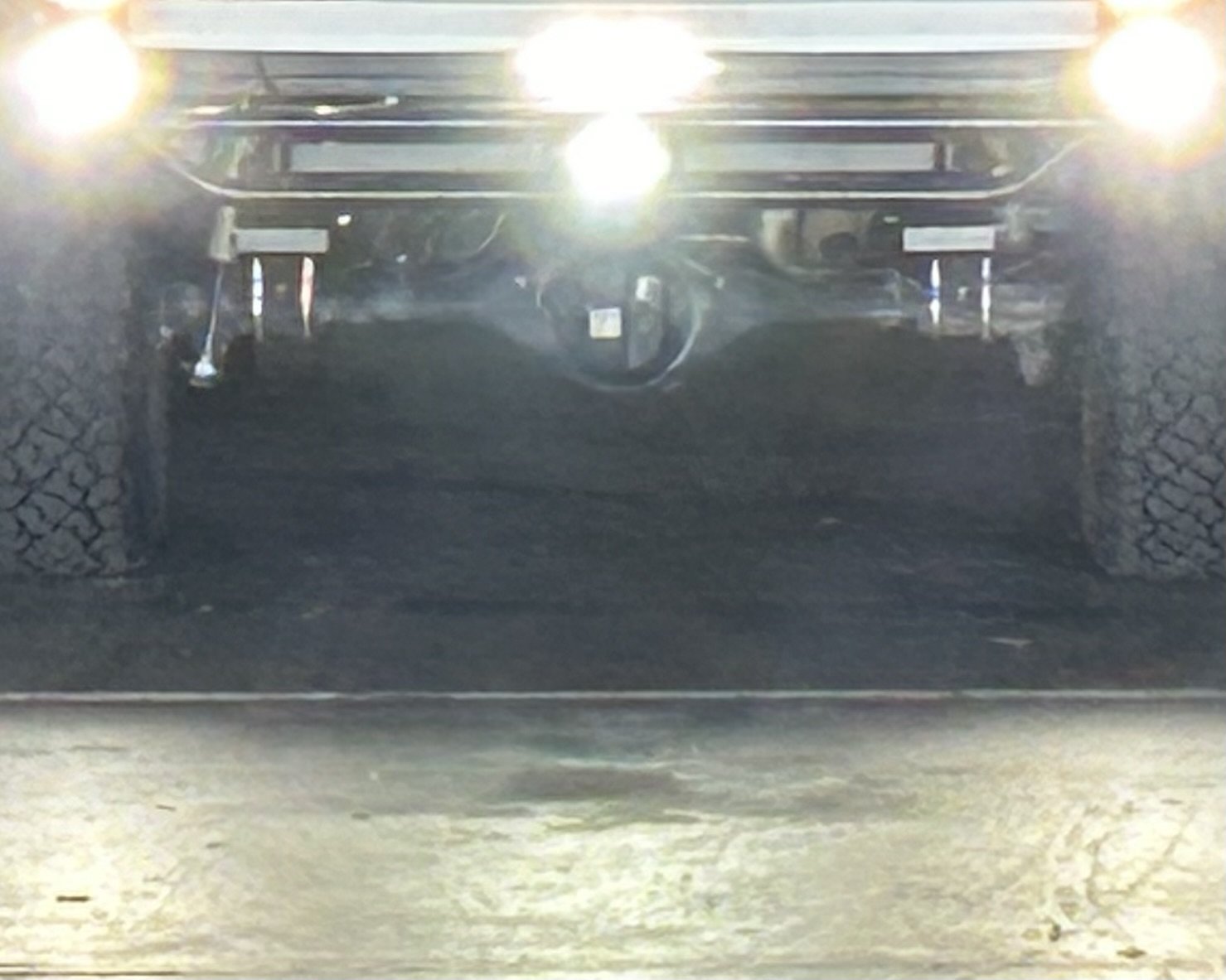

    I need to figure out why the DD corner pods don’t come on manually with switch
    or figure out a way to trick the truck into thinking it’s in reverse for all of them
    for temporary trail lighting.
    don’t know about blinding people. If they go on to hit someone then what.
    hoped red would make the truck more visible. But don’t know about that.
    Good old CA. Truck could have the entire tailgate be a running light panel people will still hit it.
    as funny as it would be to see wheeling in reverse, it’s huge the difference in price between lighting in back and lighting in front…

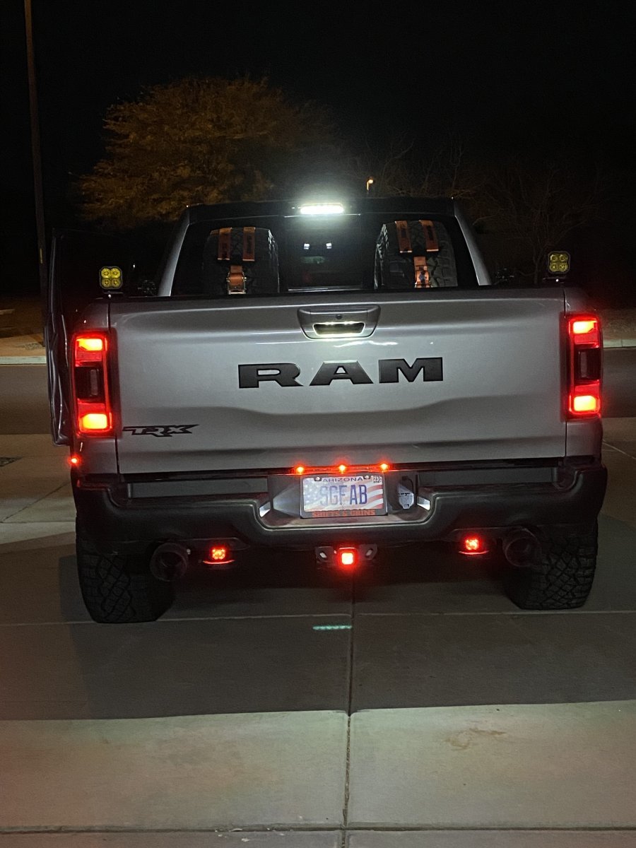

    Sounds like a load issue. Just from your picture you have 3 DD pods + the LPR + who knows what else. Return to stock and then add one at a time. That’ll tell you if you have an issue with a specific light, module, etc. or if you simply need to balance the load. Hazards not working is pretty telling. The LPR is very low draw and I can’t speak for your DD pods.

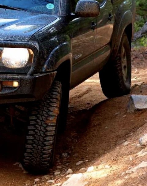

    Yes 3 pods that I assume are low draw as well due to LED
    but in total potentially at the limit of stock design
    without deleting anything might be worth trying switch signals and reverse from halogen to LED
    as with hazards on it is 4 amber halogens flashing (power draw)
    actually…good point…finally got around to wiring up front ARB bumper lights
    which have a marker and signal that are probably halogen and not LED
    making even more consumer draws when hazards are on.
    more worried about what halogen would be consuming (at this point 6 or 8 bulbs) as that’s likely uses much more power than LED.
    was just curious if anyone else had this or what workaround such as if they perhaps changed fuse from 10a to 15a without issue
    that on LED I assume the wiring is no issue.
    (front corner bumper oval
    Inner = signal yellow
    outer = parking white)
