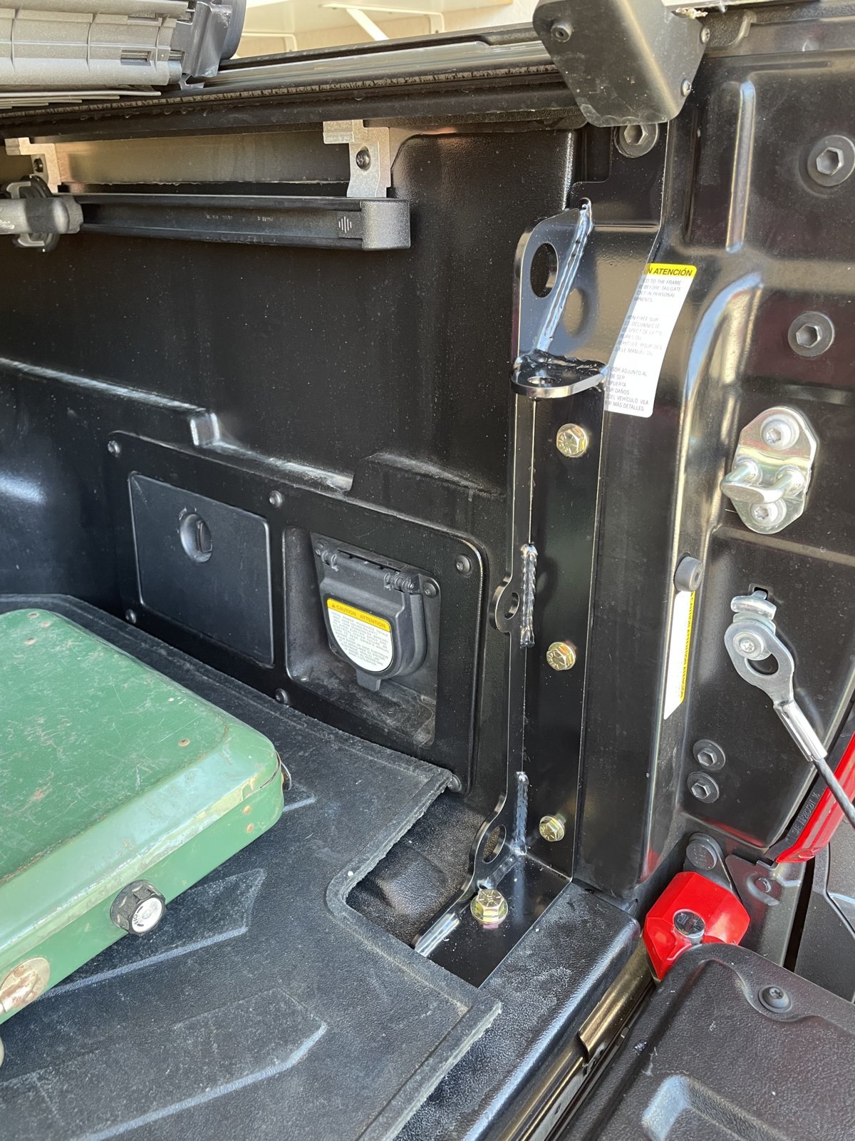

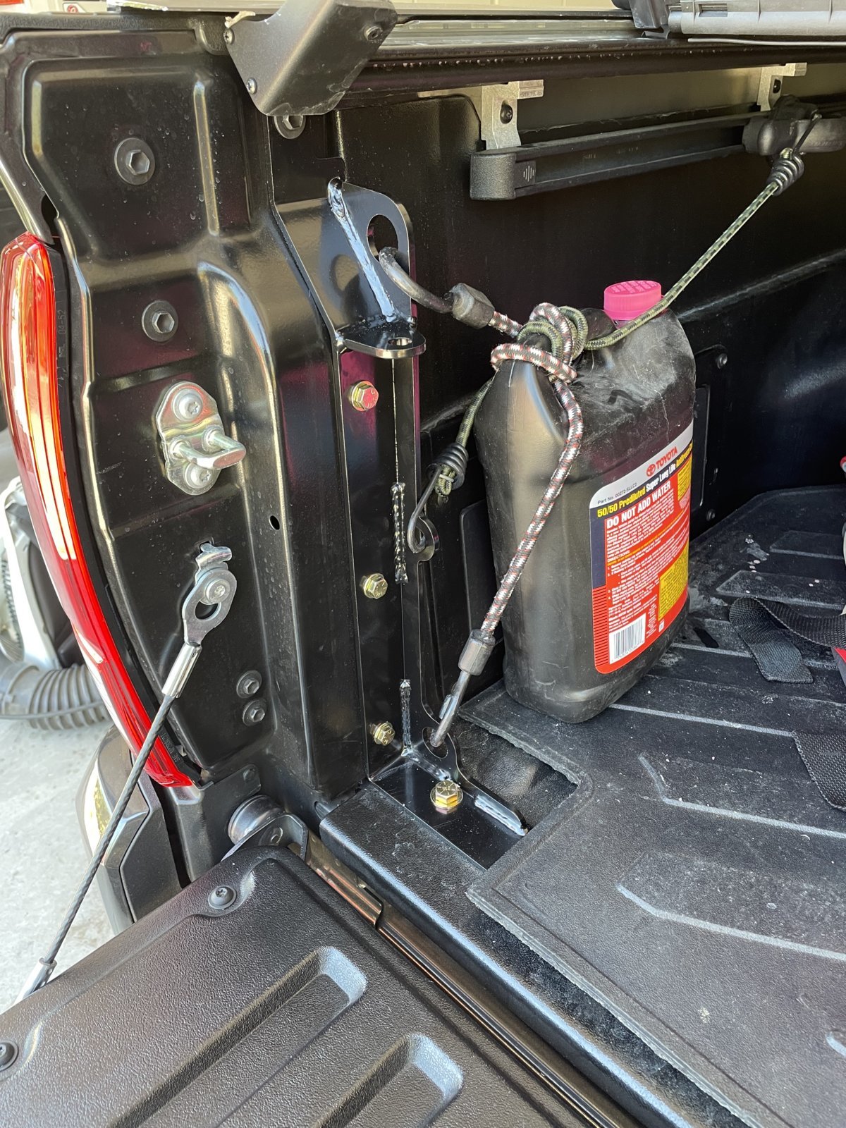

    Yes it should work. Is there a gap in the track for the tonneau near the tailgate? I can't really tell from pictures. The harness has plenty of slack to accommodate a lowered rail, but my concern would be getting the wire harness neatly out of the bed via the bed rail cap and routed to behind the tail light where the relay will be.

    Not sure I understand. :confused: These are the only pictures I have at the moment.

    Oh yeah you're fine :thumbsup: Exactly what I needed to see.

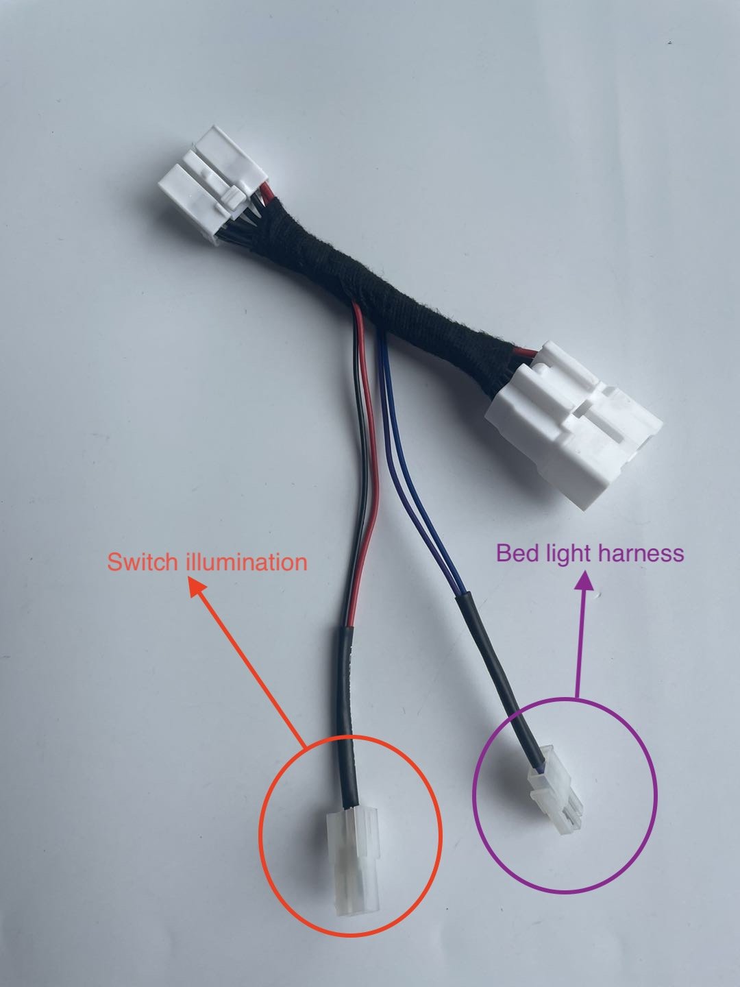

    I have gotten a couple of questions about compatibility with the switch illumination harnesses that plug into the cargo light switch. I hate daisy-chaining multiple harnesses into the same switch so if you already have one of my switch illumination harnesses you can just unplug the 2-pin connector and replace the main harness with the one in this kit. I left the appropriate wires to plug the 2-pin connector that runs to your switches right back:
    The 2-pin for your bed lights and the 2-pin for your switch illumination are opposing-gendered and labeled so you can't mess it up... I hope.
