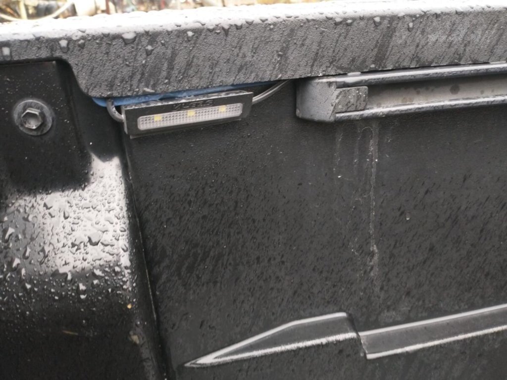

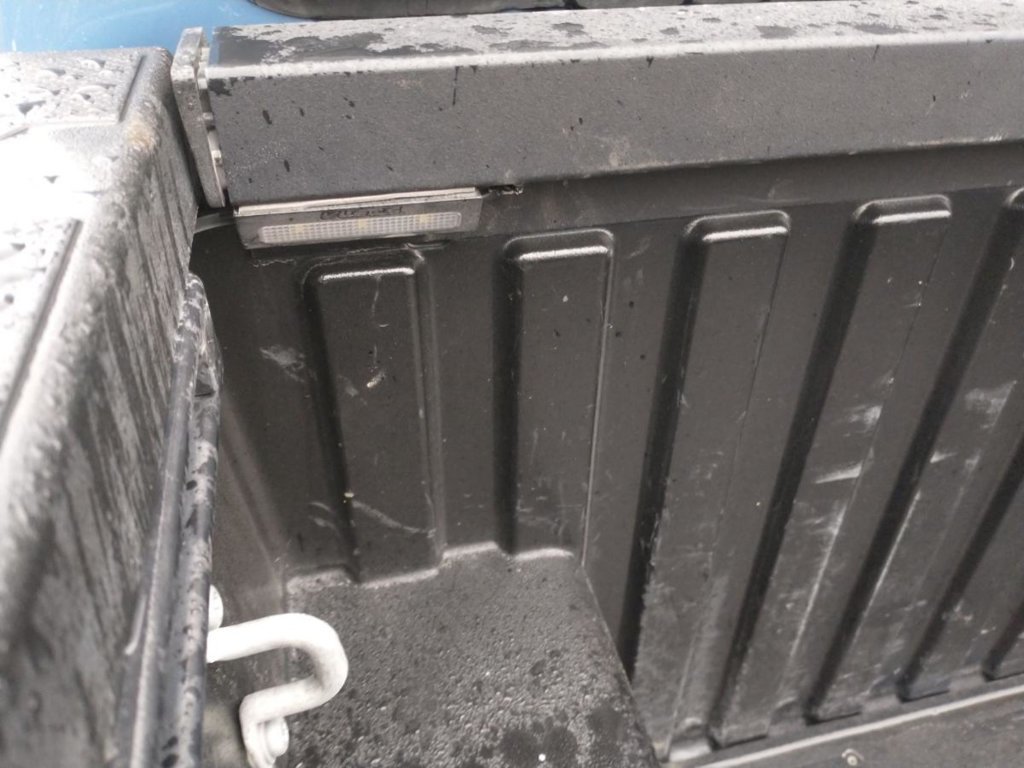

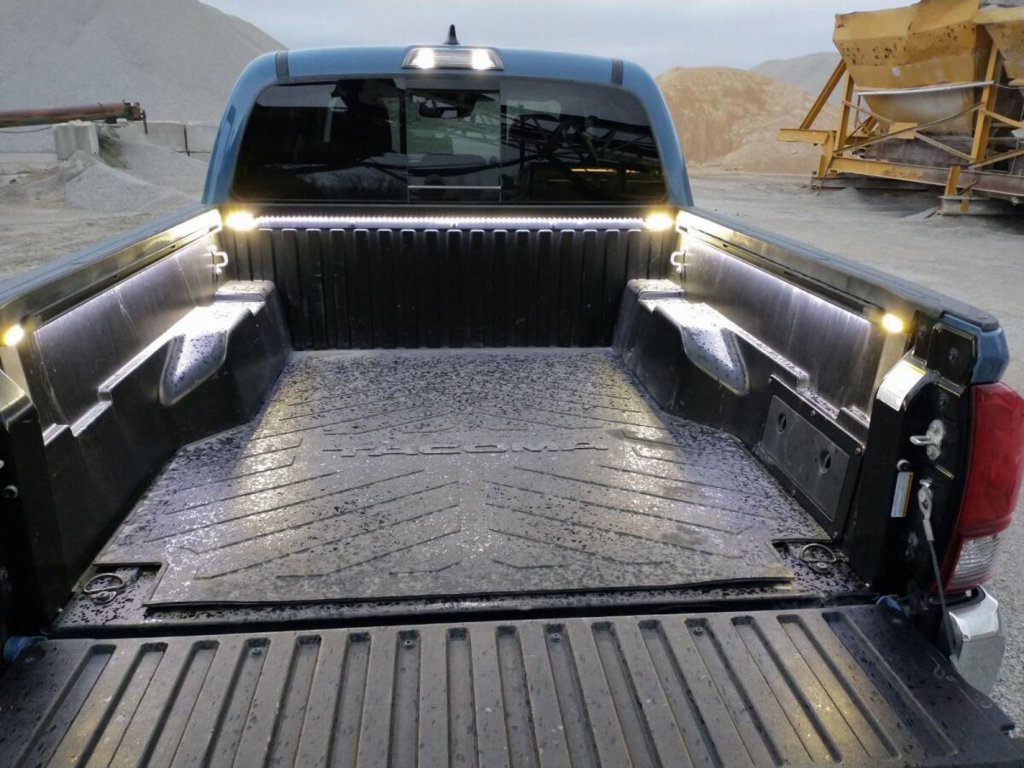

    So...I just got finished installing my matt gecko bed lights, and then I found this thread. I wired Matt's lights a bit differently than the instructions showed, choosing to have them switched from the cab instead of from the bed. I thought, "If only they could be controlled by the cargo lights instead of using a separate switch"... and then I saw this thread.
    I thought for a bit whether I could justify buying another set of lights after the first ones but it didn't take long to decide, "Sure I can!":laughing:
    I had to mount the VLED lights a little bit differently due to the other lights in the way and then I had to route the wires differently but they tucked up neatly under the bed caps and through the front rail. (I had to drill a couple of small holes in the rail.)
    Then I unpinned the hot lead from the relay and hooked the matt gecko lights to it, repinned it, hooked up the ground and voila; they work together perfectly.
