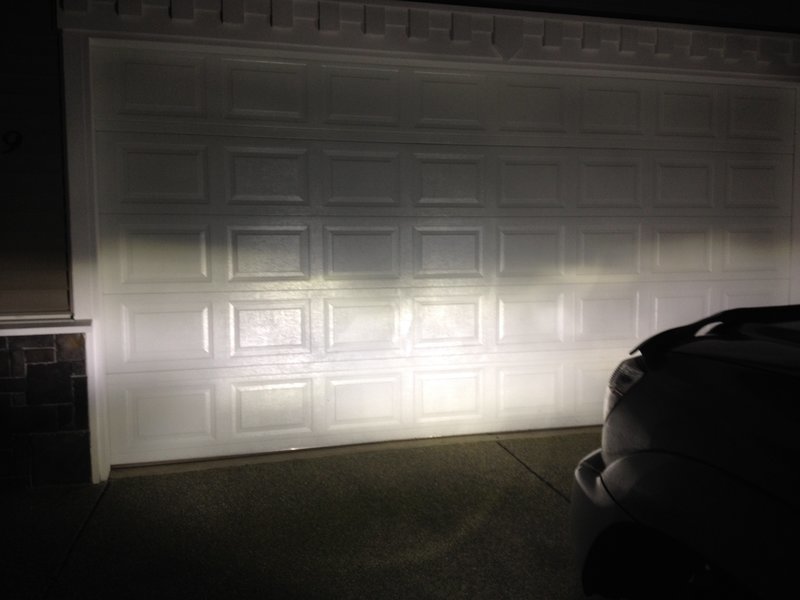

    OK. here's some pics. They're just shitty phone pics taken in my sloped driveway pointing at my highly reflective white garage door. Not ideal but it gives a good idea of the spread. I will try to add some pics later showing what kind of range they have.
    Old bulb, new bulb
    One bulb installed
    left fog VELDS. No headlights. Note difference in new/old.
    Both bulbs installed:
    Only fogs.
    Only low beams
    low beams plus fog
    Only high beams
    high beams plus fog

    It seems like the beam is still nicely focused/contained and I don't expect to have any problem with these having fog lights on while approaching oncoming cars (as is the case with some other LED bulbs that just throw light everywhere). For 80USD + shipping and a 2 minute install I'm pretty happy with the upgrade. @nd4spdbh I don't know if they're actually 2800 LM each as advertised but I will have a better idea once I've gotten them out past the end of my driveway.

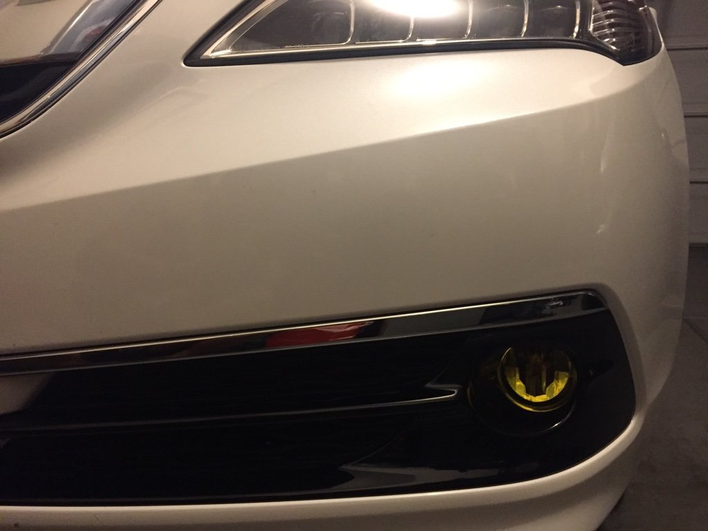

    25 Tundra TRD pro

    Thanks for the pics. Way 'yellower'? light output than I would have expected. I'm not a huge fan of the yellow lens on the silver bumper cosmetically but I'm too old to worry about that kind of stuff. Now that I see how much effect they actually have on the light output, I'm sold. I'm guessing they're a bitch to install on those bulbous fog lenses. You don't have them on your Taco?

    i dunno... the cutoff with the original bulb is MUCH better than the LED.
    And there is no way they are getting 2800lm per 15 w led bulb. Your lucky to get that our of a 30w LED setup.

    I don't mind the slightly wild cutoff and it doesn't extend up above where the low beams are so they shouldn't bother oncoming drivers. Definitely more coverage than stock fogs but that's kind of what I wanted, a pseudo driving light/fog light upgrade.

    I agree with the cutoff lines. The left side definitely seems to shoot up. Is there anyway to adjust them? I know some LED bulbs are actually supposed to be aimed to reflect in the housing a certain way. Right now they may seem like they're below you low beams. But you're what 8 -10 feet from your garage and they already raise about an additional foot form the stock cut off. Translate that to the distance of oncoming traffic and that beam may be up past your headlights. Just my observations, bottom line comes down to if you're happy with them and wether or not you see any negative cues from oncoming traffic

    Yeah and if you consider the fact that the fogs are starting from a much lower point than the headlights they will continue to ride much more so than the low beams. You guys are right. I may not want them on while approaching traffic if people seem to mind them. I will likely test it out a little more, but if all these things are good for is adding 5600LM to my driving lights without having to mount a small LED lightbar, I'm happy.
    I'm not sure about adjusting the stock fog housing.
