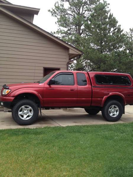

    This is with the spacer lift and a good old power washing
    to show that paint... I have quite a few rock chips and some other scratches, looks good from this distance tho:D

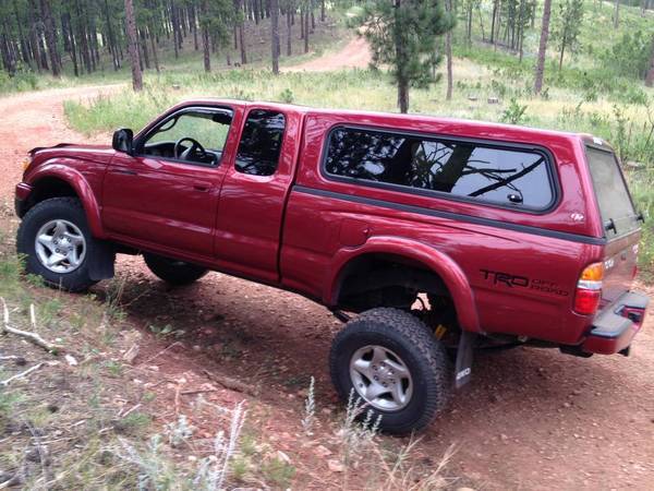

    Lift on and had to see some flex

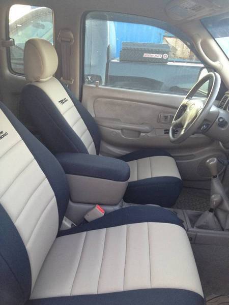

    Wet Okole, Taupe/black, and the mistakenly-given? free? center console cover

    Dude... I love your truck.
    Are you still running stock tires after the OME lift? I love that stance the tires look great with it.

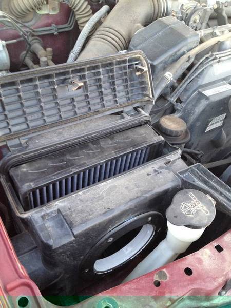

    Hey I am new to the forum and have a great Tacoma but dont know a whole lot about it. Got a couple of questions regarding air filter. Mine looks like yours. I dont think its stock. Now today I was checking it out and noticed that on the filter it gives directions to take it out, wash it and oil it and put it back. My Haynes doesnt say anything about that.
    Also, in the picture of your air filter, i see that You have opened the round cap infront of the mount. Mine has an arrow and says open. I tried to twist it and see if it does open. It didnt. and I didnt even know why it should open as i think air filter sucks air from the side (passenger side) Can you tell me why you have yours open? How can I open mine?

    Hey Sean, nice truck I like it. A pic might help of your setup. My filter is the afe pro dry s, not stock. it does not need to be oiled so be careful with that unless u know what kind it is. The air box itself sounds like the previous owner did the deck plate mod too. It is done to improve airflow and it sounds louder over stock. I keep mine open and it's nice bc it can be screwed back in if you think water or lots of dust or sand could enter. I do not know why yours doesn't unscrew, but try to get a pic for us, and welcome to tw

    ImageUploadedByTapatalk1343248112.312931.jpgImageUploadedByTapatalk1343248131.994428.jpg
    Ok got it open. Now: should I leave it like that? Under certain conditions? Helppppppp
    Found out about the oil by calling manufacturer. They said go to Atv store

    Sweet, the deck plate cap looks different than mine but same idea. If you like the sound it gives leave it off,(basically why I did it). I can tell on mine open vs closed and I think I get slightly better mpg. If you are worried or don't notice it, just close it. Search deck plate mod on here for other members input.
    Hope I helped tho.

    If it's a foam Amsoil filter it should be the same as the old True Flows. Go to the power sports store and buy a UNI foam filter cleaning kit. Its the same as the old Tru flows.
