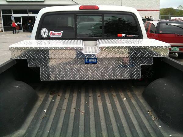

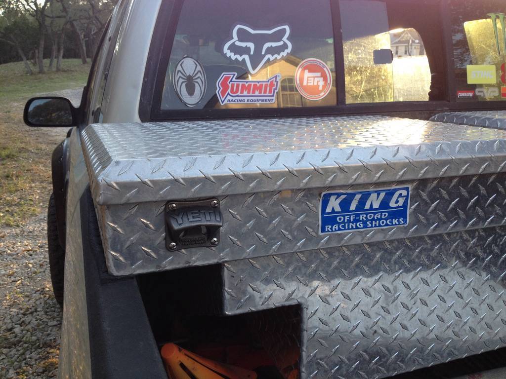

    My first real addition was a Gull-wing tool box from UWS. I did not want my tools to rattle around inside so I lined it with indoor/outdoor carpeting from Home Depot. I worked out the patterns using paper templates until everything fit just right. I hot glued the carpet pieces in place.

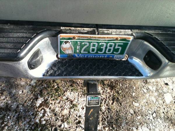

    The step on the rear bumper was really rusting from the Northeast winters, especially where the hole for the receiver ball was.
    I used an angle grinder to remove as much rust as possible, then primed the area. I filled all the cavities including the hole with Bondo. I then sanded it down and primed again.
    Finally, I got a piece of the rubber self adhesive step material and cut the desired shape and applied it to the step.

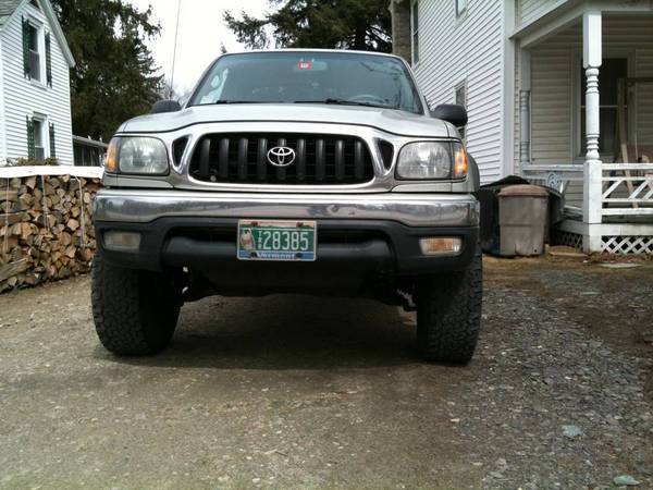

    My next addition was 1.25" wheel spacers from Spidertrax and new Powerstop slotted and drilled rotors(no picts of install, sorry)

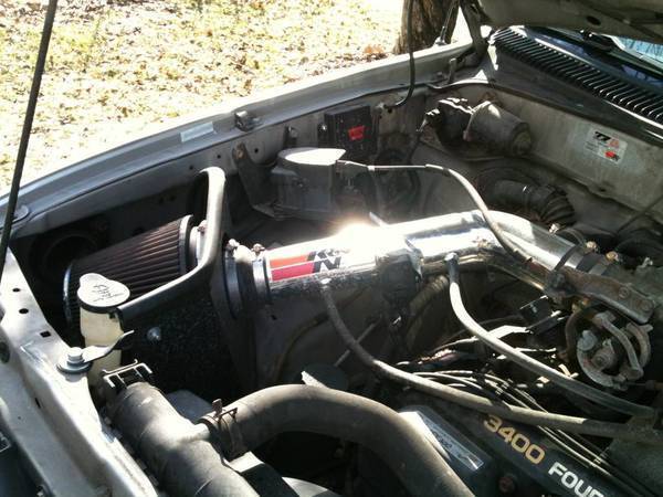

    Next I installed a K&N series 77 CAI

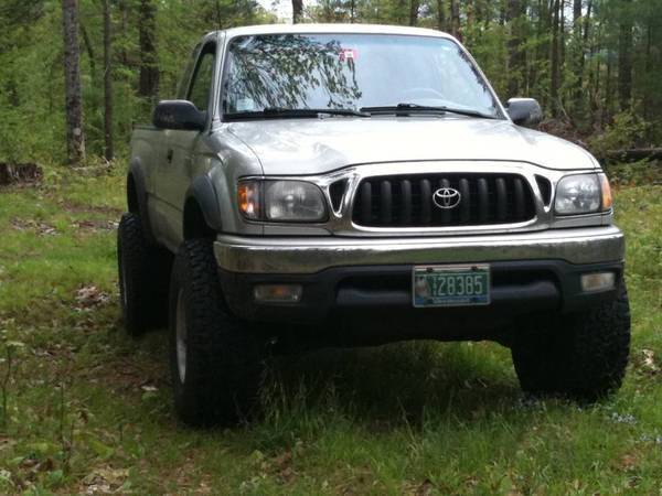

    I picked up a used set of 33x12.50s on Outlaw IIs 15x10 with 4" BS from a local Toyota owner. They sat around until I picked up my Hi-Lift jack.

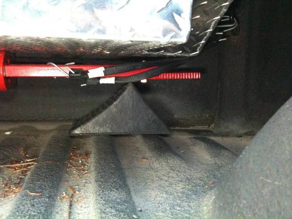

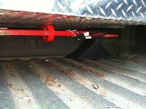

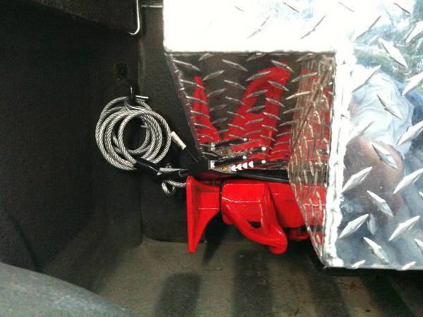

    I secured the Hi-Lift under the toolbox with tie down straps and a padlock.
    I used tire chocks to keep it off the bed.

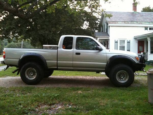

    I removed the Spidertrax, as the wheels had 4" BS. Here are the wheels finally installed:

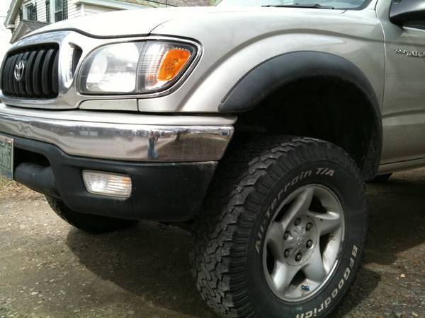

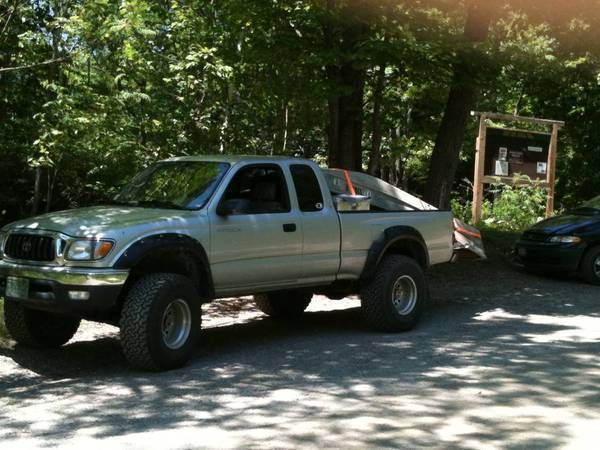

    I found out real quick, I needed to trim to bottom corners of the front bumper as well as pound down the pinch weld in the rear of the front wheel wells.
    I then picked up as set of Bushwacker fender flares.

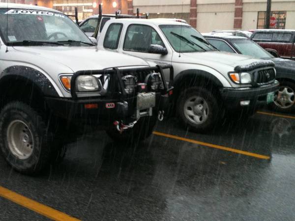

    This is the only picture I have of them in sequence. This was on my first outing with a used Jon boat I picked up...I loaded it like a retard..have learned since then.

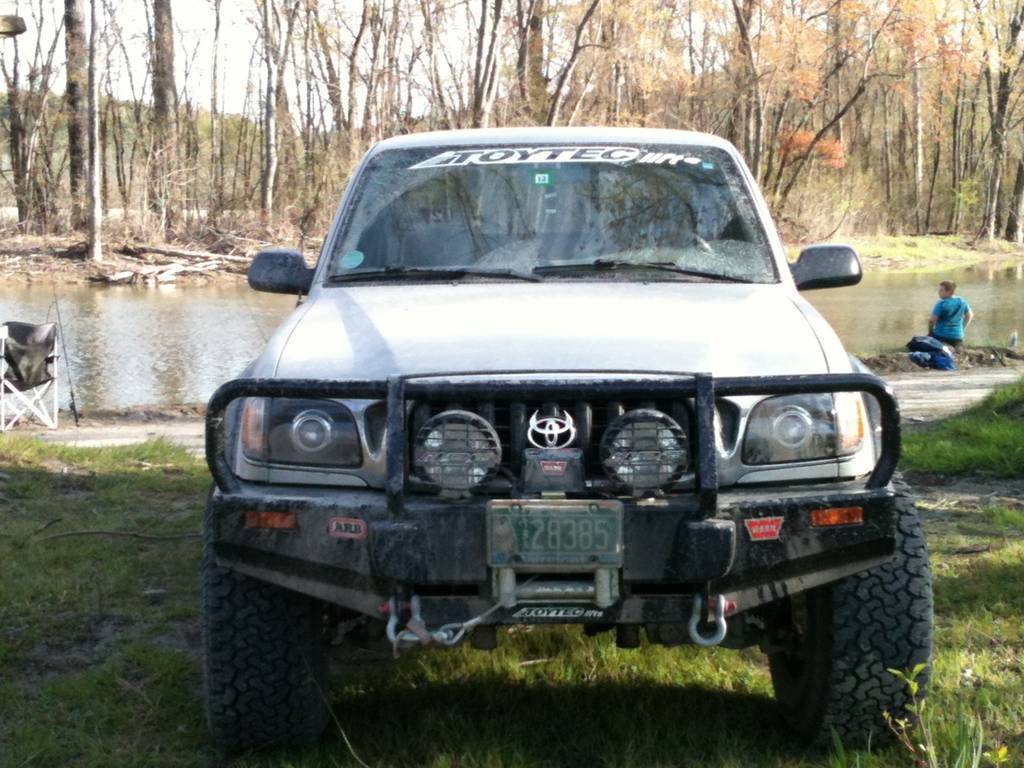

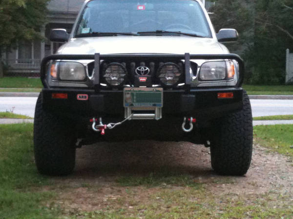

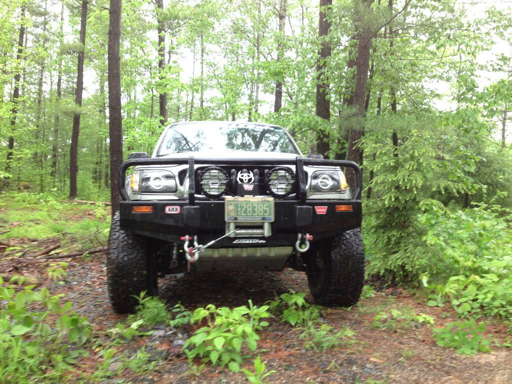

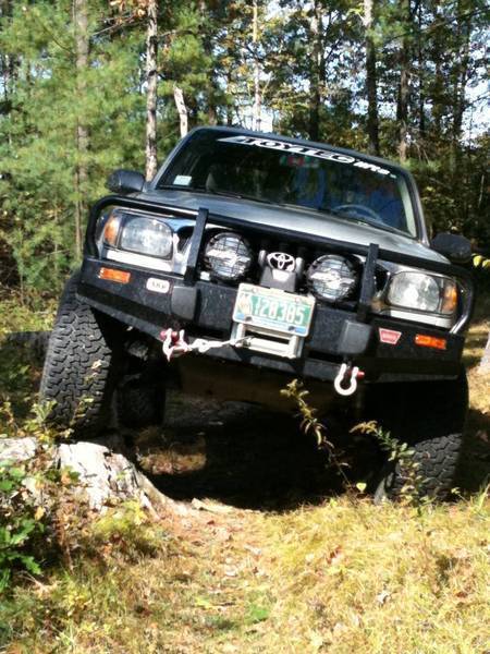

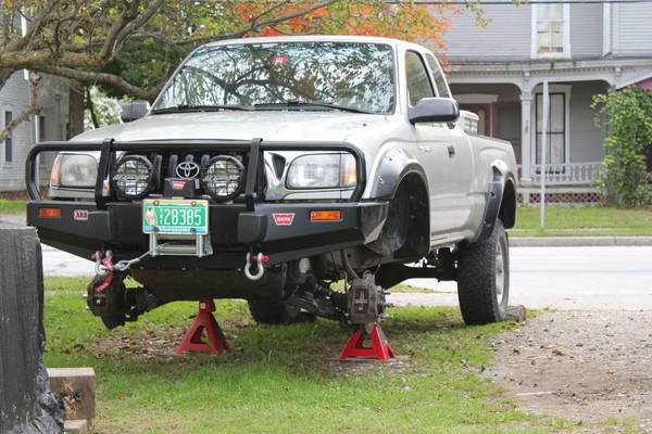

    Next came my ARB bumper with IPF 900XS lights and a XD9000 Warn winch with remote control.
    For some reason the holes to mount the license plate bracket were misaligned on the bumper and the supplied bracket would not work.

    I fabricated a new license plate bracket using of a pair of aluminum "L" channels riveted together with offset holes.

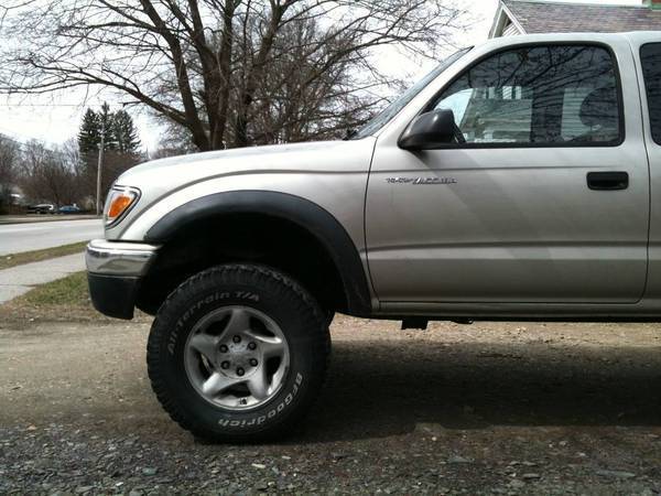

    It was way too much weight for my stock springs and 33s so I switched back to my 265/70s until I could get my front suspension upgraded.

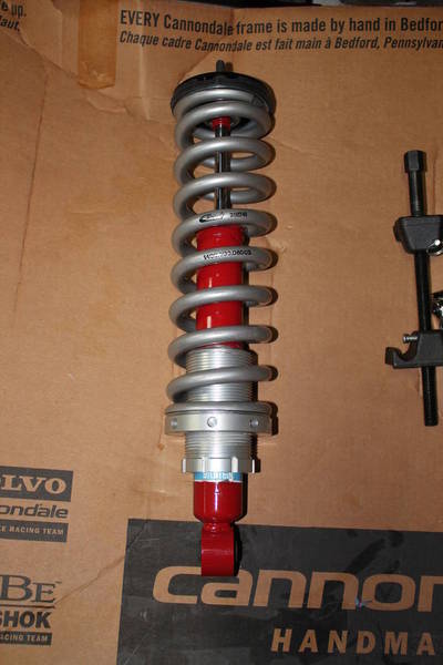

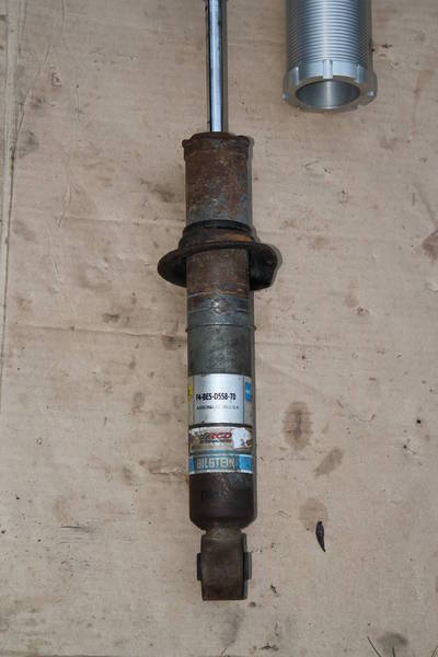

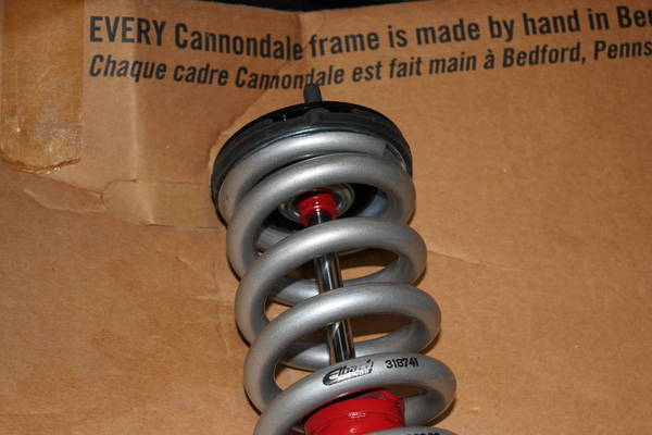

    I picked up a set of Toytec coilovers using the Eibach 620lb springs.

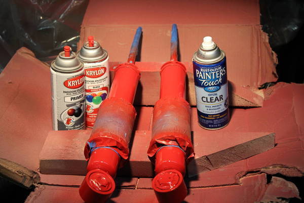

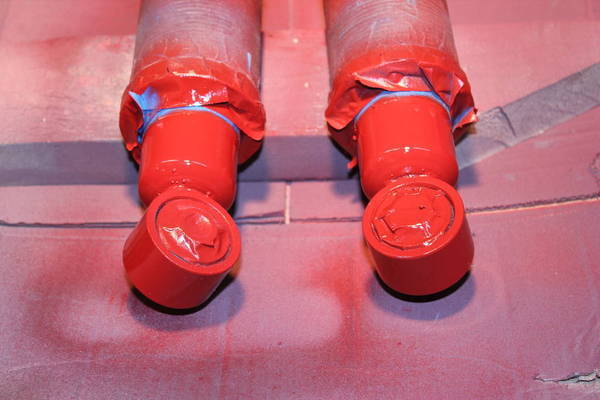

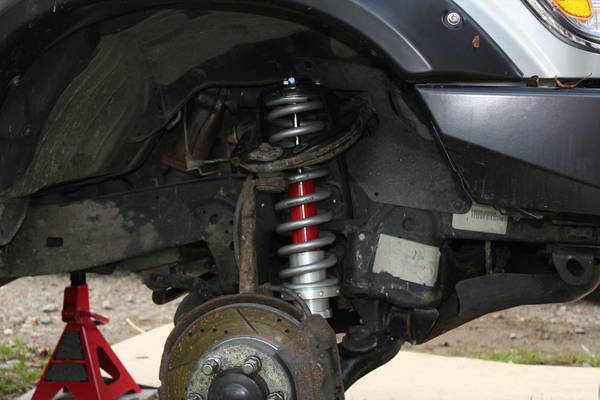

    After taking the original coils off the 5100s I realized the shocks were just too ugly to pair with the new Toytec kit..
    So I decided to refinish them. I knocked most of the rust off to install the sleeves, then went to town sanding, priming, painting and clear coating them. I installed new top mounts and bushings. I decided to paint them with the sleeves on as not to scratch the paint up installing them.
    [with compressor pict here]
    Testing levelness with new struts. I tightened the lower adjusting nut a little at a time, driving it in between. to finally level it out.

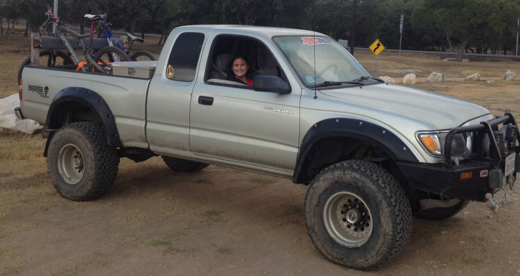

    I put my 33's back on and went for a test run...

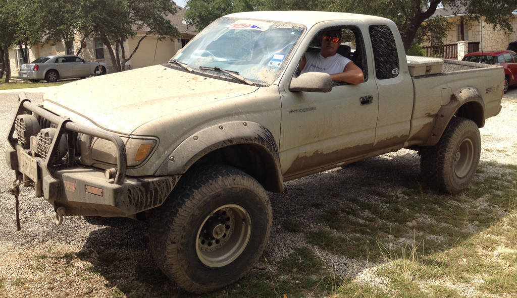

    Here I am next to a stock Tacoma
    ...a poser pict:

    I like them alot. While these were the cutouts I did get some clearance gain, but not in the areas where I was actually rubbing, primarily at the front bumper and near the pinch welds in the front wheel wells (I trimmed and pounded these down before the fenders were installed anyways). The main reason I put them on was pass inspection as my new (used) tires stuck out quite a bit as they were 12.50" wide running with 4"BS.

    Truck looks awesome. Keep it coming.
    How do you like the 33x12.5 in all of the VT snow?

    Yeah...I work as a lighting designer.
    The 12.50s are a little wide for the pavement, but work well on the backroads. I put 4-60lb bags of sand in the back now versus when I ran 2 bags with my 265's last year. If my 265's had a little more tread I would have switched them back for the winter.
    Thanks for the compliment!

    I used to do the same thing when I lived in NJ. Now that I'm in SC, its no longer a concern. Hopefully we'll get some snow this year.
    You could throw a full size spare back there if you don't need the bed space.
