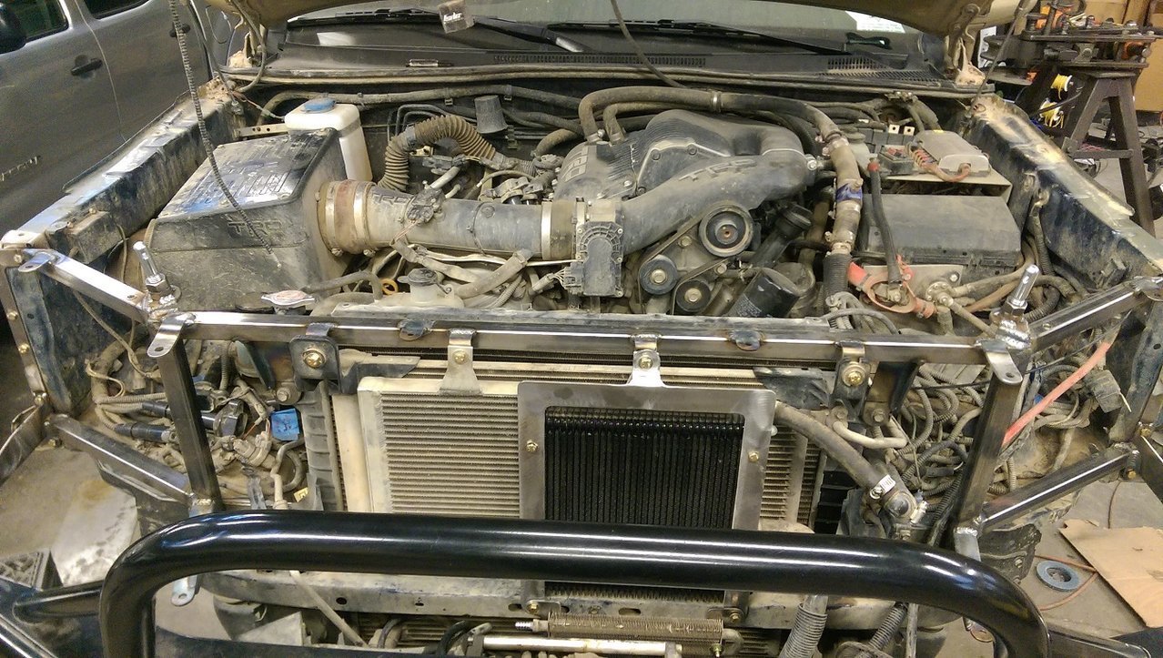

    You can slow down by drilling holes at the end of crack lines as a relive, and weld patches of metal on top, that’s my band aid. Realistically I’ll be building out of square tubes similar to what JD did and rad support also going to be fully square tube like the image below
