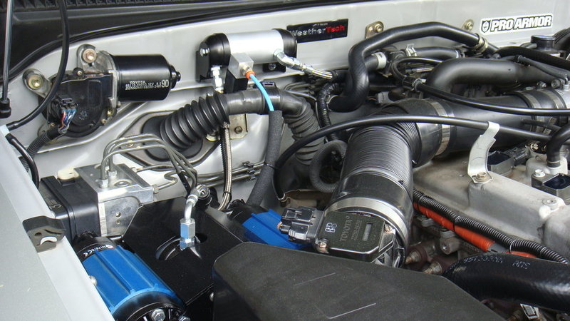

    I suggest making your own... cheap too. Used PVC and a kit from Napa which came with SS clamps, grommets & flex tube. Definitely use the OEM air box and a dry filter. I'm using a Fram. I modified the inside of my air box which definitely helped.

    What size pvc did you use. I attempted this but it seemed if memory serves me right the perfect size would have been 2 3/4 inches. All I could find was 2 and 2 1/2 inch pipe. I was just trying to eliminate that stupid box above the exhaust manifold and use factory hoses and clamps.

    What I originally did after removing the 'stupid box' was this, measured the opening on the bottom of the flexible black rubber tubing and found that the same size plug was a McCormick's Onion Powder seasoning lid. I stuffed it up there and used a hose clamp to seal it. Worked great... then of course the PVC.
    I'll get that measured later today and let you know the size.

    My reasoning is the same as stated above, more to remove clutter from engine bay. I think its useless crap and love to tinker. In case anyone wanted to know they pipe would need to be around 2.75 outside diameter to work with stock fittings. 2.5 inch pvc has an outside diameter of 2.85 which should work but will need a indent made to fit over coil pack or angle pipe upward slightly. Then the stupid box thingy could just be removed and this pipe put in to replace it. You would also need to drill hole and make fitting for small line to hook into tube. I maybe attempting this shortly and will post pics when done.

    Correct... I used a small butane torch to create the small indent to clear the coil pack and a 1/4" drill bit to make a hole for the small rubber tubing.
    Hope this helps.

    The PVC size I have is 2.75".

    1'' schedule 40 female PVC pipe cap. i sprayed mine black with some leftover bedliner... worked great and then ran the line off it to a T fitting and ran both into the air box on the side hole.
    edit; i put mine into the hole previously for the box and it sticks about 1/8''-1/4''into the hose.
