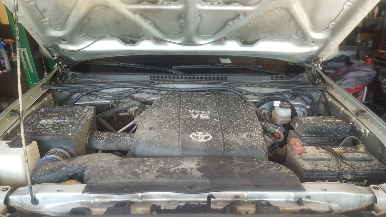

    shr133
    shr133 [OP] Well-Known Member
    Jul 8, 2013
    #107900
    2,215
    Steve
    Muskego, WI
    2010 V6 Sport
    K & N filter, 275 70 17 Cooper AT3, OME Nitrocharger shocks, 884 Springs, Dakar leafs.
    So far no dirt or water gets in the ram air scoop.
    Still like the intake, I feel it's a good mod that helps top end power and no more rocks and sand in the intake.
    Now I have sent my ECU to orange virus tuning to be reflashed...
    The Volant intake is smaller diameter than the stock intake that is why it was running so rich at low rpm.
    Hopefully OVT can adjust for the new intake and fix the factory tune.
    I would say ram air scoop very good mod good money spent.
    Full intake ok mod below 3000 rpm good above 3000 rpm with the stock computer... But again results can vary using the stock ecu...

    shr133
    Jul 8, 2013
    #107900
    2,215
    Steve
    Muskego, WI
    2010 V6 Sport
    They should be able to fix the mapping. I'll find out, ECU is on the way back right now.
    Might not be perfect but hopefully much better than stock.
    The main thing is changing the parameters so it much closer to optimal and fixing stock compromises.
    Drive ability should be much better.

    shr133
    Jul 8, 2013
    #107900
    2,215
    Steve
    Muskego, WI
    2010 V6 Sport
    Tested the intake up north runs great, no more rocks, dirt and sand in the intake.
    I used to have to clean the sand out of my filter every day, now no sand.
    Only a few muddy drops of water made it inside but filter is still clean after tons of big puddles at speed...
    The ram air intake is worth it, and can be bought separately.
    Now the intake is working much better after the reflash of the ecu by ovt. Now that we can get the ecu reflashed, getting an intake will be better money spent. Power all the way from 1600 to 5000 rpm...
    Still eating gas, no way to get this engine more efficient.
    Next test is the dunes with an updated ecu flash...
    ChadsPride likes this.

    shr133
    Jul 8, 2013
    #107900
    2,215
    Steve
    Muskego, WI
    2010 V6 Sport
    Went to the dunes , intake works great. Good torque and top end..
    Only a little sand got in, I think mostly from getting behind sand rails, but I wanted to test worst case..
    So most defiantly get the ram air scoop, but now that OVT is reflashing we can now mod out our trucks and get the full benefit.
    The new OVT flash was much better..
    The new flash with an electric fan added 3 MPG so I'm back to 16-17 mpg with 3" lift and 33" tires..
    And yes 3 mpg is a huge change in range...
    And we are still working on the tune, but now that we can override factory settings the power and mpg is much better..
    And If you change the intake you will need a piggy-back like the unichip or better yet a reflash from OVT...
    I still have the unichip so I can run different fuel maps, 1 for power and 1 for MPG..
    Before the flash from OVT MPG was bad no matter what I did.
    You need to fix the ecu to get back the MPG...
    Now on the dunes I got 9-10 mpg and on the ride home with the econ map I got 16..
    The flash with out the unichip I got 17..
    bobsuruncle and ChadsPride like this.
