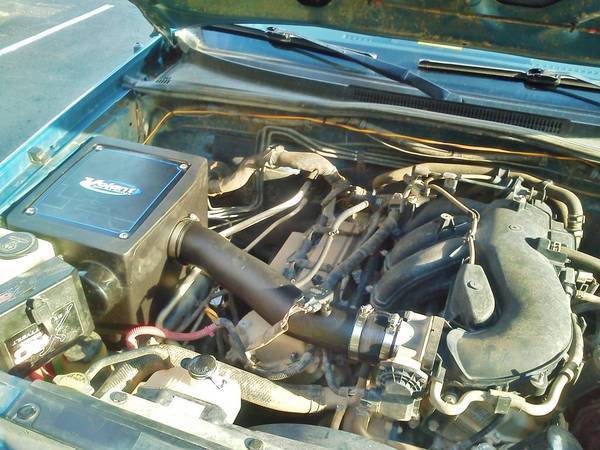

    neiether the old, nor the new versions for the tacoma (4.0L) have the reduction right at the MAF sensor.
    old style:
    new style:

    not much. looks like the bends are a little sharper in the new one, but that allowed them to keep the bends further from the MAF sensor. whatever it did, aparently it was enough to solve the lean issue.

    aparently people with the new version just take dark pictures :p
    herre's better angles of the old and new
    old:
    new:

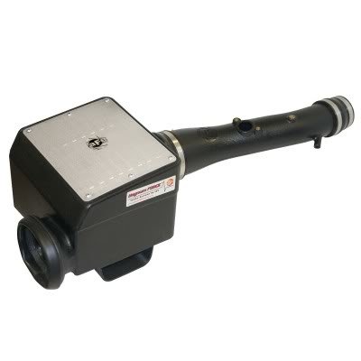

    This pic of the new design 2013 Volant intake for the Tacoma 4.0 clearly shows that they reduced the diameter at the MAF sensor.
    So they did resolve the lean running issue with a new improved model. The diameter at the sensor is a fixed value unless you readjust the electronic parameters.
    Mine uses exactly the same approach... oversized except at the sensor.

    Build thread in sig...
    "old style" in post number 46 is a picture of mine.
    i saw a bunch of pictures of the new one like what you just posted, but i wasn't 100% sure it was fro a tacoma because of the big thing sticking off the right side of tha air box. just threw me off becasue i didn't see it in any of the under the hood photos

    Built for maximum low end torque, tooter II.VII intake manifold spacer, LCE long tube header, Injen long tube intake, 2,900 rpm torque peak.
    I got the pic from carid.com. They list it as a 2013 Toyota Tacoma 4.0 Volant intake #38240. I'll guess that longer intake extension requires removal of the stock resonator chamber air horn in the fender well on the other side of the hole.
