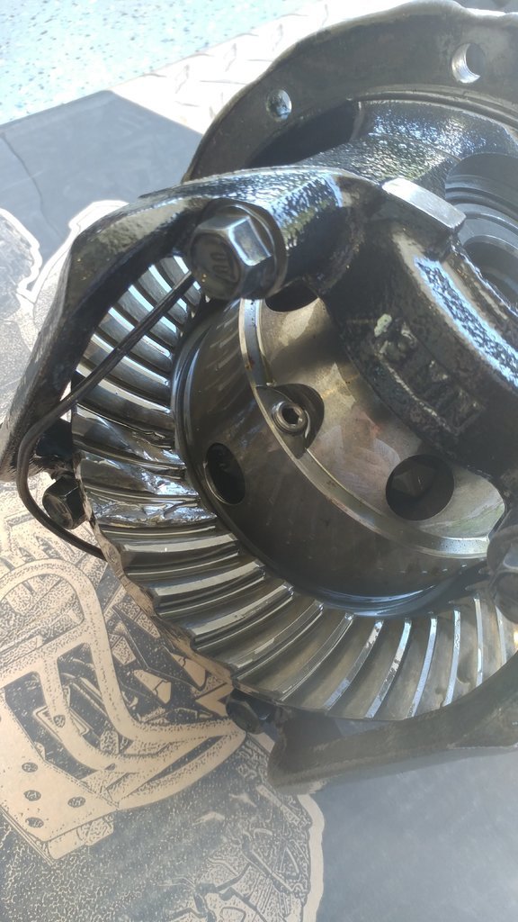

    Yep, that's broke. Good thing I've got a spare! Going in right now. Noticed a howling from the back end the last few weeks, finally parked the truck for good last week and decided I had to swap the diff finally, didn't feel safe driving it. Glad I did that! Could have fucked up more stuff if I'd kept driving it. Axle shafts look fine, so hopefully no issues with the new diff!

    Phew. Good find.

    Lol just posted in your thread before I saw this. Yeah like two weeks ago I noticed the howling sound on decell now did it continuously when I hit the throttle, so I knew something was going on in there, and last week I drove myself and my son to pick up some Starbucks for the family (5 minute drive on sidestreets) and it sounded REALLY bad, so I parked it and refused to drive it again until I could swap the diffs. I'm super glad I didn't procrastinate this and try to take it to work. Catastrophic failure would have sucked doing 80 on the highway.
    Axle shafts look fine, so I think just those teeth snapped.
    I wonder how much lost acceleration there was from those skipped teeth that I didn't super notice. Looking forward to breaking in the new diff. Definitely gonna break in for 1k miles this time and do oil swaps at 500

    Holy crap! And yours is a 15! How did that happen?!
