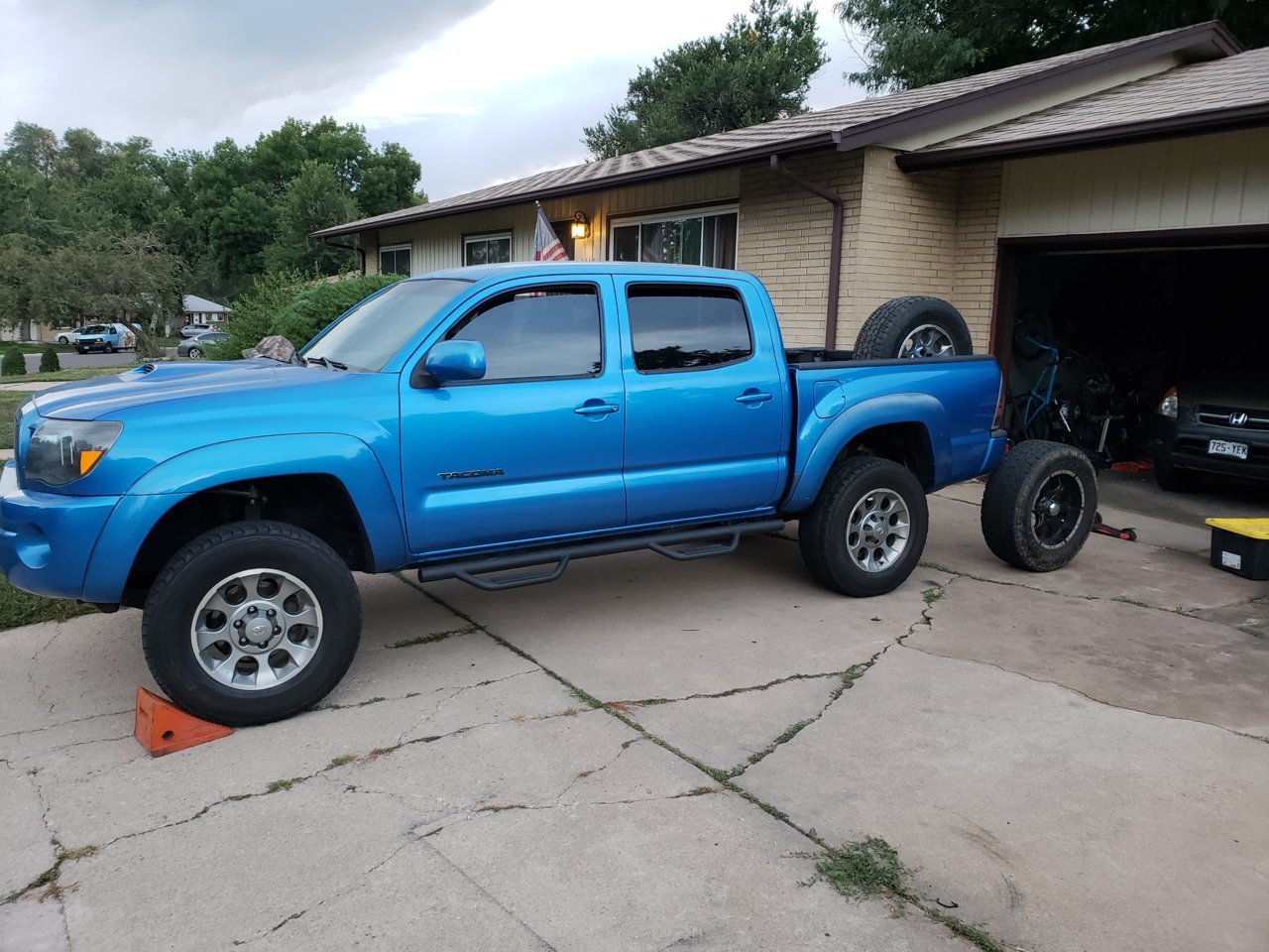

    Yours is great too! Something about that Speedway Blue always pops!

    Speedway Blue 06 Prerunner built like I like it.
    5.5 lift front 4 rear on 33s with an endless amount more work to do
    I wanted a Tacoma this color since it debuted in 04. 14 years later I found this truck... and had the finances to get it. I swapped out to 11 FJ wheels this weekend and I think it is an amazing addition to the speedway blue... but again I'm biased

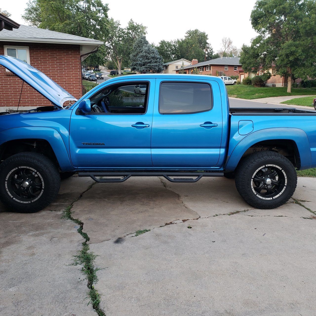

    Yea, black wheels really pop off the blue. The contrast is great, kinda like with the white ones. I'm trying to pump some life back into my 06 Prerunner. It's always run well, but I bought it new at the end of 05, so it's been nearly 13 years. Instead of getting a new one, I've been doing some mini mods that change the feel to go with some of the things I've done over time. Tint (30%) on the windows many moons ago but it still looks good. Black housing on head and taillights about 4 years ago and have gotten inspired recently to finally purchase some of the things off my Amazon wish list. haha. Recently changed 3rd brake light to black housing and will be plasti-dipping my wheels within the next couple of weeks until I'm able to get the ones I want. Yours definitely looks good. I want to raise mine 2.5-3", but that's going to take some time too. How high is yours?

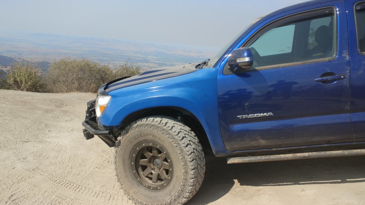

    Anyways, they're getting sold or painted soon (the fenders). When they were installed they either didn't fit right, or they weren't installed properly, either way, I don't know if I want to waste time/money painting them only to stare at the mounting points fucked up. I'll leave it there, but most likely ordering new ones someday soon and getting them professionally mounted this time.
    Here's a random pic from Hollister last week.

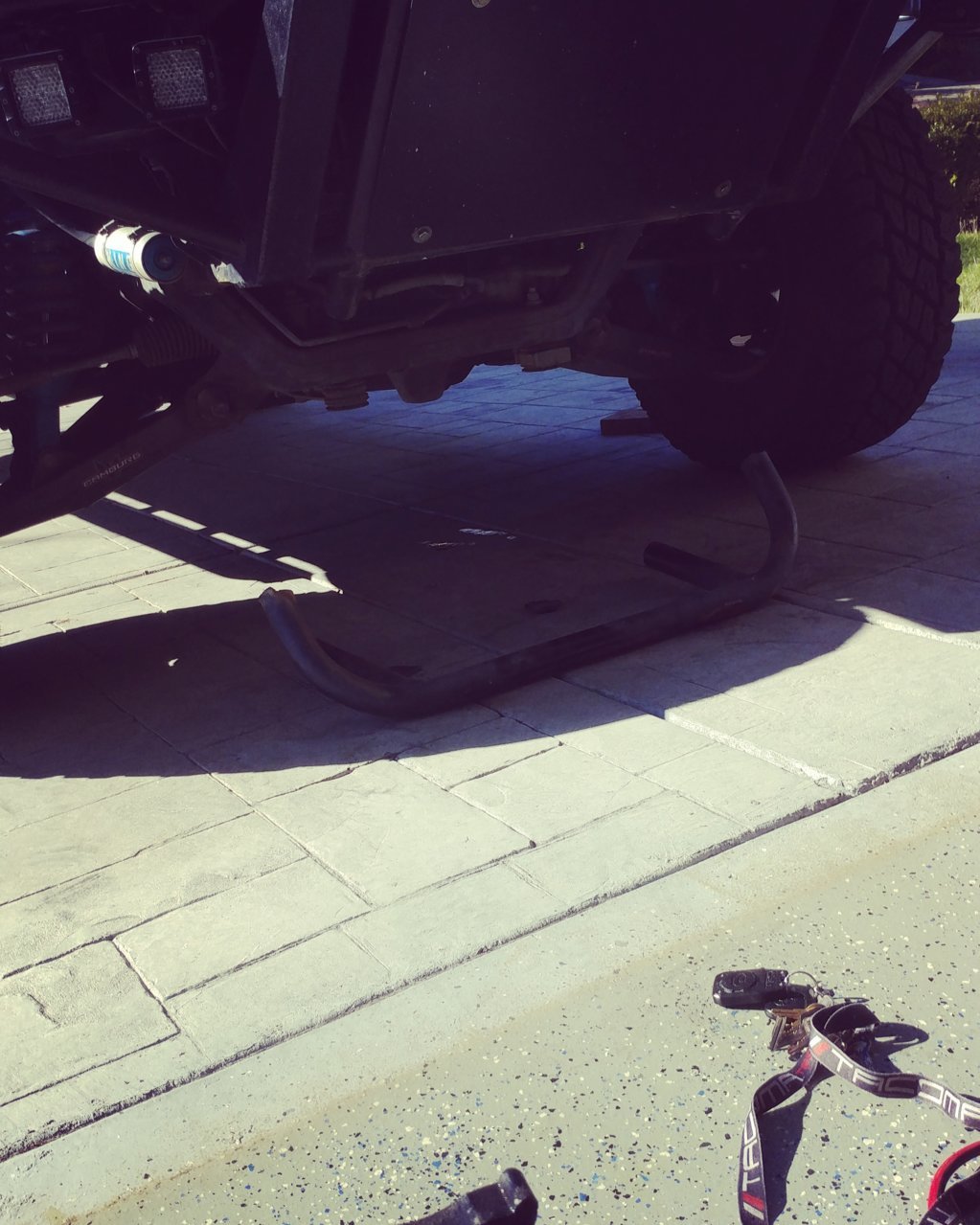

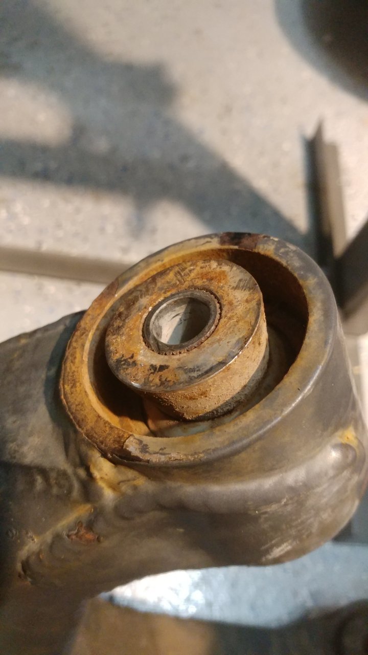

    So I tore the front end apart over this last week or two. Here was my final list of shit I repaired/replaced-
    LCA Uniball Adaptors-both sides
    New bolts and news for Uniball Adaptors
    New Brake Pads Rotors -EBC Stage whatever for trucks

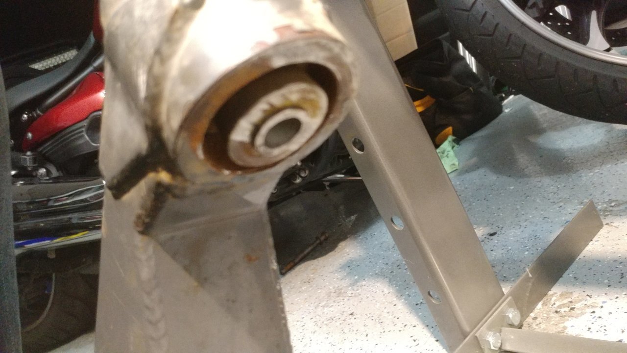

    Replaced Passenger side Alignment cams-The front one was completely stripped and seized(See pics)
    New Brake line for Passenger side Caliper (Brake line snapped when I twisted caliper up to hang it from the frame to prevent the brake line from snapping(yay)
    New Tie Rod Ends (because I'm an idiot and when they were stuck in the spindle I tried to tap them with a mallet to pop it out (instead of the softblow sitting next to me) and ended up burring the threads beyond repair on each side) ended up having to overnight tie rod ends to get them here in time, no dealers had them in stock and told me next week
    So after I got the LCA loose from everything, the front cam shaft/bolt/whatever was seized in the inner uniball on the LCA(no bushings, they have uniballs and misalignment spacers), So I ended up buying a Sawzall and cutting it out. Then I was faced with this-
    So in the first pic you can see the shaft has serrations on the end, that's because those are what hold the cam tab itself onto that shaft, which popped off when I tried to use the tab to pry out the shaft. So spent several hours questing for a solution. Tried a boat load of Kroil, tried a torch on the thing, and then a can of keyboard cleaning upside down on the inside of the shaft, the shaft laughed at me. So I finally went full Thor on the thing and go the side with the serrations in about 1/4", which is when I realized my eyeballs had lied to me when they said those serrations were the same diameter as the shaft. Turns out they were a fraction wider and were digging into the misalingment spacer the whole way in. At this point I'm like 'fuck it' and start going to town on the inside, which ended up mushrooming the top of the shaft that was sticking out. I went through 3 cutting discs on my dremel trying to cut the mushroom part off, and it laughed some more at me. So then I just started hammering and silently apologizing to the neighbors, finally, Luck! it started coming out the other side. After about 4 long hours, I had the shaft out, stuck to a mislignment spacer, but out of the LCA. Threw it in my press and it popped right out!.
    No updated pics of the truck just yet. Cosmetically the thing looks like garbage right now lol. Plans for painting fenders soon whenever I finish cleaning out the garage and have room to set up a paint tent.

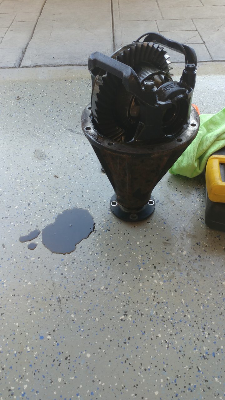

    Ok updates-
    ECGS Dana 60, 70"WMS, 4.10 gears, Eaton E-Locker
    Front Clamshell with all the ECGS upgrades, 4.10 gears(No locker)
    Also have some 285/75/16 Toyo RT's going on. 35s were fun, but honestly just to much work to fit and killing my alignment and stuff. Would rather go faster and have more power with lighter/smaller tires.
    Will also be finally installing Solid motor and trans mounts. Will also be installing shortie headers (i know, finally).
    Dropping truck off Next thursday for full install of everything. Yay.
