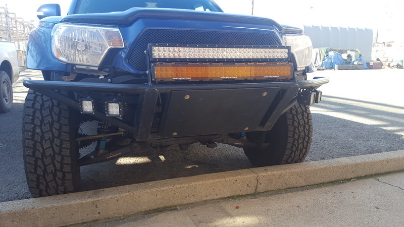

    Okay. Looks like the split part of your bumper is those horns welded directly to the frame?
    I was thinking of plating the front of the frame, adding a new crosmember, and bolting the bumper to that, just to make removal an option.

    The split part?
    Once I get a little more experience with tube work under my belt I'll probably redesign my front bumper as well, and I'd like a removable option as well. The plus side to the 2 piece skid is that if I decide to change bumpers and the bottom is at a different locstion, all I have to do is readjust mounting tabs on the lower portion to get the angle correct (and adjust slid size if need be)

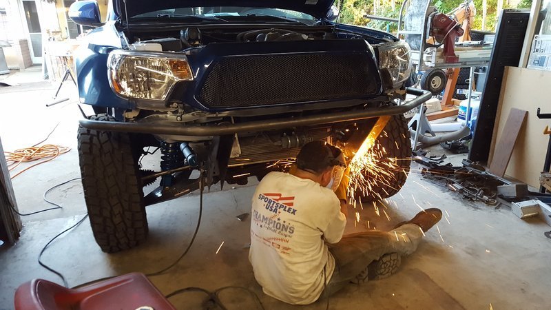

    Just over your left shoulder there are two parallel plates. Those are the frame horns welded on over the crumple zone, right?

    Yes. And thats @jeffz0rz welding with me taking a ninja photo lol

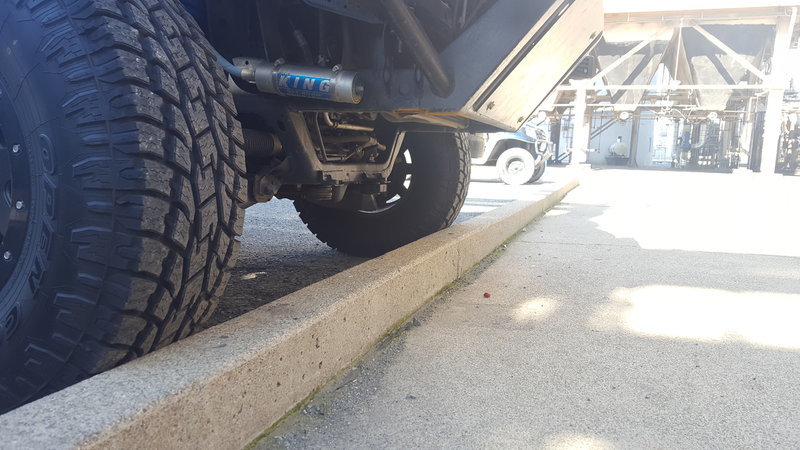

    How she sits now. So much clearance underneath
    tmp_10666-20170128_112104-1238495523.jpg tmp_10666-20170128_112115-1166074479.jpg
    Dont mind the rust lol, I cleaned it up :rofl:

    What do you mean? Bumper wise? Like I said, I'm thinking on making a bumper like that bolt on, but it would involve chopping off everything on the frame there and welding on a new bolt on mount in place. If I ever get around to doing something like that, I'll share my design and see if anyone is interested lol.
    If I could change anything I think Id cut off more of the frame or shorten the frame horns to tuck the bumper in closer for less of an overbite like that. Could probably carve off a couple inches and still have good clearances

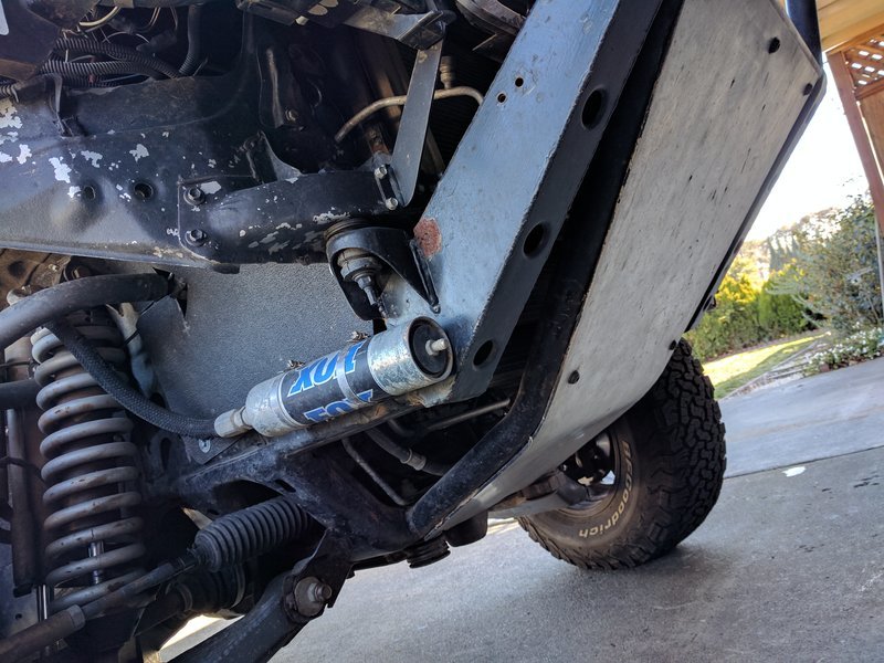

    check out how mine is set up., tubes welded from lower crossmembers and angled to meet at the top of the horns.

    no room for winches

    yeah I looked at yours when I was at the last Mod day. The only issue is there's no skid under the engine and differential. I want full skids from Transfer case to bottom of bumper :D

    Thats my issue. Either I cut those tubes, which I like, and lower them and fab something to guard the diff mounts. I have a bud built mid and transfer case skids, I'll mock them up and take a pic. The front bud built skid would not flow onto the existing bumper, so like you said earlier, a custom fit with the right angles would have to be made to work.

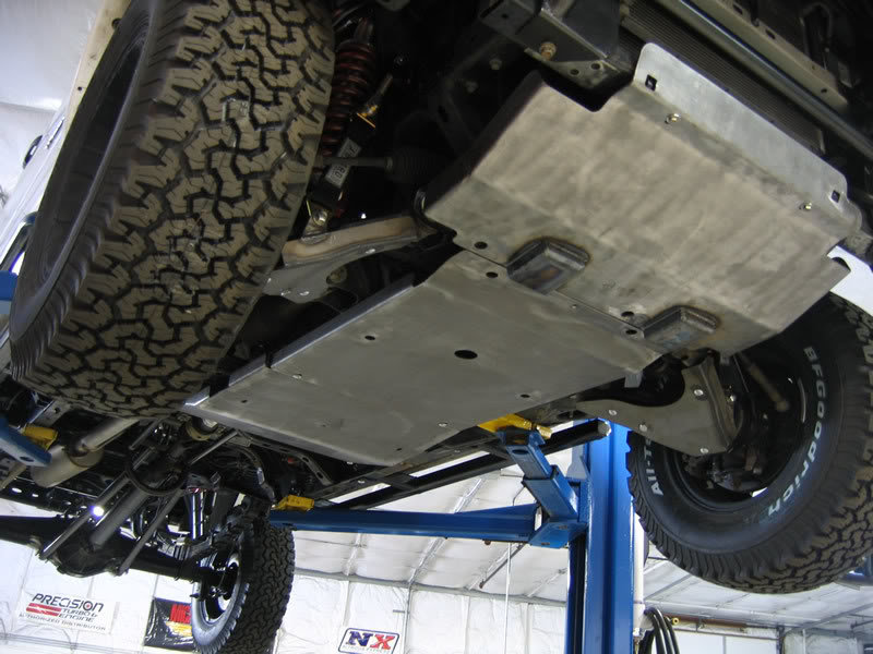

    this is a funky idea i found

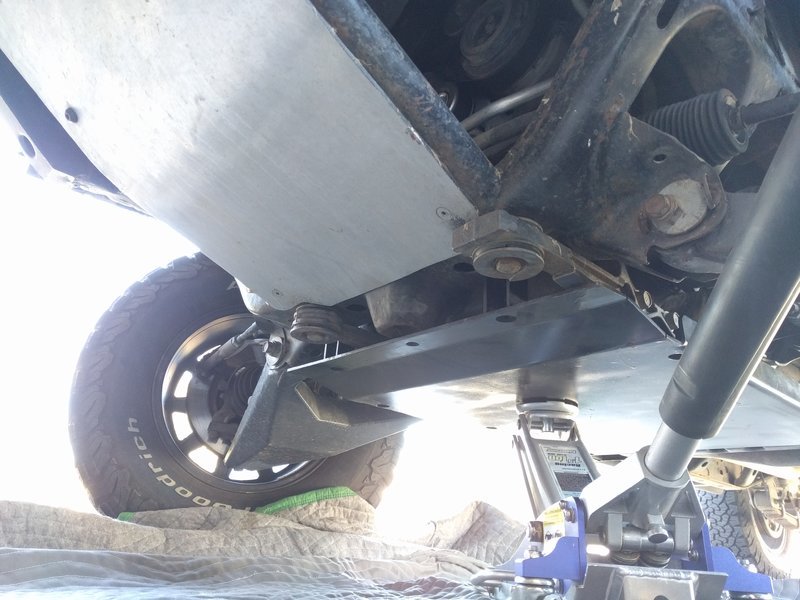

    Actually thinking something like this, but probably 2 tubes from the bottom of the bumper tubes up to the crossmember for some more support. but then I can run a skid under the truck to the bottom of that bumper, and then another one up to the frame horns

    that gap and angle are the problems
